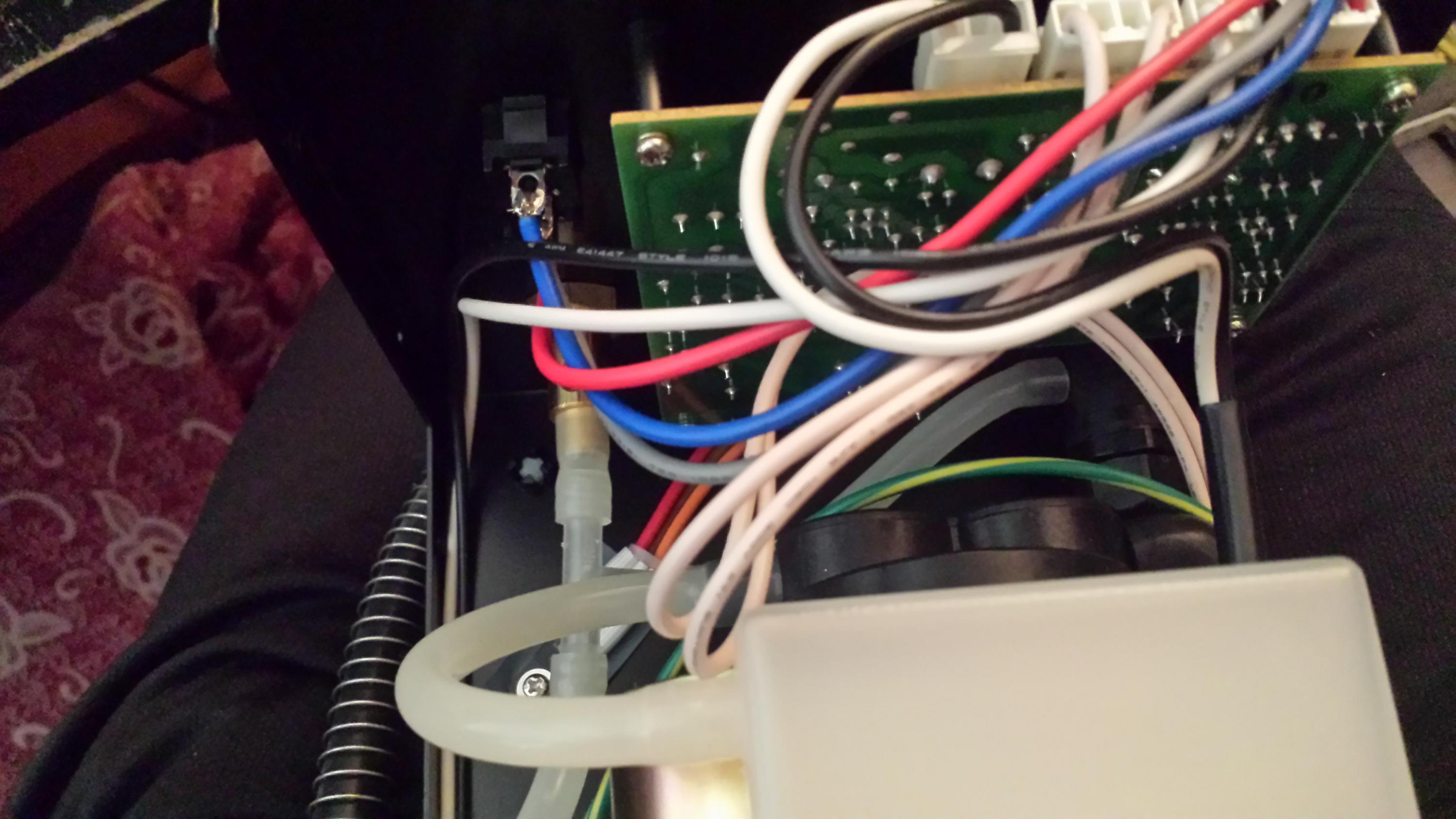

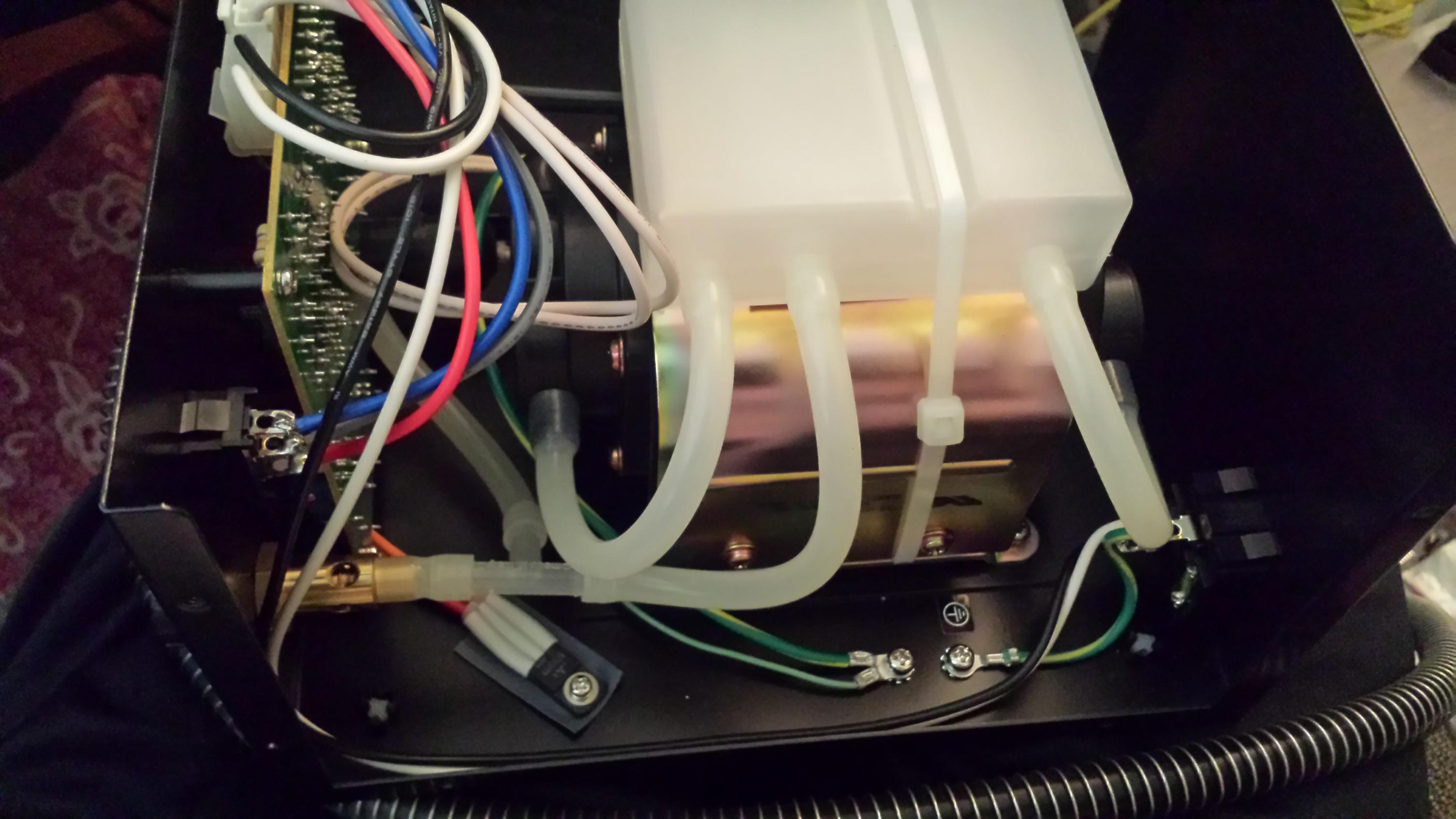

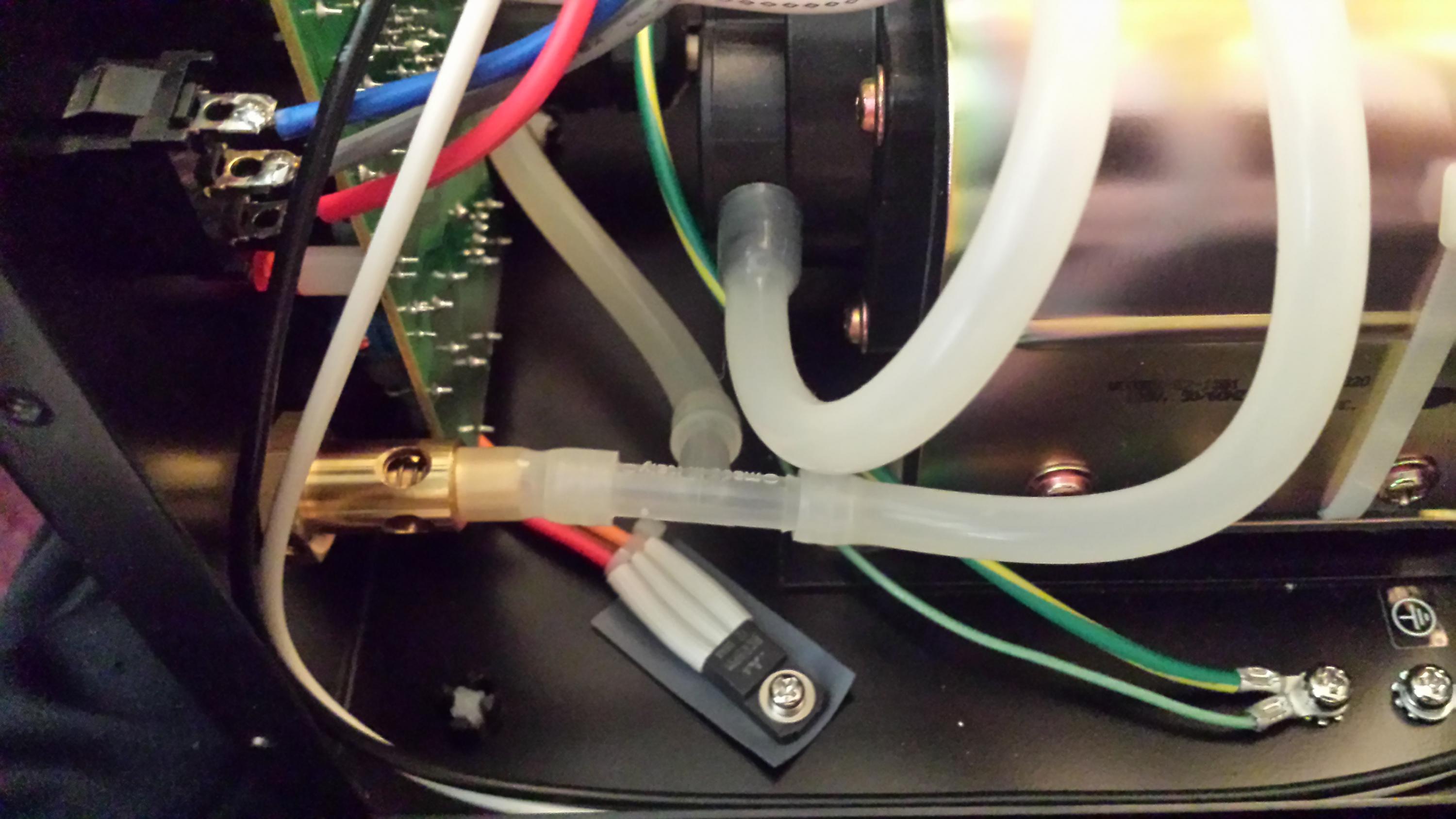

    I was wondering if anyone had some insight to this unit. I got this used the air flow control is a pneumatic type. Was jammed. I cleaned it out and it works now. But I feel that the air output is quite low compared to my generic 858 hot air gun.
    The 858 has the fan in the handle. And the hakko 850b has the pump in the unit itself.comparing the units the output air on the hakko is significantly lower than the 858.
    Is this normal for the air flow to be quite small or does the pump need servicing? It may be I gotten used to my 858 station and I'm not used to the hakko?

    got a foto of the control board that drives the pump?
      It seems to be controlled the output air flow. The pump i think gets 120v no direct controls. The pump is constant and the pneumatic knob releases air from the output. attatched are some pictures
