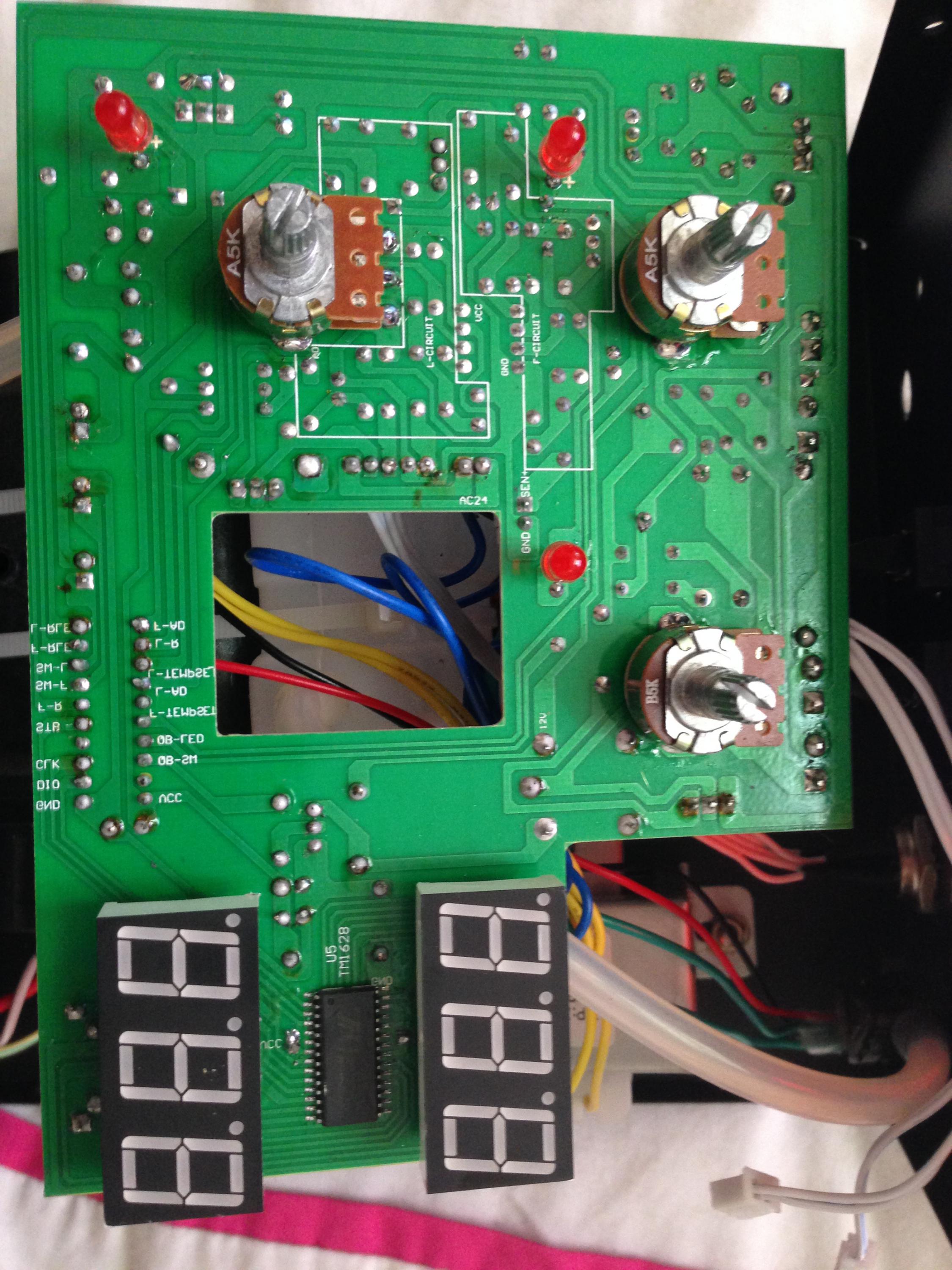

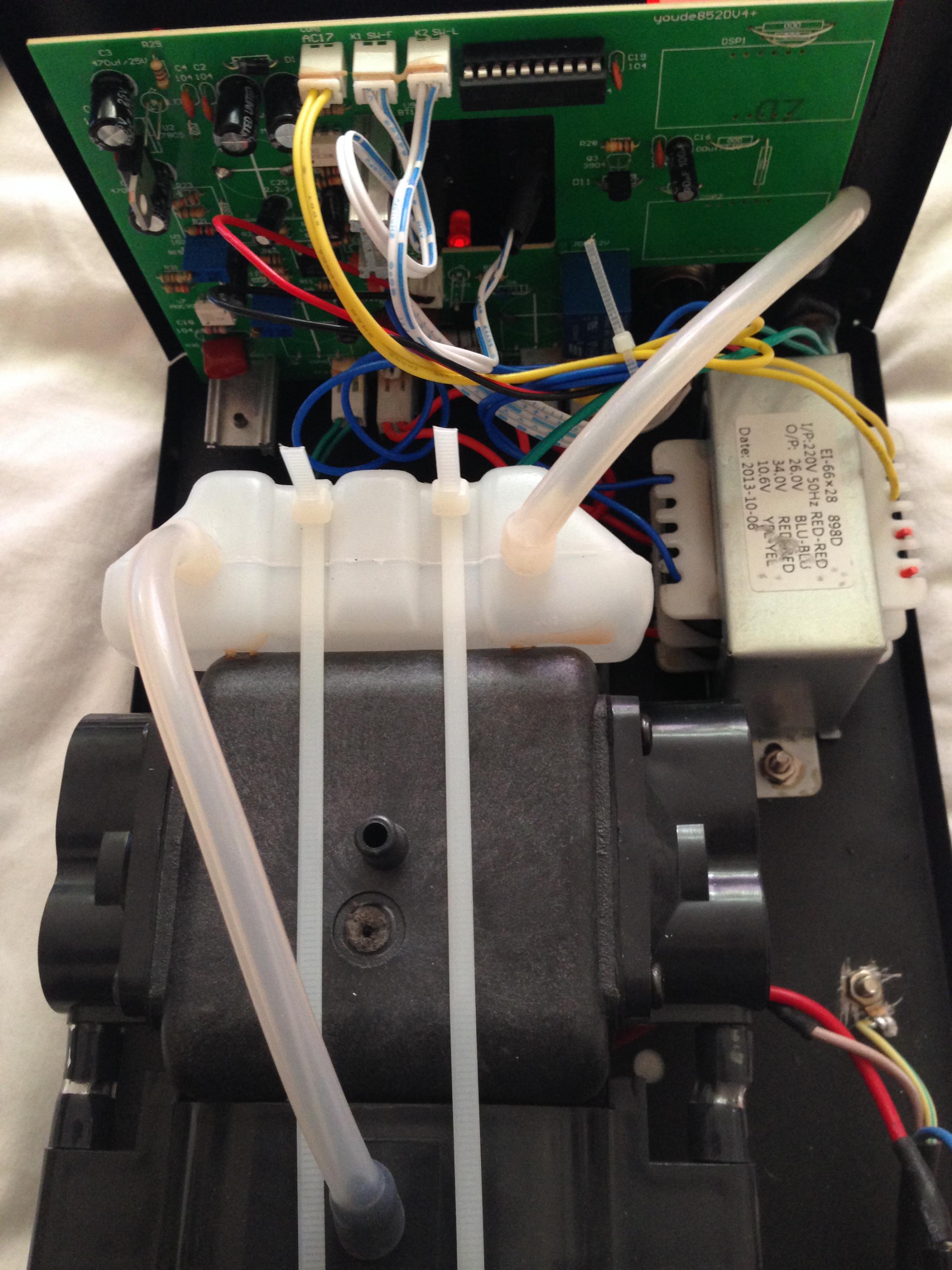

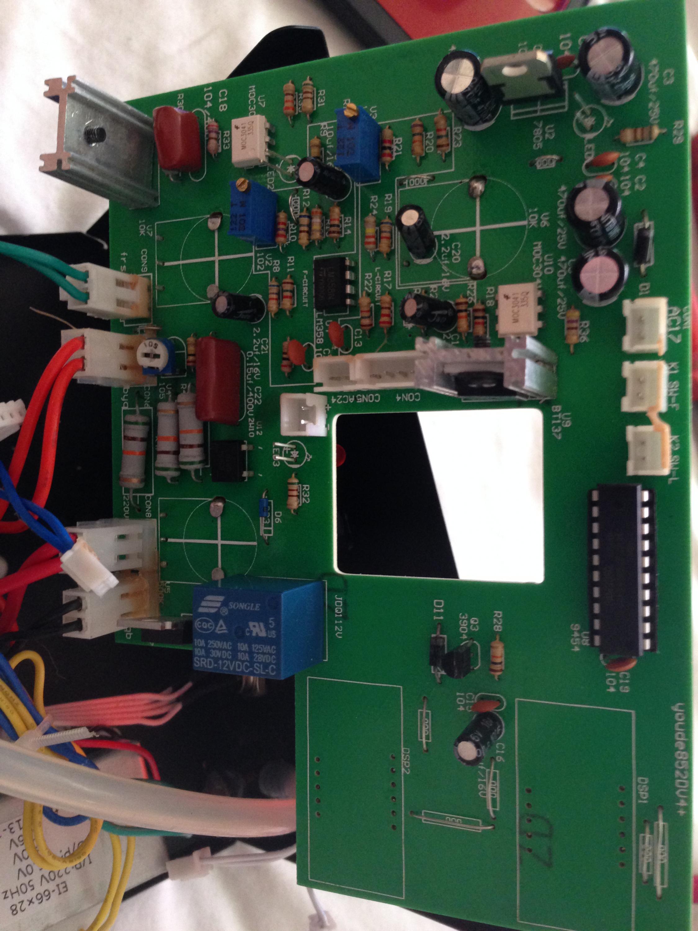

as some of you know i brought this this and worked for ten min and stop just show error s-E so here some pics is there anyway i could make this better and get working see pics
rework 852d help

A quick google search indicates that something is wrong with the iron. Why dont you disconnect the iron and see if the hot air side works. Then check the iron connections, board to DIN connector and din connector to heater and thermocouple. -

Inspect all solder joints and redo any if in doubt. Also look for loose solder balls, or anything shorting where it shouldn't. Check MCU controller is properly in it's socket, too. These station are built with only one thing in mind: cheap cost. I have an old Kada 852D+, but the board layout looks much more different than yours, otherwise we could compare more directly what is wrong with yours. That said, the design is probably similar, although mine does not have a relay like yours.
Another thing I would suggest is to look at the voltage from the 7805 5V regulator (if it has one. Should be clean 5V and the filter capacitors should be installed nearby. On mine, there aren't any, so the 5V isn't very clean I get lots of garbage on the display on the last significant digit on temperatures.Comment
