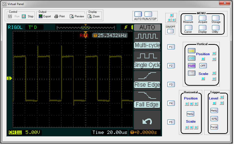

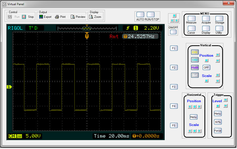

    I purchased this item from ebay and I'm checking everything within the reach my limited knowledge. So far everything looks good but I have a question to ask anybody with a similar unit or anybody who understands this concern of mine.
    So my concern is weather this unit is functioning properly when generating a square wave signal or if it needs calibration/repair.
    Attached is the user's manual, plus pictures that show the "square waves" I'm getting on my scope.
    As you can see when I go higher on the frequency, there starts to be some distortion.
    I understand this could be normal, to some extent, due to harmonics on the oscilloscope etc.
    So what are your thoughts?
    Thx

    I have made recently some training circles with the Twintex TFG-3620E arbitrary waveform FG.
    Some distortion is natural effect when getting close to 60% of the full range of frequencies that your model can deliver.
    The sampling rate of most FG is low, and in simple English all FG have sufficient sampling rate for perfect reproduction of signals up to 100Khz.
    Above that 100 kHz the quality of the waveform starts to degrade, how much it does that.. it depends on the quality of the FG it self and their sampling rate.
    You have also overshooting problem due impedance mismatch, the FG is 50 Ohm and the scope 1M Ohm.

        This unit is Analog FG, no sampling involved. Are you trying to get the Sq wave output at at 20MHz? See the spec of the Sq out put freq.

          I had not seen or noticed the specs for the square wave (0.1 to 100khz), makes sense now. My first time playing with a function generator and thought it was supposed to produce a nice square wave up to the unit's rated 20mhz frequency.

              That is your duty cycle range. The peaking at the lower frequencies is due to X1 scope probes. You should be using a 50 ohm termination and a X10 probe to get a proper waveform on the scope.
