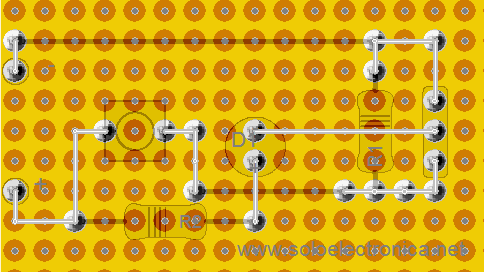

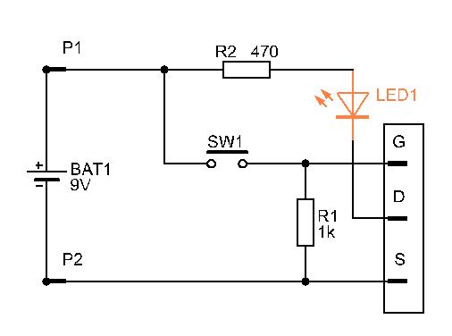

    Recently I acquired a Panasonic Plasma that is dead and blows fuses on plug in and I am trying to test the Power Mosfet N Transistor (RJK5020). I have been searching the web for a decent simple circuit diagram and design to build a test unit. I have built the following and tested the transistor on it. But my findings are not conclusive to what the poster of the design says they should be.
    According to the website I got this design from this is what should happen.
    Test switch OFF , LED OFF = Good
    Test Switch ON , LED ON = Good
    Test Switch OFF , LED ON = BAD
    Test Switch ON , LED OFF = BAD
    But I am getting in both positions my LED on. Any input would be greatly appreciative.
    Thank You,
    Craig T.

    Your MOSFET is bad then, it is short circuit. Assuming the circuit is wired up correctly, of course - try with another similar MOSFET.
    • Craigt81
      • Oct 2012
      • 6
      Re: Mosfet Tester - Good Design?
      Thank you very much for the input. I will locate another mosfet from a power supply i have laying around and try it.

        That circuit is made for testing N-Channel MOSFET only.

            If you put a jumper between Gate and Source, but do not hit the switch, if the LED is still on, then you have bad MOSFET.
              Invert the battery polarity, and bingo. Now you have a P-Channel MOSFET Tester.
              The best is to use a switch for battery polarity inversion, and you have a both channels Mosfet Tester...
                Not that simple, you need to reverse the LED also, or he has to use BI-COLOR LED or two LEDs.
                  Another LED in parallel and in opposite direction will do the trick... One for P other for N.

                            One bad thing about the circuit is that if the MOSFET has built-in protection Diode between D and S, one of the LED will be on if the batteries switch is set to the wrong polarity.
                              This is not a built-in protection diode between D and S, but a "parasitic" diode inherent to the structure and present in all Mosfets.

                                My mistake. Reverse voltage may damage the MOSFET. The MOSFET channel type must be known before it is tested.

                                  @TUBE DIODE, I guess you have never design products with MOSFET that has the Diode built-in:
                                  https://cdn.badcaps-static.com/pdfs/...5c85166995.pdf
                                  Most MOSFET had D-S reverse breakdown voltage of 30V or more, so 9V is not going to do any damage.
