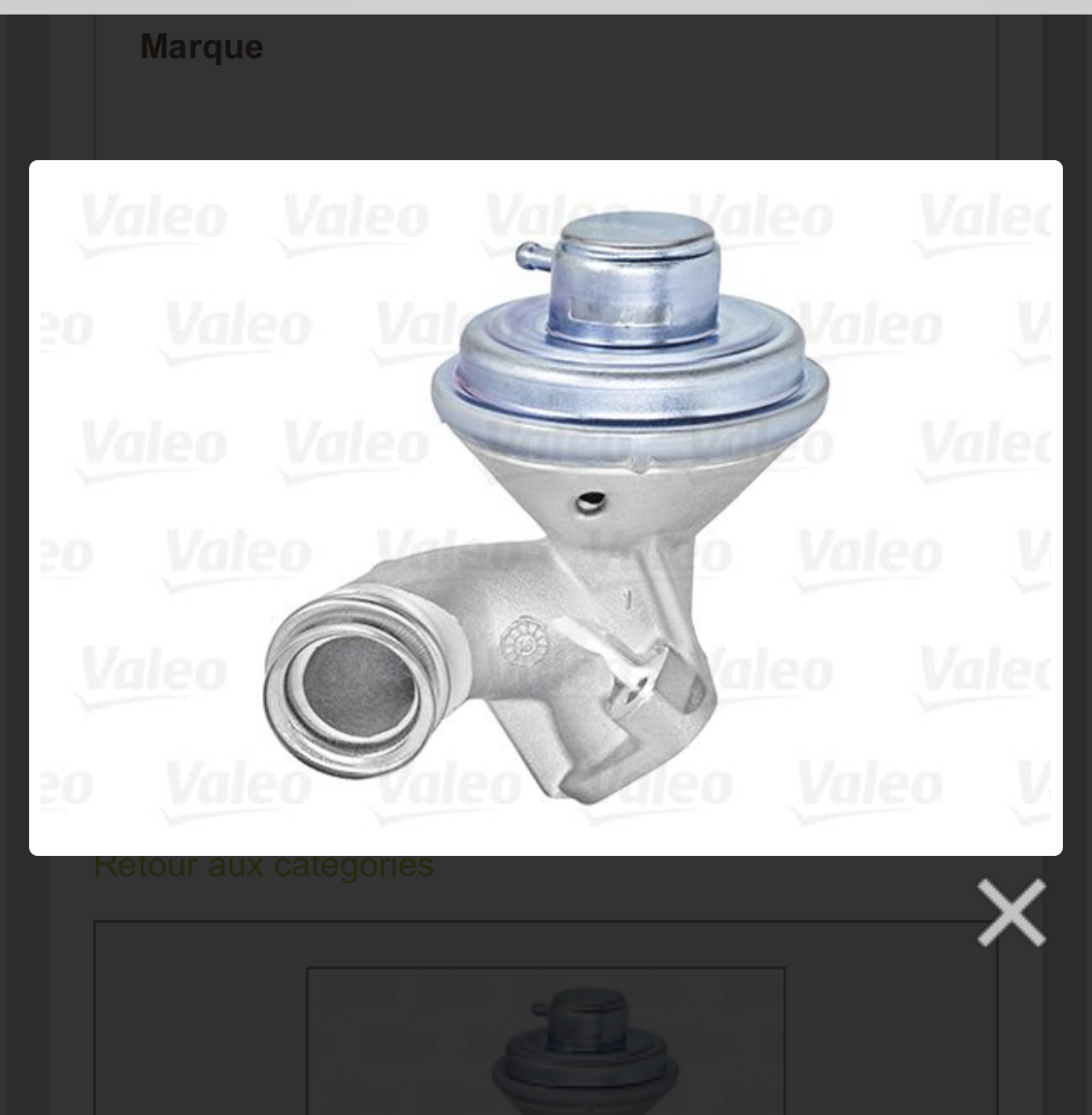

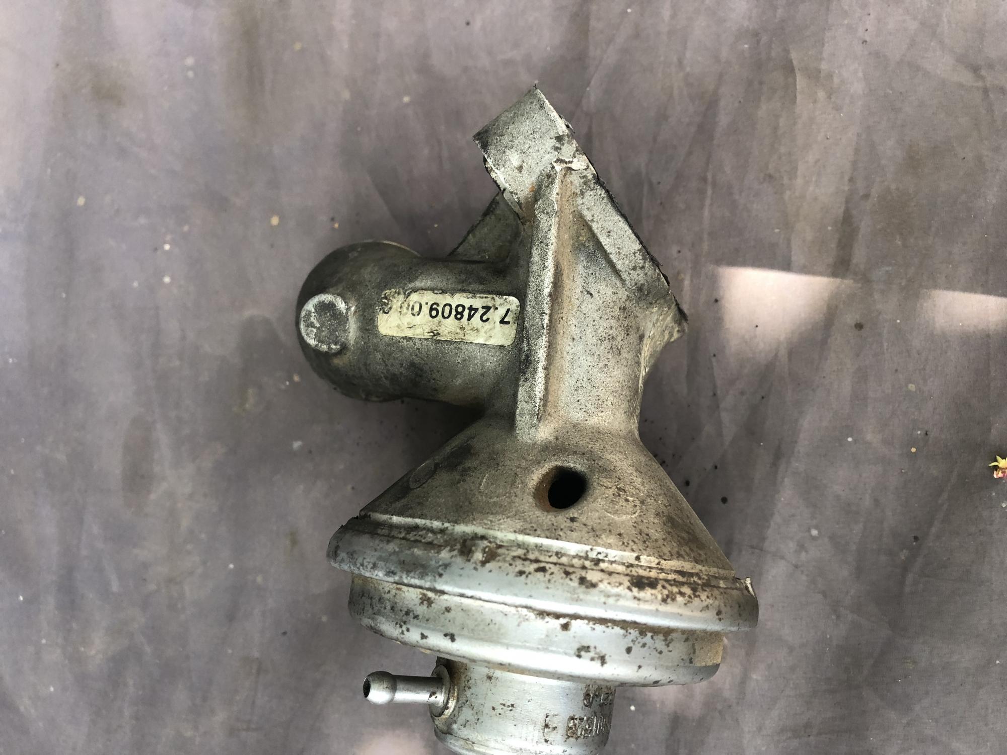

                              #34
                              Re: car, motorcycle programming or decoding
                              This is my EGR
                              My mechano say my EGR is not faulty and we’ve cleaned it and but it back
                              Please I want to understand something,why my scanner is saying with P0401 code that there is something wrong with my EGR,since my there is no wire connection with the EGR
                              Please need your explication
