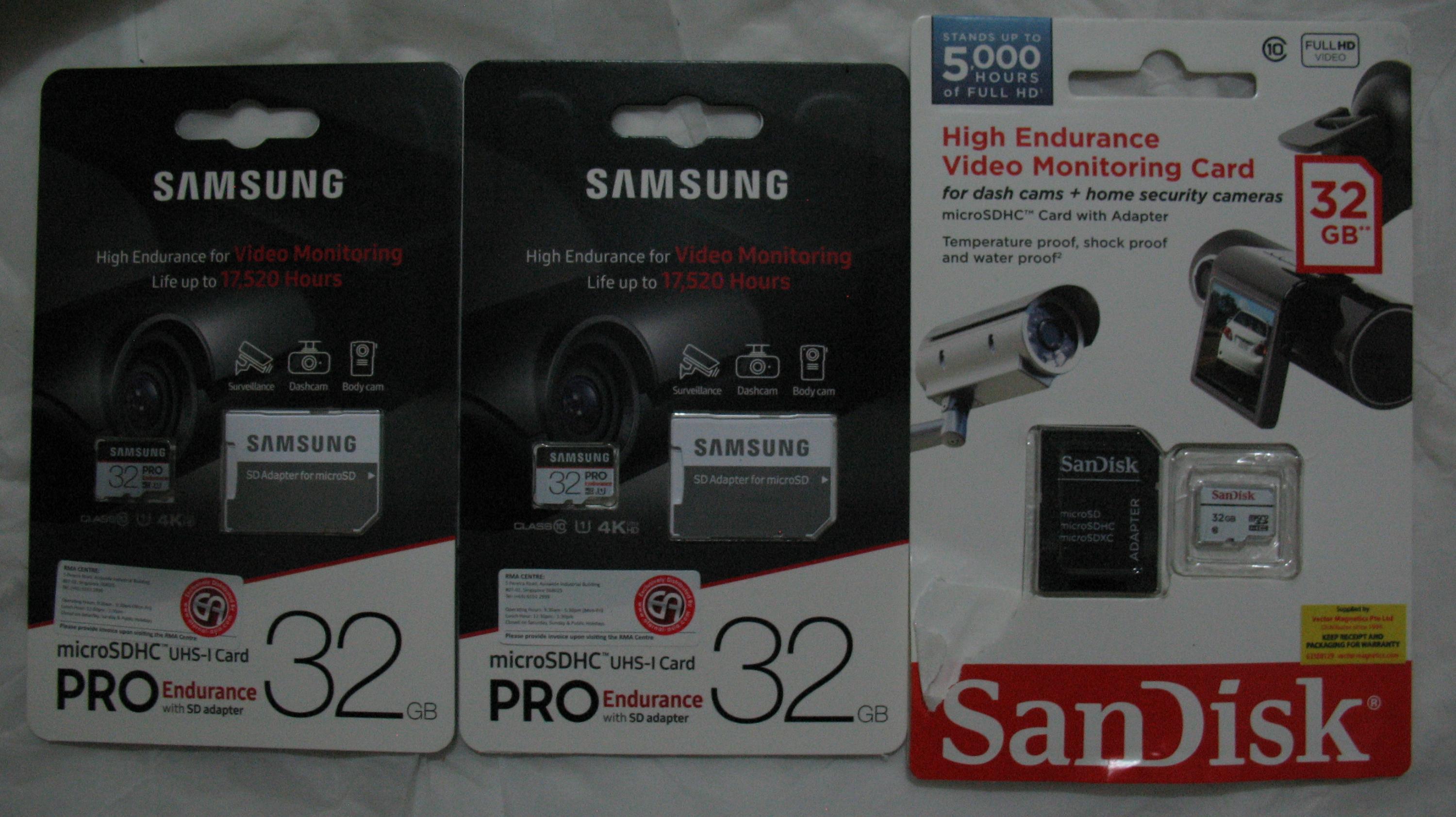

                            • ChaosLegionnaire
                              HC Overclocker
                              • Jul 2012
                              • 3266
                              • Singapore
                              Re: uSD cards (probably applies to other, similar media, as well)

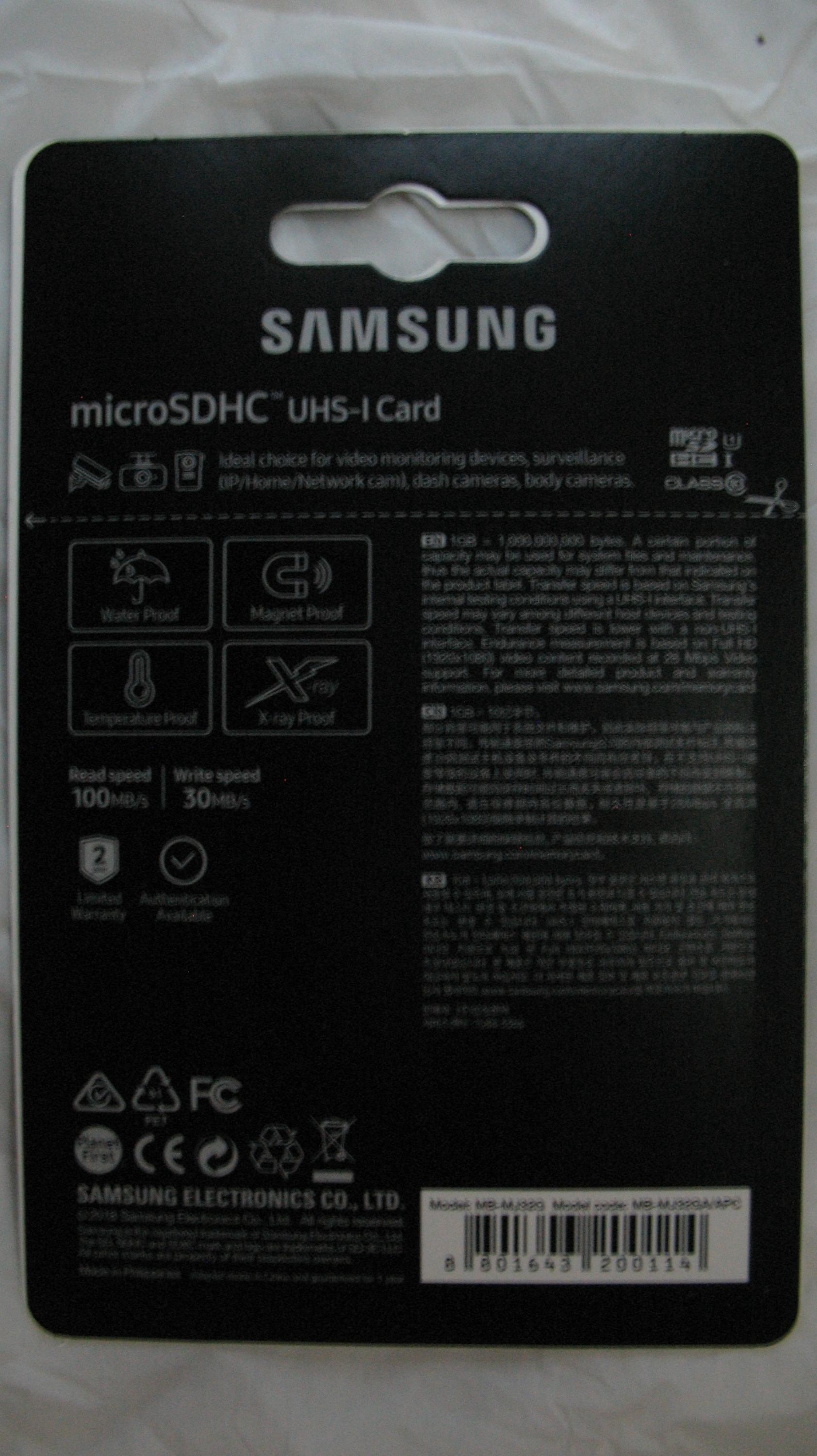

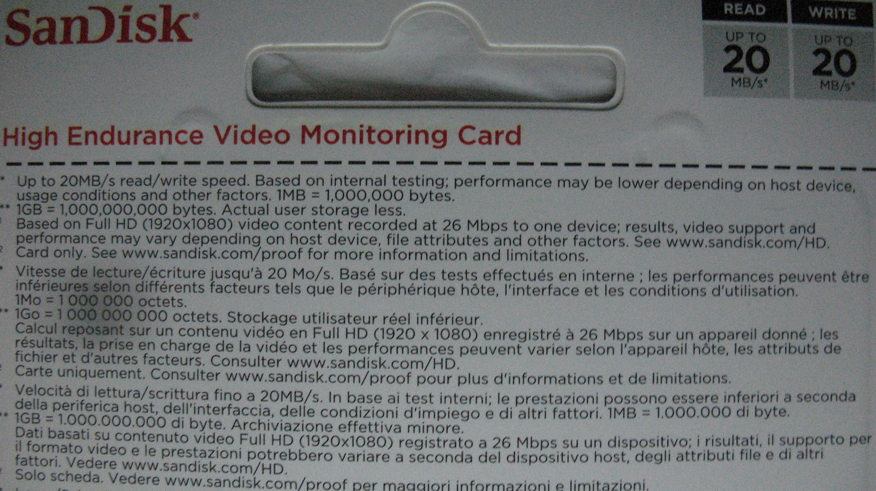

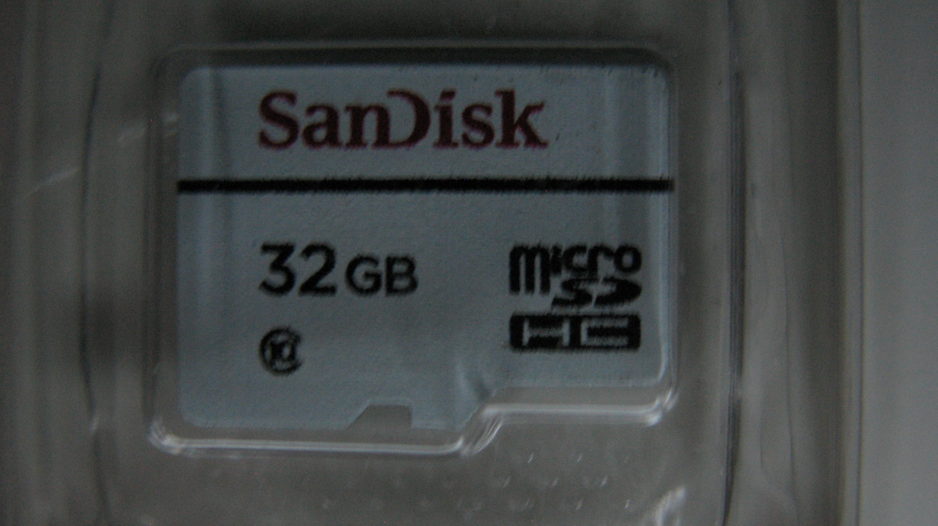

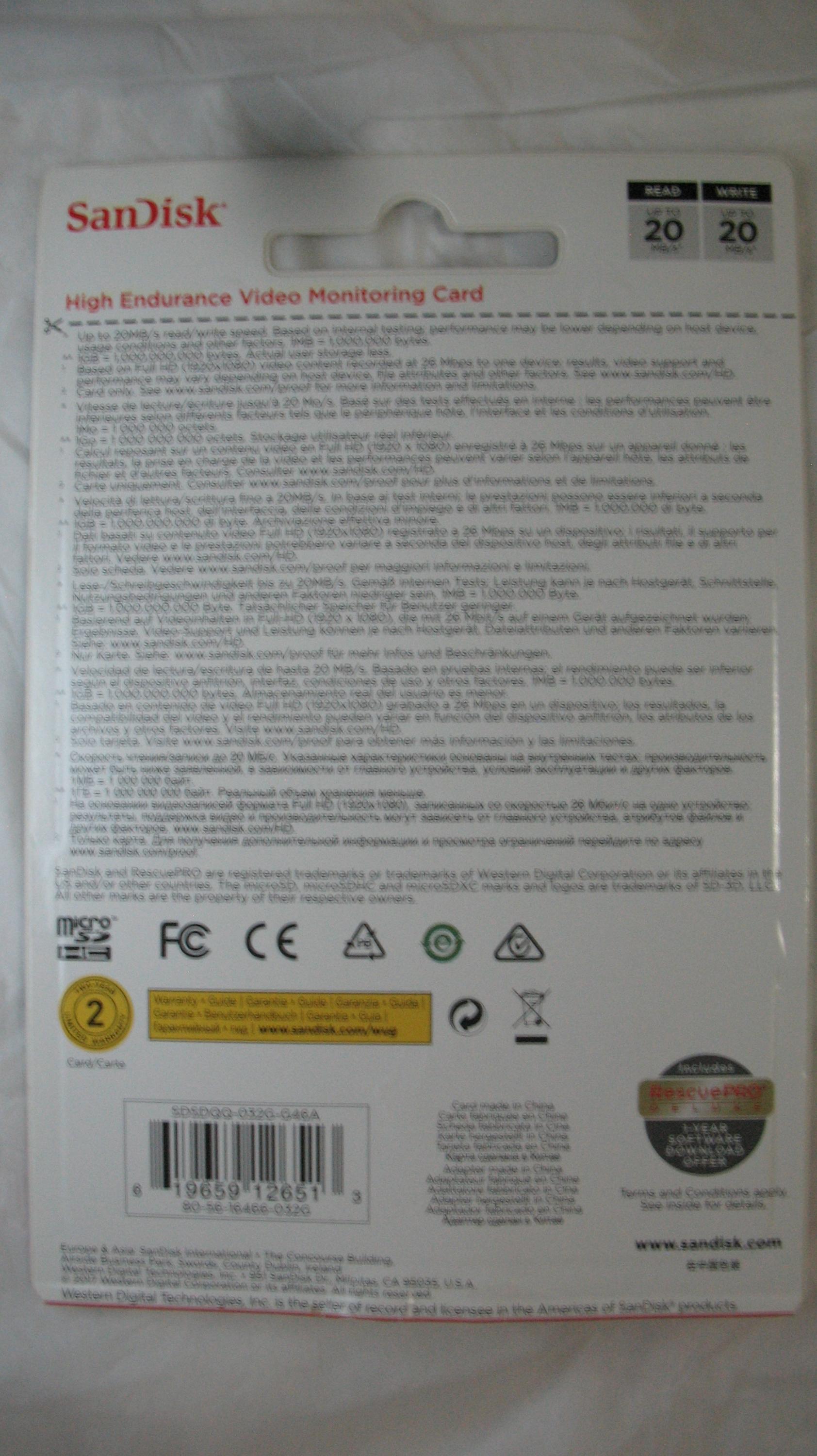

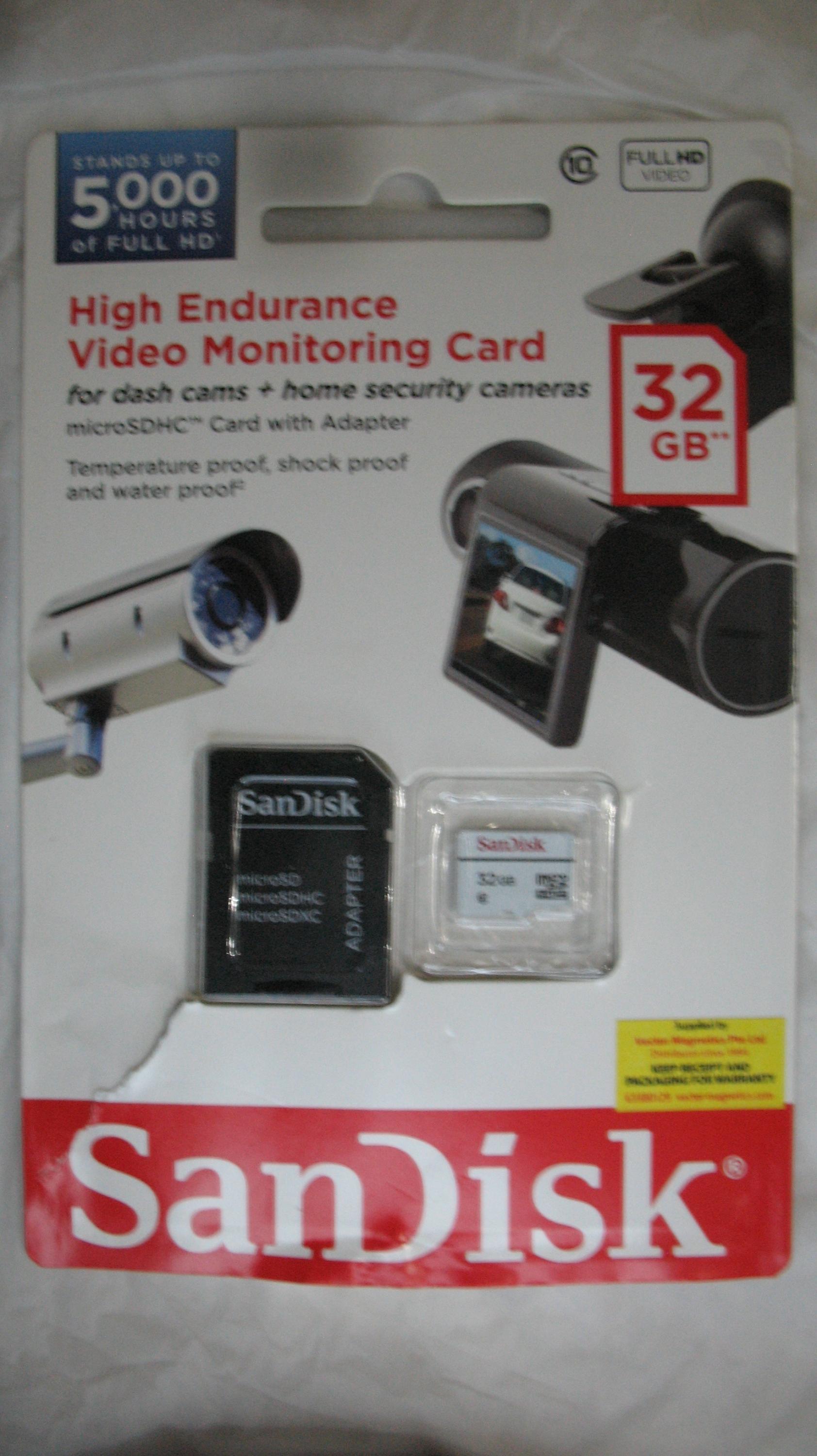

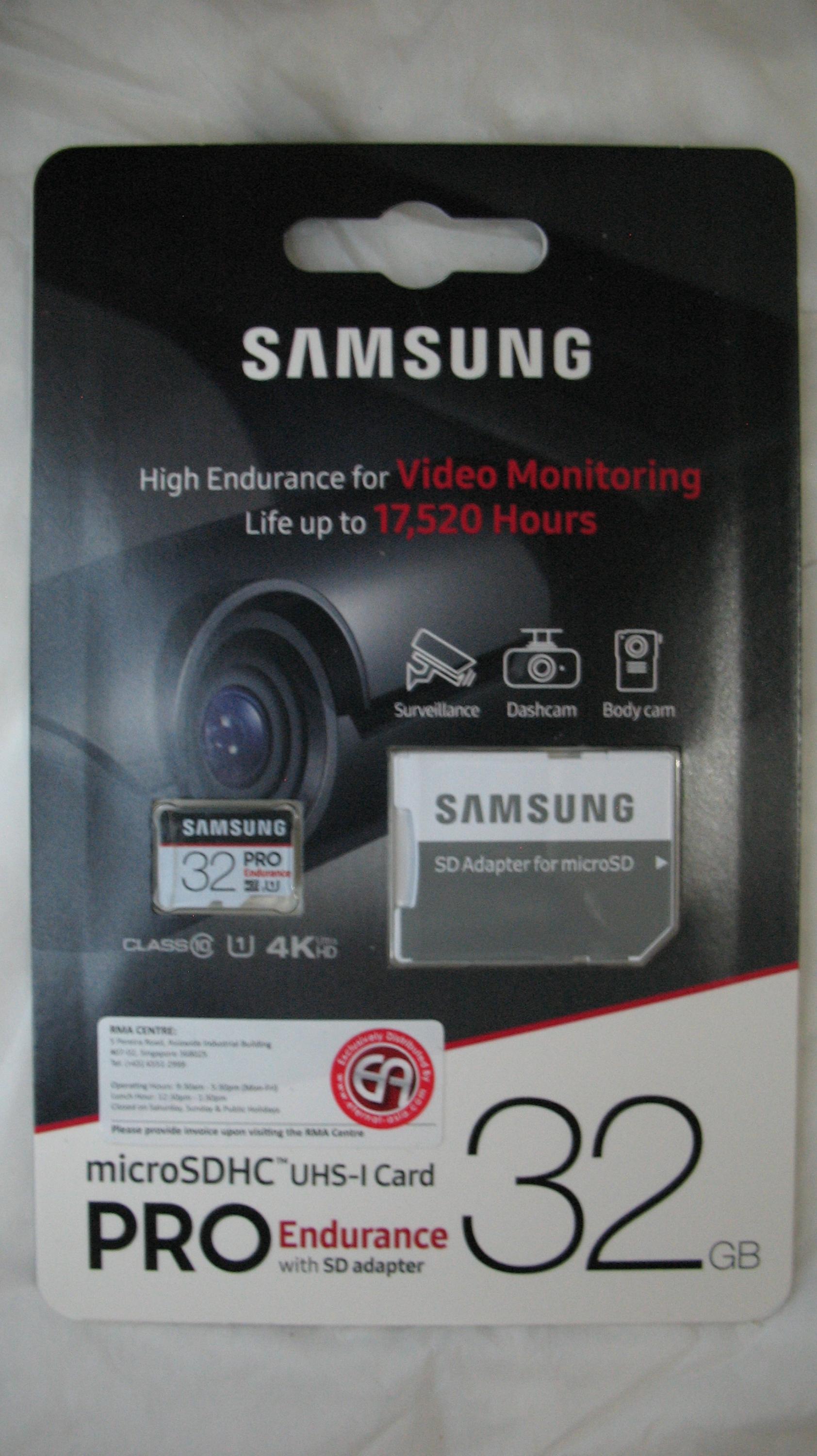

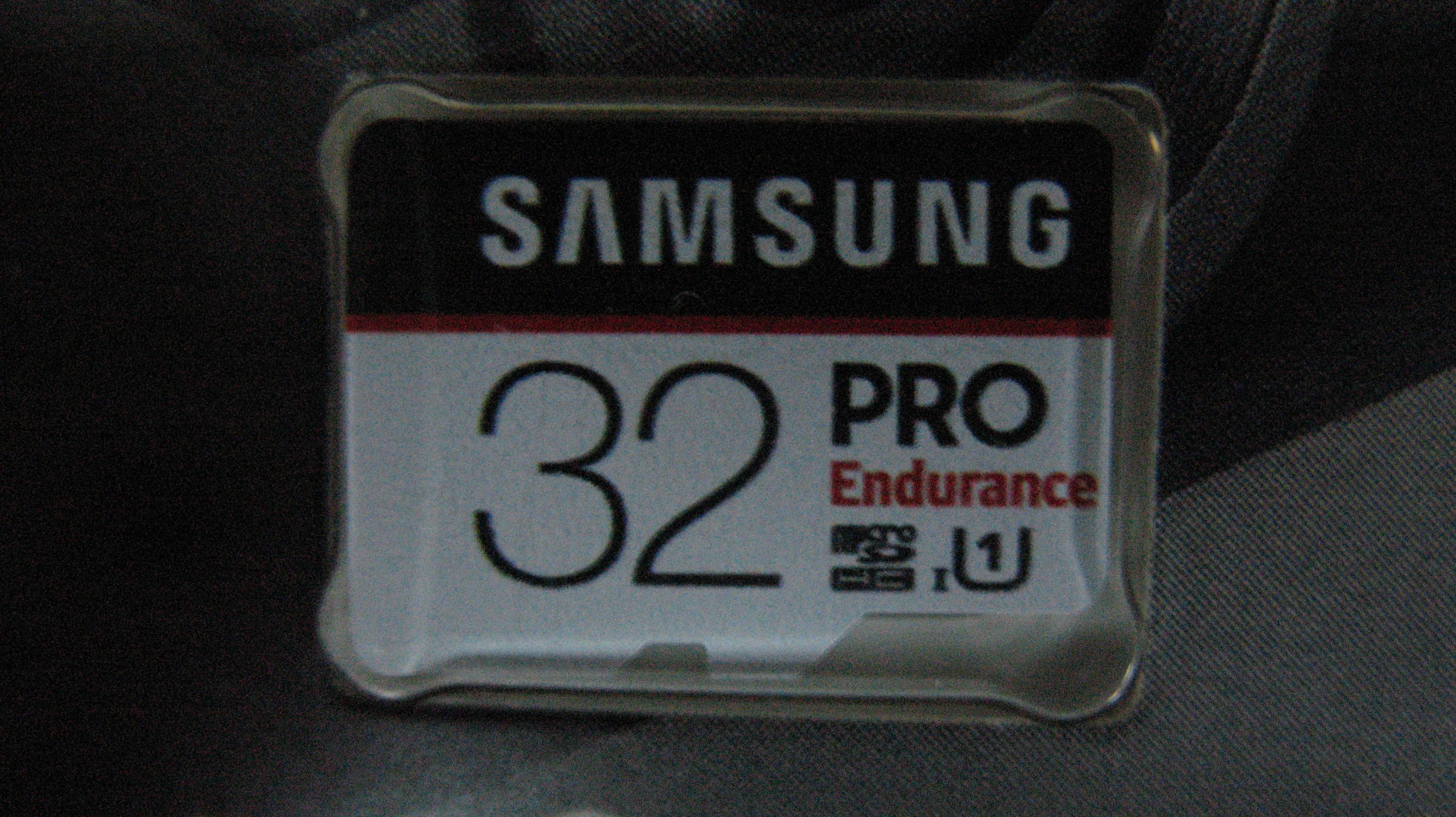

                              just thought i'd post some comments about both the sandisk and samsung high endurance micro sd cards since i recently got both of 'em in 32gb capacity.
                              the samsung micro sd cards seem to have more hours of write endurance than the sandisk ones and they also have a faster read & write speed rating but also seem to cost more if u refer to the pics of the brochures.
                              the samsung cards are class 10 with uhs-1 u1 support with 100MB/s read speeds and 30MB/s write speeds. they're also made in the philippines, surprisingly. i'd thought they'd be made in china. i guess china is getting too expensive for manufacturing now or it could also be geopolitics at play or both but this isnt the vip room so i wont comment further on that. 2 year warranty for the 32gb capacity is also disappointing but i'll explain later why. storage review also has a review of the samsung pro endurance 128gb.
                              the sandisk cards are class 10 only with 20MB/s read and write speeds and they're made in china as expected. like the samsung, the 32gb only has a 2 year warranty.
                              if u refer to the attached pics, the samsung one claims 17520 hours while the sandisk claims 5000 hours. if u read the fine print on the back, both manufacturers base their claims on full hd video recorded at 26 mbps (lucky for us) so based on this, we can calculate the tbw or terabytes written write endurance of the cards like on ssds.
                              so the video bitrate of 26 mbps equals a write speed of 3.25 MB/s (26÷8=3.25). since there are 3600 secs in an hour, so the write endurance rating of the sandisk would be 3.25x3600x5000=58,500,000 MBW or 58.5 TBW. the write endurance of the samsung would be 3.25x3600x17520=204,984,000 MBW or nearly 205 TBW.
                              if we look at the samsung 860 pro ssd write endurance rating, the lowest capacity of 256gb has a write endurance rating of 300 TBW. so if we divide the write endurance rating by the capacity, we can get the write endurance per gigabyte which tells us how many write-erase cycles the flash can tolerate; so for the samsung 860 pro 256gb ssd which is mlc based, 300÷256=1.171875 TBW/GB; for the samsung micro sd 32 gb, 205÷32=6.40625 TBW/GB; for the sandisk micro sd 32 gb, 58.5÷32=1.828125 TBW/GB.
                              so wow, it seems the samsung ones have an extremely high write durability per gigabyte compared to its peers. with such a high write durability, i'm tempted to wonder if the samsung pro endurance uses slc flash?
                              also, if u look at the write endurance of the other capacities of samsung 860 ssds, the write endurance per gigabyte all works out to be the same. both the 32 gb and 64 gb versions of the sandisk high endurance micro sd cards also work out to the same write endurance per gigabyte. the samsung pro endurance micro sd cards seem to have "diminishing returns" with regards to increasing the capacity but having a lower write endurance per gigabyte as a tradeoff of the higher capacity.
                              so from the above, we can surmise these about current flash memory technology. firstly, even though flash mem manufactured on a smaller process node has lower write-erase cycles, the lower write-erase cycles are offset by the higher capacities permissible by the smaller process node, thus higher capacities give higher write endurance (as in having a higher TBW limit) as well. so it is for this reason, the lower capacity micro sd cards have a shorter warranty length.
                              what im unable to find out is whether these high endurance cards use flash mem on a larger process node thereby allowing higher write-erase cycles which gives it high write endurance at a hardware level. or if they simply use highly advanced wear-leveling and special writing algorithms to maximise the write-erase cycles on the flash. in that case, u are at the mercy of how well the flash controller and its firmware are written by the manufacturer. i suspect the best solution would be both, so only time will tell just how enduring those high write endurance flash mem chips are.
                              also, high write endurance doesnt necessarily mean high reliability or it wont fail. it doesnt say anywhere in the marketing vernacular for the high endurance products that it wont fail as much or it has a longer lifespan than other flash mem products. they only say it can be written to more for more hours of video recording compared to other products. the 2 or 3 year warranty is pretty telling since other non-high endurance flash mem products also have similar warranty lengths. so like all other types of storage technology, ymmv and it depends on your luck sometimes too. hope this overview helps people decide if these high endurance products are worth the added cost...
                              if u constantly write a lot of data to your micro sd cards, then it is worth the added cost. for light heavy write users, the sandisk high endurance may be more cost effective. for extremely heavy write users, splurging on the samsung pro endurance would then be better.
