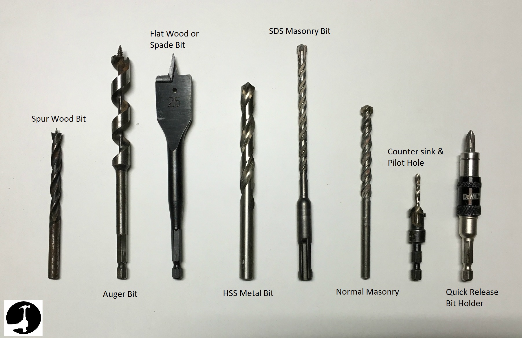

                                  Re: Fastest Secure Wipe?
                                  one or more should do it
                                    [IMG]
                                    I was thinking more along the lines of one of these myself, but i know the UK doesn't use natural gas much anymore, so you may be SOL on this account.
                                      plenty of lpg stocks .
                                        Thermite would be much more interesting!
                                        The problem with destructive techniques is that they tend to render the dives "valueless" for resale...
