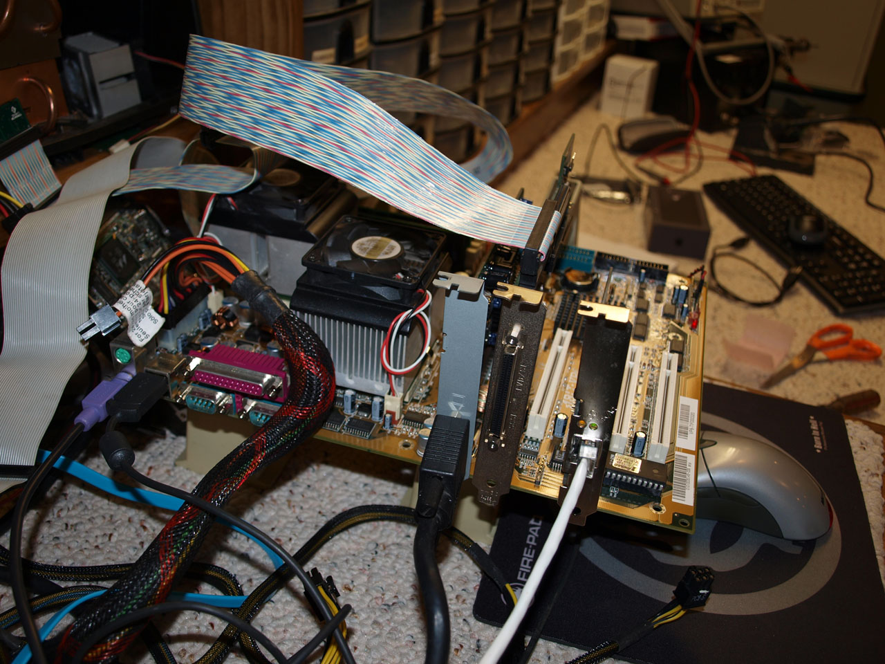

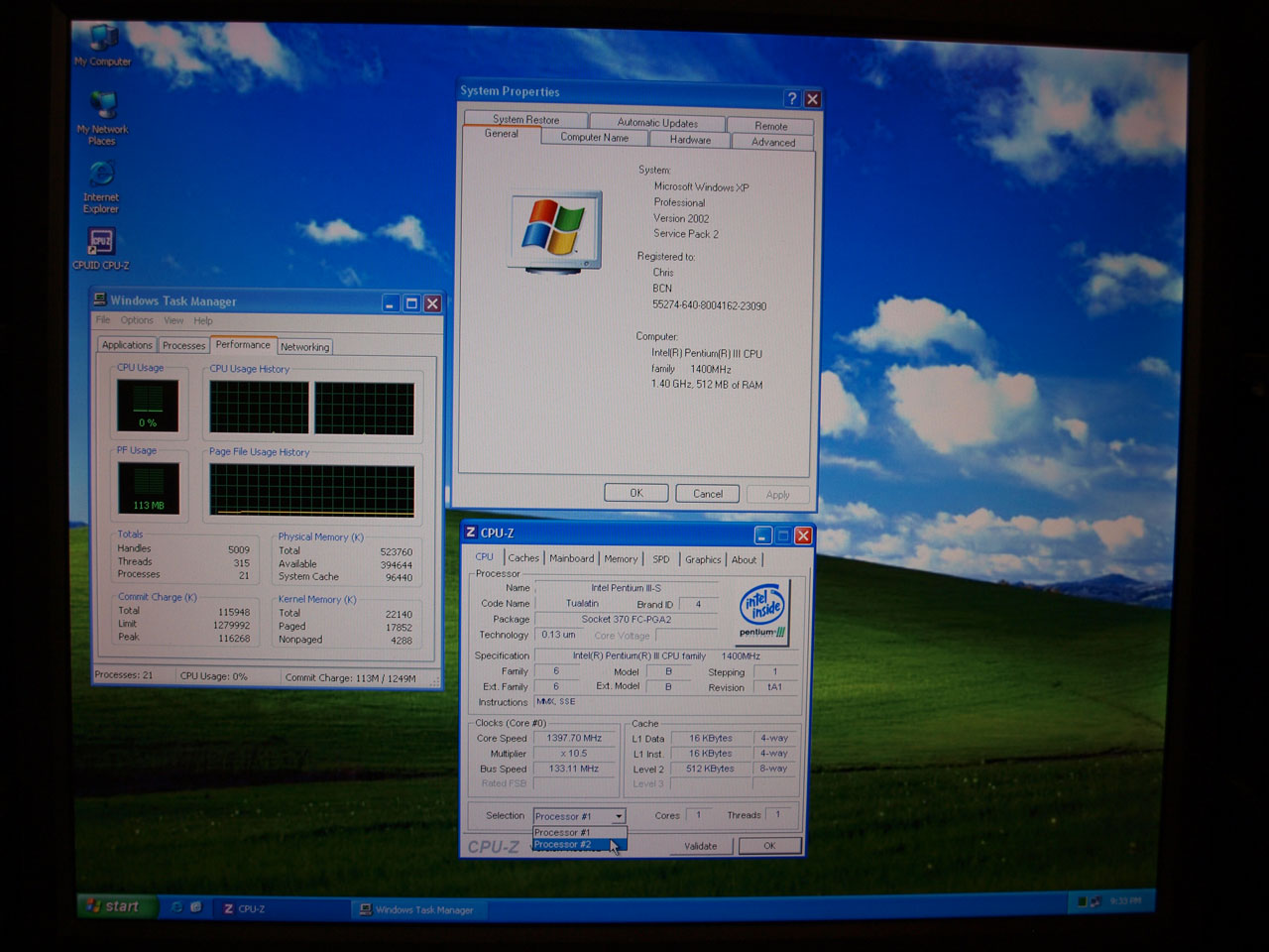

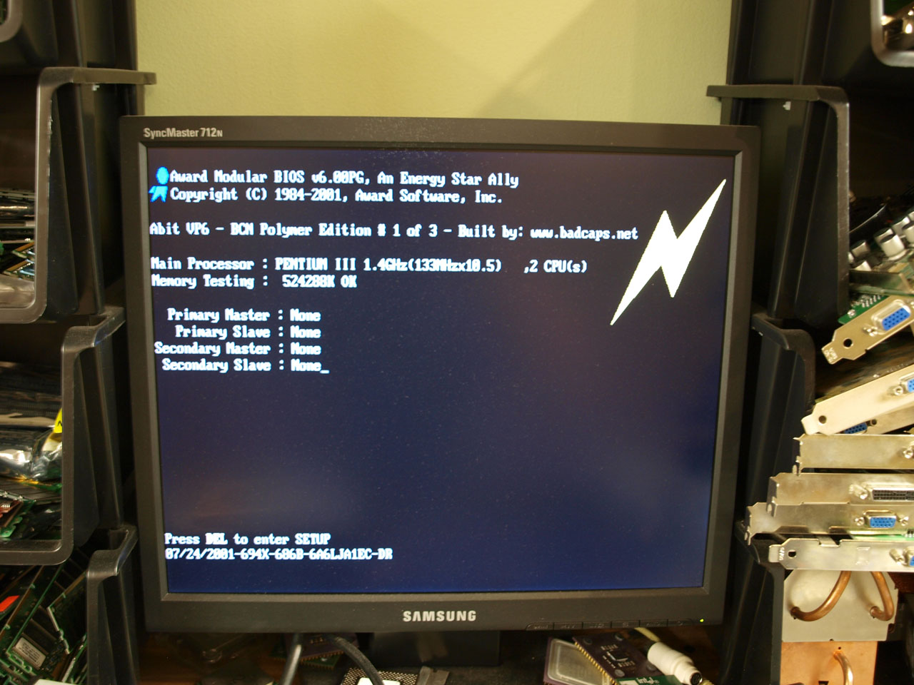

        After some diddling, it was a success! It was an interesting feat....but finally there.....what better use of poly edition # 1
        Anyway, here she is!!
        Windows stable, sees things as they should be.
        I might have to change the BIOS line to reflect the Tualatin mods.....I don't know if it will run coppermines anymore.....but I'd guess it would.

          Sadly, it don't look like there's PCI-X, thus, you probably have "SCSI 133".
          Just like when I found and used an Adaptec 29160 SCSI card briefly on a Coppermine motherboard (and later, tested it on my Asus P5QL Pro motherboard) But I got rid of the Cheetah setup I had, because it acted as if the board was damaged, it suddenly went from at least around 60-something MB/s to 30-something MB/s, IIRC.
          I suspect an SMD cap got broken off or there was a fractured solder joint. And the Plextor SCSI CD-RW drive, IIRC, wasn't reliable either, apparently, it seemed that it would do a "short read", if not send corrupted data.
          It caused the Debian installer to give me the dreaded "MD5 failed" RSOD! Likely when installing Ubuntu...

                A few months shy of 2yrs later, I still haven't found the right beige case....but I did find a case! It was given to me among a pickup load of other old computer junk. FWIW, I unmodded the Tualatin mod, it was never stable under load, a known & common issue when trying to run Tualatins dual in these boards. They'll run fine & flawlessly with a single.... Ohh well, back to Coppermines. Stay tuned for the upcoming build!!
                FWIW, Poly # 2 is still out there somewhere....I never got it back....hopefully it's still working/being abused!
