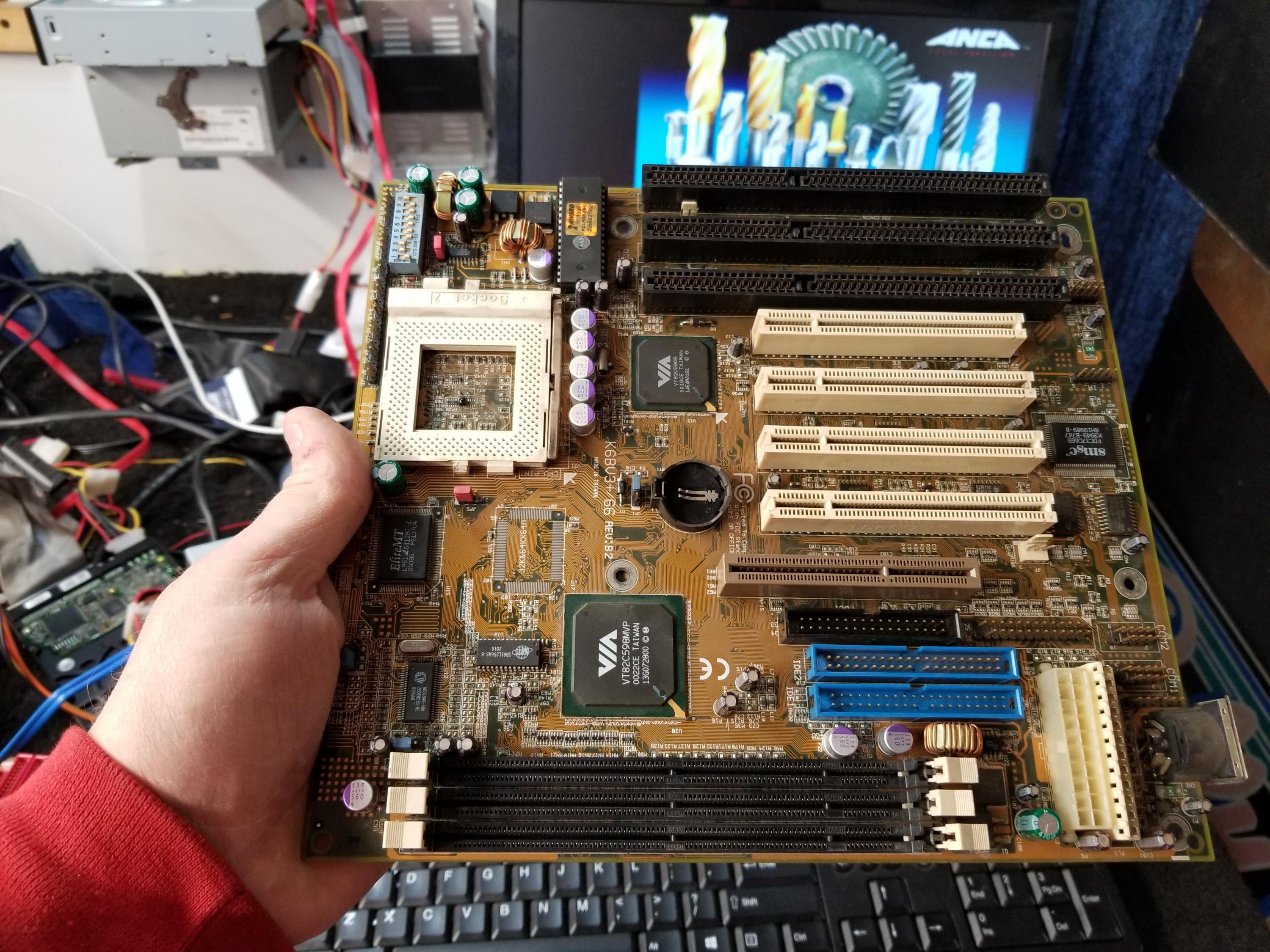

      I just did another.
      It's for a weird sco unix based glass business box.
      Go for it. KC8ADU has posted about it a few times (poly modding proprietary CNC motherboards that were socket 7).

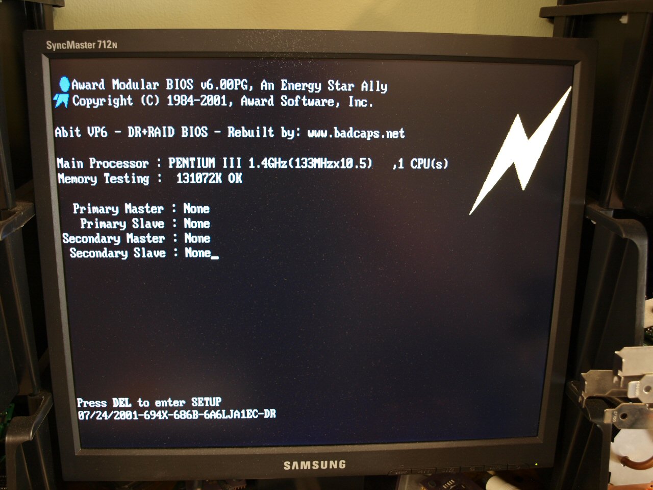

        Funny, I didn't really think many would ever notice that.
        But that's what the pictures are for, right?
        I see you also have "Experimental" BIOS in there?? (bottom of the screen)
        • Topcat
          The Boss Stooge
          • Oct 2003
          • 16956
          Re: Badcaps.net Origin & Roots - Topcat's VP6 Thread!

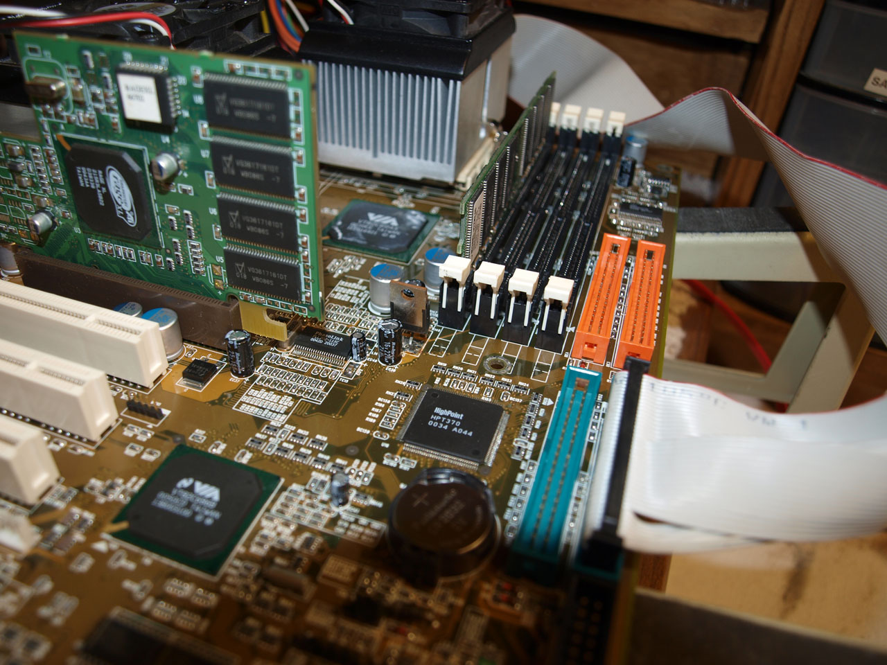

          That's the BP6 BIOS, which has had a few more alterations than just the 'message line'....
          The main thing, the BP6 has a utterly useless (even back in the day) Highpoint HPT366 U66 IDE controller onboard. THis controller can not be disabled either in the BIOS or with jumpers....so when you'd run a real controller (SCSI, ATA133, or SATA), it tends cause conflicts @ boot time, and the HPT option ROM always got priority.....so I removed the bastard!!
                  But that's more or less irreversible... I used to do that too (may have ruined a rare AMI dual Slot-1 Coppermine board that way). Especially with socketed BIOS chips and having a chip writer or spare hotflashing board, soft mods are a lot better. Want to reverse it? Flash a new Rom. Screw it up? Hotflash a fresh chip and try again.
                  Exactly. Removing the chip from the board is too 'permanent'....and I honestly don't see desoldering it from the board having a happy ending. The HPT366 controller still shows up (and works) in the windows device manager, and that's fine, it causes no problems....it's just no longer bootable anymore (hence option ROM removed from the motherboard's firmware), which is all that matters.
                  That said, I have considered seeing if it was possible to swap the HPT366 chip for a HPT370/372 chip, which would upgrade it to ATA100 RAID....but I have not been able to find the pinout for either IC to determine if it was even remotely possible for it to work. They contain the same number of legs, I just have no clue if they're pinned the same. Implementing the HPT370 firmware would be easy if the electrical mappings were compatible with eachother (both being Highpoint chipsets). The HPT370 is what the VP6 got, and was a great controller for the time.

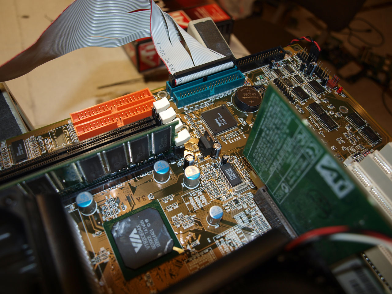

                      Looky what showed up today!!
                      VP6 poly edition #3 showed up....the only one that's still out there is #2, which he said might be a while before its taken out of service. When I asked what these were used for, the response was "I really can't tell you that due to non-disclosure agreements", so they aren't someone's toys atleast....but the polies held up!
                      ...and they sure are purty!
                      Seeing this one again reminded me why it was an unusual one.... Note that TO220 transistor next to the RAM slots:
                      I bought this board new, and it was part of my original fleet of VP6 servers before it got polymodded and sold off, so I know where it's been all its life (if memory serves me right, its been a lot of years ago)....and this was the first and only one I've ever seen with this package transistor in this place, every other one has been a TO252, with its back soldered to the motherboard. Was Abit just out of them that day? Who knows....but its definitely an oddball!
                      This board arrived more filthy than #1 did....it was dusty and had some kind of residue all over it.....and it had an 'industrial' odor about it, it smelled like smoke, but not cigarettes....so it got the sink treatment, and all the smaller 100uF and 220uf caps replaced. The CMOS battery was completely dead.....I guess whatever they were doing either never got rebooted or the time/date being correct was unimportant and it would run whatever they did on default settings. The northbridge heatsink is also missing....easy fix....but #3 is home.

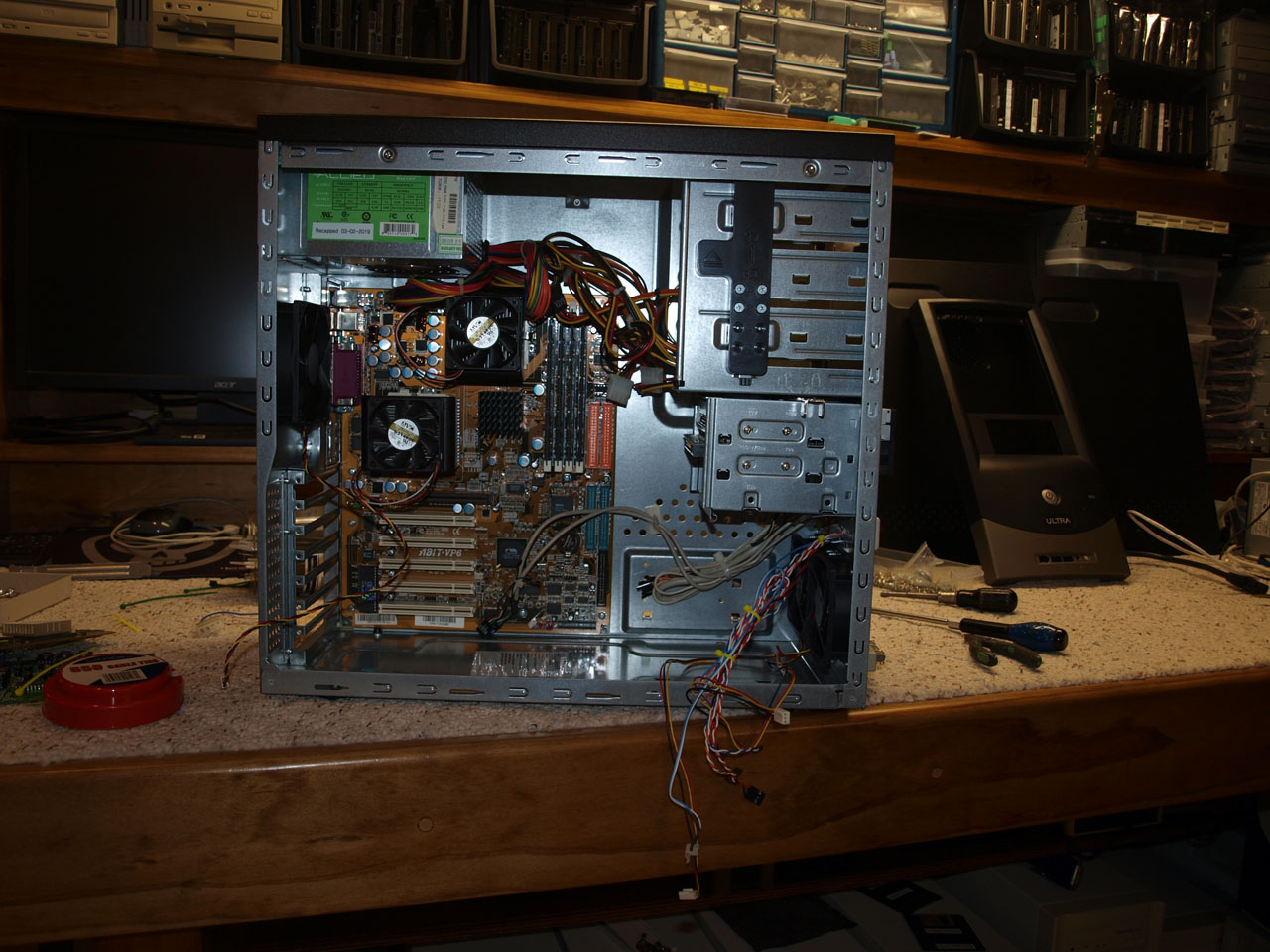

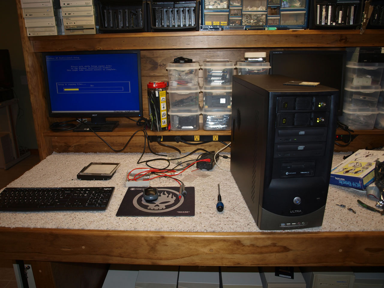

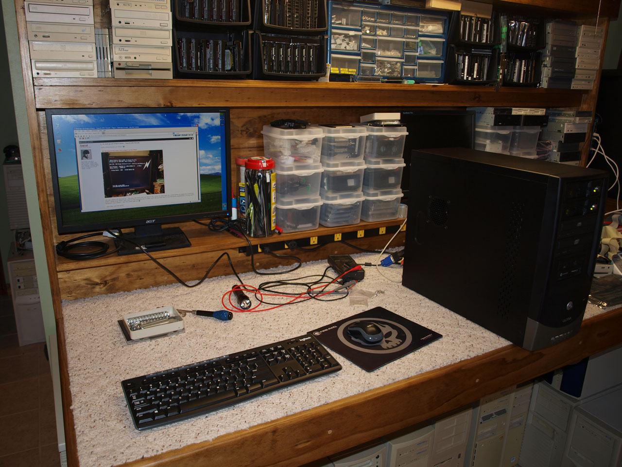

                                    I figured I'd make a quickie build out of #3, just for the hell of it..... This is pretty much just the cliffs notes.........
                                    Some old Ultra case with a 350w dual fan Allied PSU. The case had some crappy P4 system in it when I got it. It was disassembled & washed. The PSU had to be recapped of course, and the fans stripped & regreased.
                                    matching sony cdrom & cdrw under some black icydock 68-pin hdd trays.
                                    Going together.
                                    Installing XP
                                    FF 24.8.1
                                    Specs are:
                                    Abit VP6 (obviously)
                                    2x 1GHz CPU's
                                    2gb RAM
                                    ATI 9600 AiW GPU
                                    Adaptec U160 SCSI RAID
                                    SB PCI (ES1373) Audio
                                    2x 9.1gb fujitsu 10K's in a raid0
                                    Poly Edition # 1 is still sitting on the shelf, and #2 is still out in the world somewhere....but yay for # 3!!

                                      master hoarder
                                      • May 2008
                                      • 12170
                                      • Bulgaria
                                      #38
                                      Not bad at all!
                                      As I've mentioned, I'm not a big fan of black cases, but that Deer case actually looks very decent. Would have been even better if it had a side window (again, I'm not a big fan of those either) to showcase that classic motherboard. Builds like that back in the days would make anyone drool (especially when LEDs weren't common - remember those days? )
                                      Anyways, how was the Deer PSU internally? Gutless? Borderline-acceptable? Decent? I hope you at least removed the dummy load resistors in it. Most Deers have them where they dissipate too much heat and keep the caps quite toasty. Going of top of my head, usually 100-Ohm 2W for the 12V rail, 47-Ohm 2W for the 5V, and 6.8 to 10-Ohm 2W for the 3.3V rail. From these, it's the 12V rail that is the worst with 1.44 Watts of dissipated heat - enough to darken the PCB, usually.
                                      I see you also used the 9600 AIW you got recently.
                                      It's a nice card. Might be a good idea to put a fan on it if you ever use it for playing 3D games, though.
                                      Well, I suppose #1 is just special and #2 is still at work... so that leaves #3 as the "guinea pig" for playing with?
                                      Anyways, good work, as always.

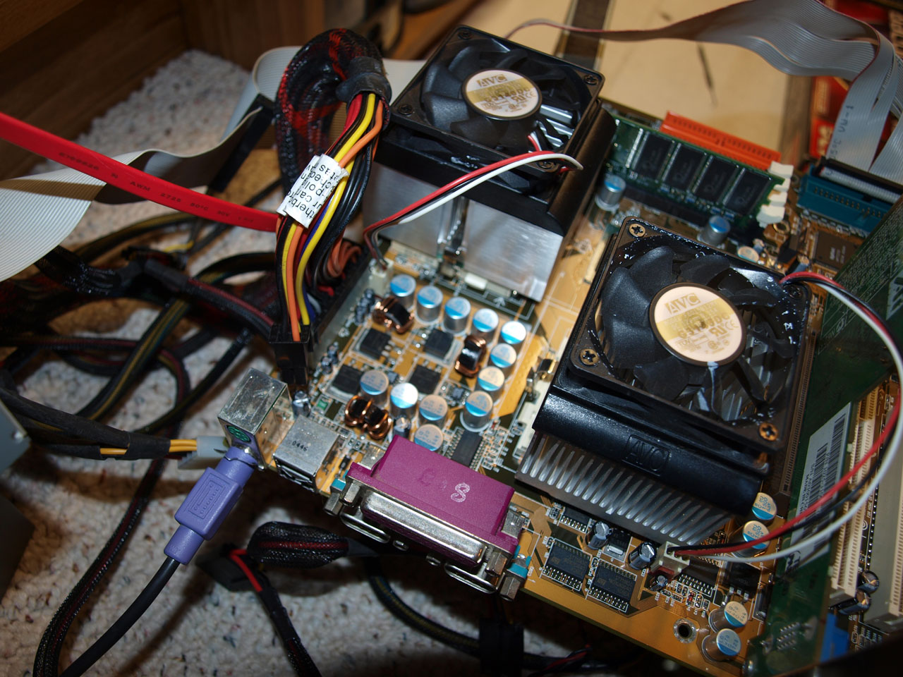

                                        The final frontier for the VP6 & me.......this is just some random VP6 I have on hand.
                                        Ok, running a single Tualatin....yawn yawn, not difficult with the right socket mods.....but running them dual, an interesting nostalgic conquest since it requires some hardwire mods that I haven't completely figured out nor was this done in its glory...heck, I don't know if it was ever accomplished....but the key to this has to be the PLL220-11 chip. Stay tuned!

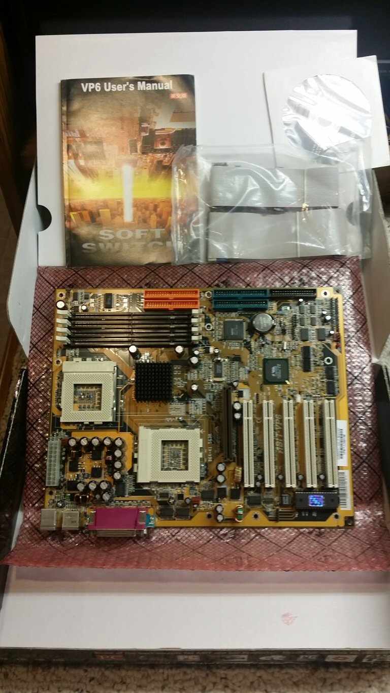

                                          .....and this project officially begins with a brand new in box VP6!!
