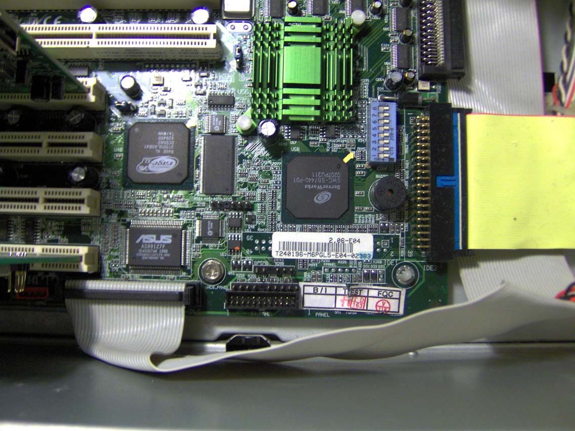

            Re: [OT] The dreaded connector
            The dreaded connector is the one named G4_PANEL, aside the "Test" label in the lower right corner:
            It's 26 pin, not 40 as I wrote; external dimension are 26 mm (lenght) for 5 mm (height) and pin interspace is about 1.5 mm, so normal jumpers won't fit into.
            Fortunately the label covers the "conventional" front panel which is still working: at first I managed to start the board by shortcircuiting the holes of power pins with a pair of paper clips, but it isn't an everyday job. Then I discovered the bios is programmed to boot after a blackout, so I started rebooting the os instead of shutting it down and detaching the power cable immediately after the reboot: my artificial blackout.
            I tried to shortcircuit every combination of two neighbour pins without success, the HP site has a lot of documents except the panel connector pinouts and, morever, I still miss the reset button and the hdd led (I watch it to detect when the os is idle: memory of old Dos boxes?): it would be nice to know if the X4000 panel connector is phisically the same, but photos aren't so detailed and Scenic doesn't own the case nor he has seen it yet.

            • gdement
                If the conventional solder pads still work, then couldn't you find the corresponding pins on the ribbon connector with a multimeter?

                  @ zandrax: you could solder those pins of the original front panel connector (under the sticker) in and simply use them.
                  did something similar on another OEM board (Fujitsu-Siemens AFAIR).
                  had a propritary connector for the front panel and the original one was under a
                  sticker and still working. so i soldered the needed pins in there and it works fine
                  BTW: you can use the WOR (Wake On Ring) connector to power up most of those boards (at least if there's an option in the BIOS to activate it)
                  shorting these 2 pins will power up the board as a usual power button would do..
                  the only problem could be that it's not soldered in on your board...

                  edit2: BTW: you could also try to solder in the second IDE port (under the label with the barcode) as the original Asus board has it and it seems that there are no surrounding components missing (except the IDE port itself)

                      Thanks Scenic for pictures and links: well, I know the conventional panel pinout (it's written in the TR-DLS manual and silkscreened on the board) and I could/should solder connectors on it, but I don't want to: I suck at soldering and everything I have tried to repair (remotes, headphones, radios) has never come back to life The board works almost fine (except for the panel issue and a cpuid message at every boot) so I simply don't want to wreck it.

                                        Thank you Scenic for all info: I'll ask my friend to make the normal panel of my TR-DLS mobo working again.
