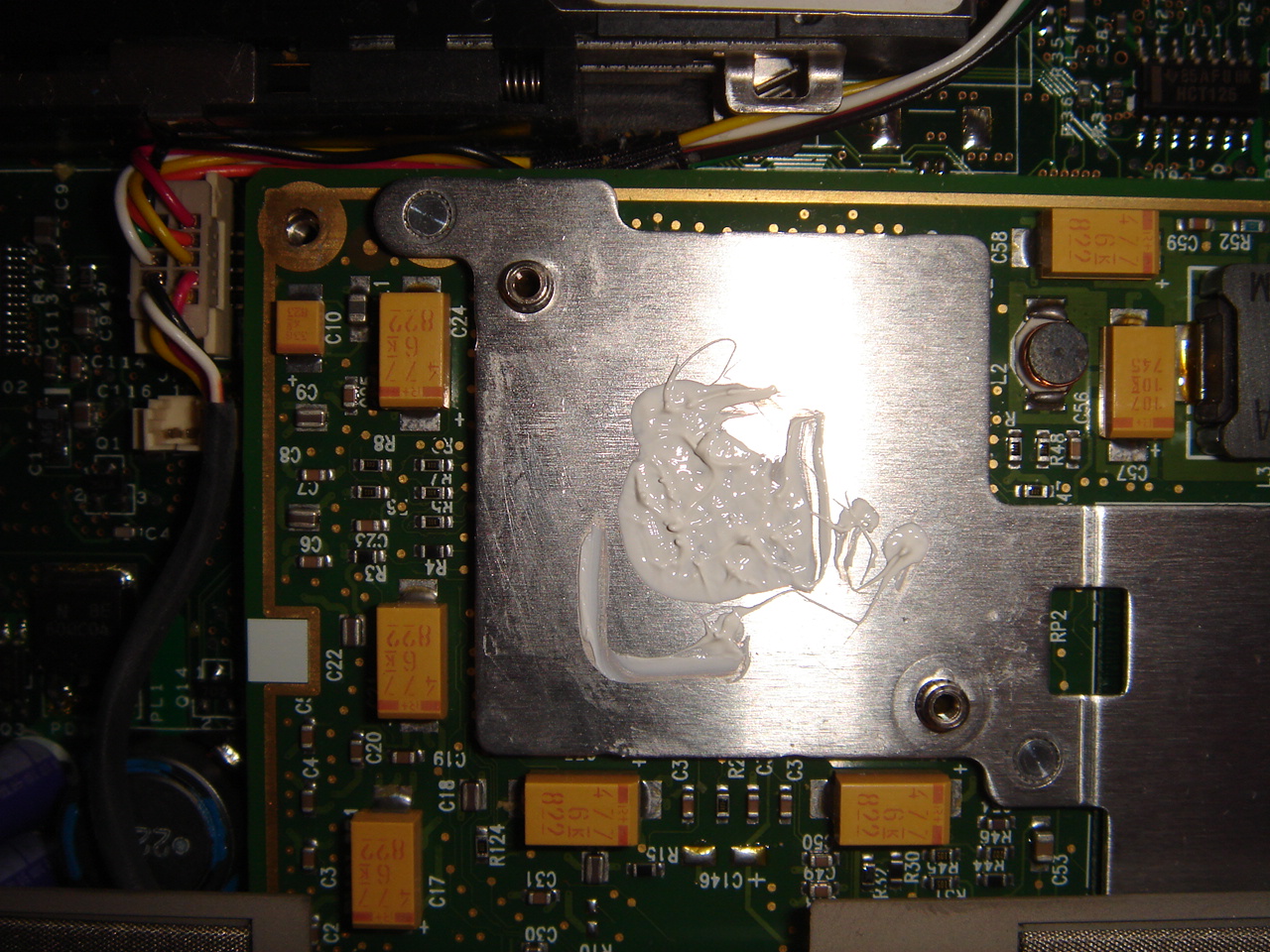

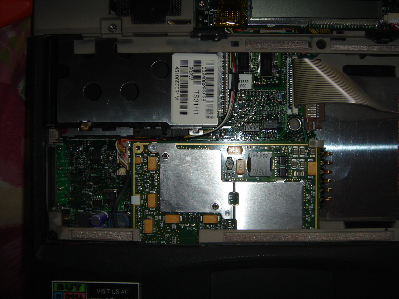

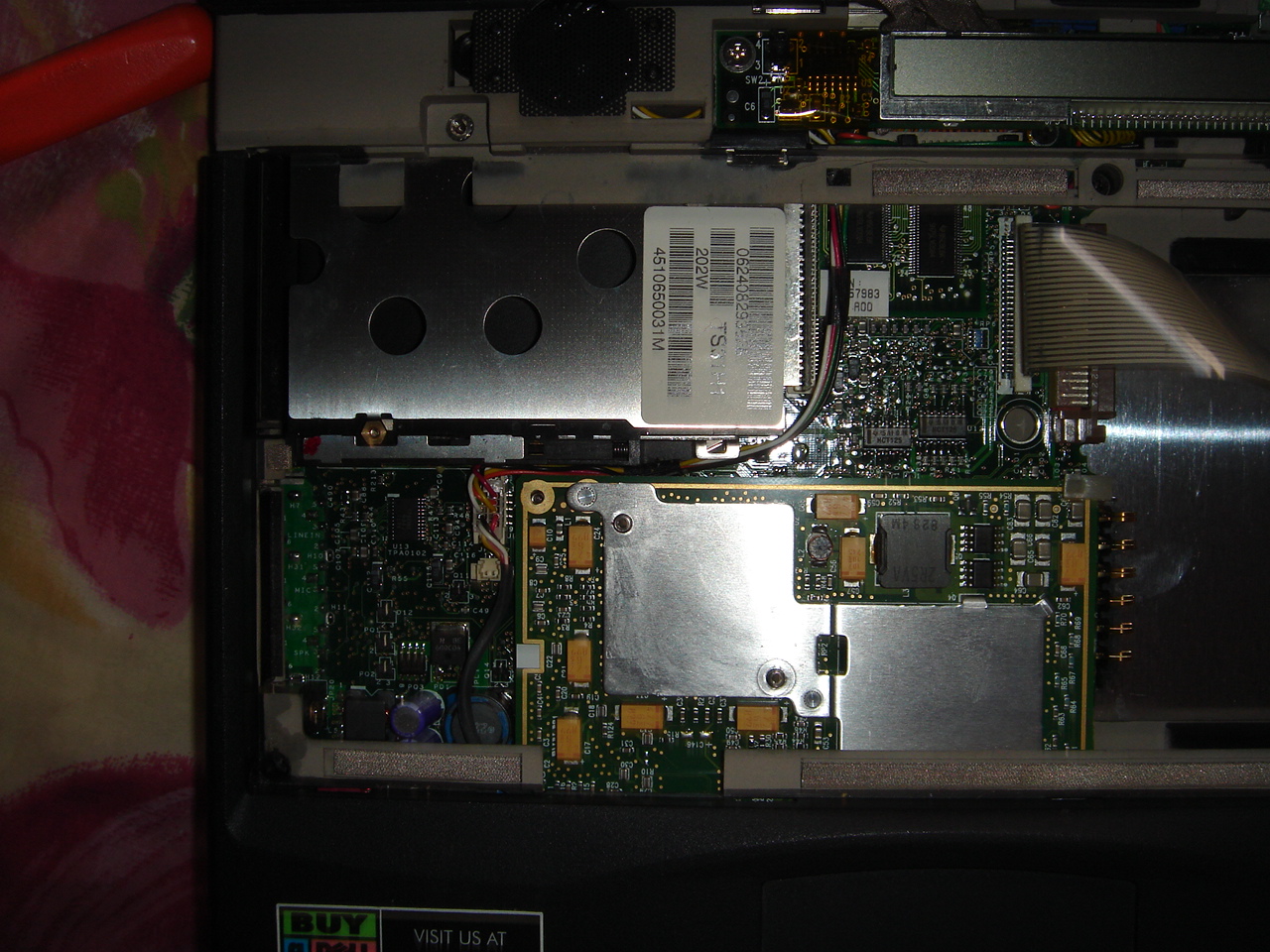

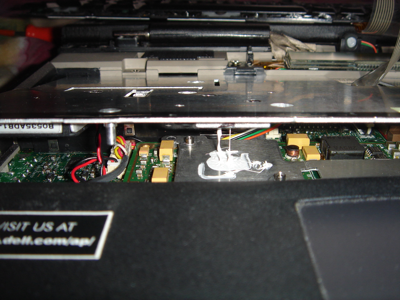

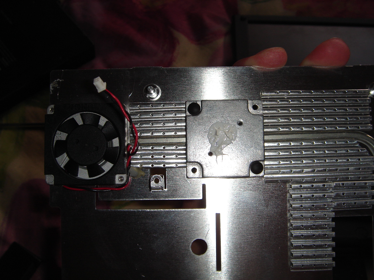

        I got some inspiration from Zandrax's thread about cleaning heatsinks so I decided to give my Inspiron 3200 laptop an opening up as well. I had a look inside and there was practically no dust in there anywhere. The thermal paste was kinda dry so I scrapped it off and cleaned the surfaces nicely with some isopropyl alcohol. I reapplied high quality Arctic silver ceramique thermal paste and for some strange reason the fan is now working when the laptop is hot.
        I attached some pics of the internals of the laptop.

          Notice the contrast between the big heatsink and the small 40 mm fan: Dell pushed more on passive dissipation than active one.
