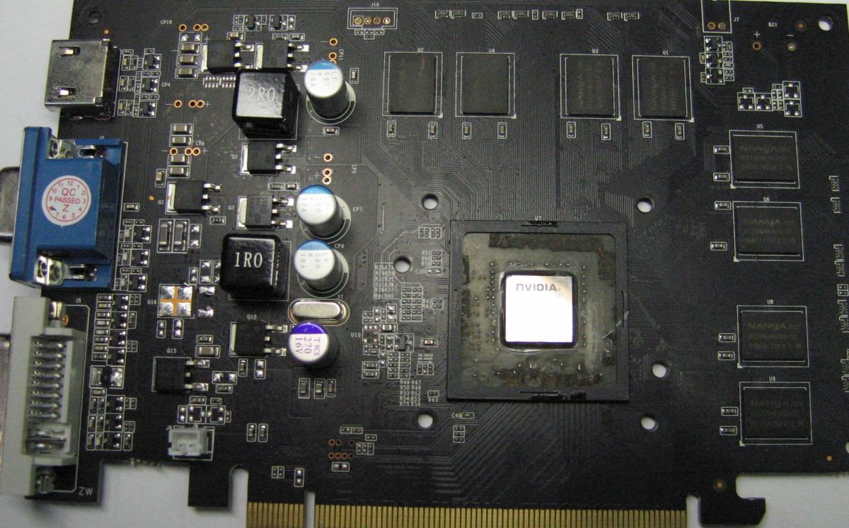

    Fake eBay nVidia "GT630"
    Beware of these cards.
    http://www.ebay.com/itm/390952405072 (I got it for significantly less).
    The markings on the chip are as follows:
    U703B118 0710A2
    S. TAIWAN
    P21289.ROP
    The last line on the chip is scratched out (except for a "G" and the top part of a 9).
    This card is marketed as a "GT630" which in itself is just a re-badged GT430, but this card is in fact an early G9x variant (2007 datecode), with the resistors set to give it the DeviceID of a GT630.
    Another very sneaky, but creative ripoff from the Chinese. My only question is why is it that nVidia drivers function properly when a DeviceID for a Fermi is given, yet the card is much earlier than that?
    I haven't plugged it in yet.

      Re: Fake eBay nVidia "GT630"
      I thought so too, but the 7-series Chips use the older logo I believe...
      I'm almost certain now that this is an 8600GT. The chips are almost identical:
          The 9000 series are G9x I believe...
          Well I won't be able to find out... Card is deader than a doorknob. Plugged it into my trusty P5B, system won't turn on with it installed.
          The job they did when they re-installed the chip on the new PCB is horrendous. Very crusty looking BGA balls, and some of them even look like they're floating when I peek under the chip from the side.
                Does PSU shut down? Sounds like your PSU went to protection-mode.
                Sounds like a shorted card.
                  Yup... Not sure what you mean, but pressing the power on button does nothing.
