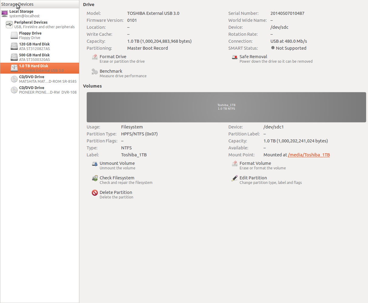

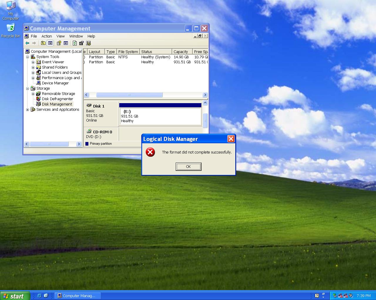

          After 48+ hours, outcome in 1st pic

          Seems it's not supported - refer 2nd pic
          Truly a P.O.S. !

            Re: Toshiba Canvio 1TB Simple 3.0 - what a P.O.S.
            Truly a P.O.S. !
            again, USB board.
