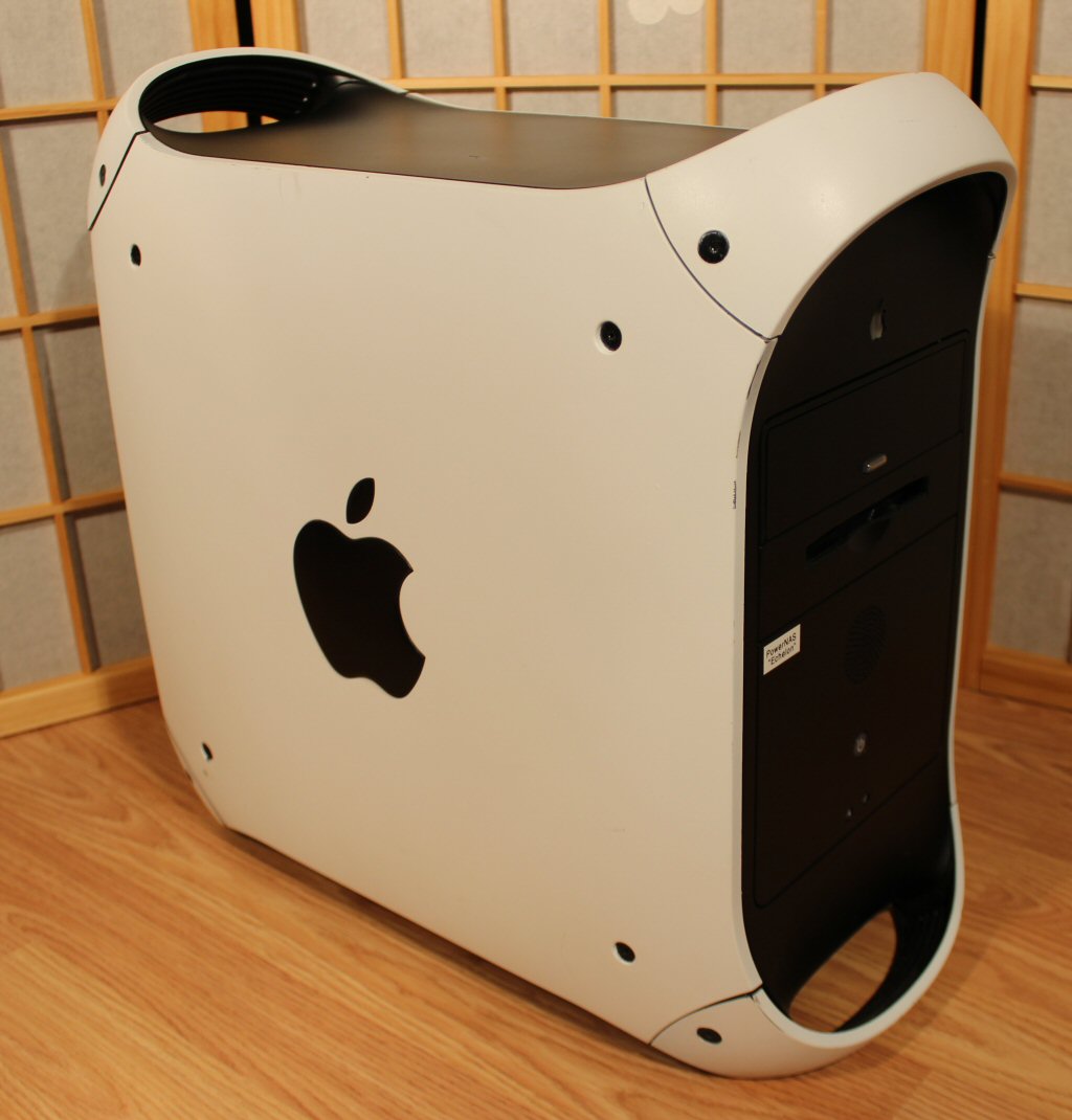

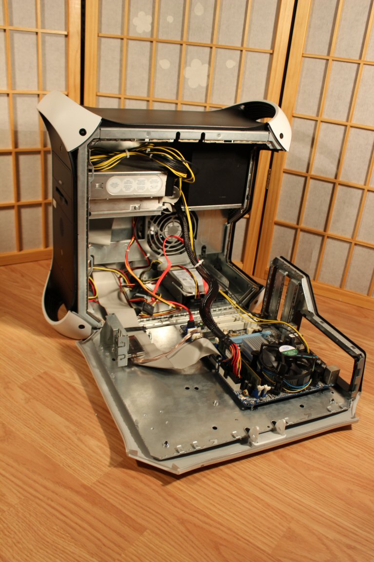

    So, I had a powermac, needed a NAS, and had a spare uATX board... what could go wrong?
    Paint went wrong... I hate paint.... but still, I absolutely love the black on white casemod so many other G4's have been through , and thought I would give it a go! This machine was a bitch to mod, obviously apply didnt design it to accept ATX boards and I also only have one drive right now, still waiting on others. I also still need to make an IO shield and button it up a little better, but I think it makes a nice looking (and pretty quiet) machine that can accept 6 drives. only have one Samsung spinpoint 2 TB in at the moment. I also need to upgrade the memory if I want to do something like ZFS, but its still a work in progress.
    I am not satisfied with the paint, I just seemingly did everything wrong. Bought a valspar paint + primer, and clearcoated it, but it just chips and scratches like mad.

    If you prepped it well, rattle can paint would stick to that plastic like stink on poo!! I have one of these system up in the attic....this thread noted to self. Also resized and attached those miserably large pictures.

      I tried my best in prepping it, including washing with isapropanol and a good scuffing, but this paint was just awfully difficult to work with and had a very easily scuffed finish. If you want a fun project though I would definitely recommend casemodding one of these puppies, makes a cool looking rig
