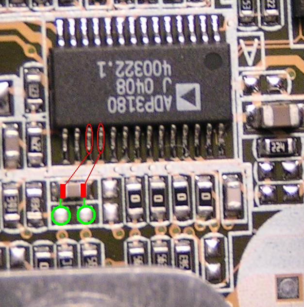

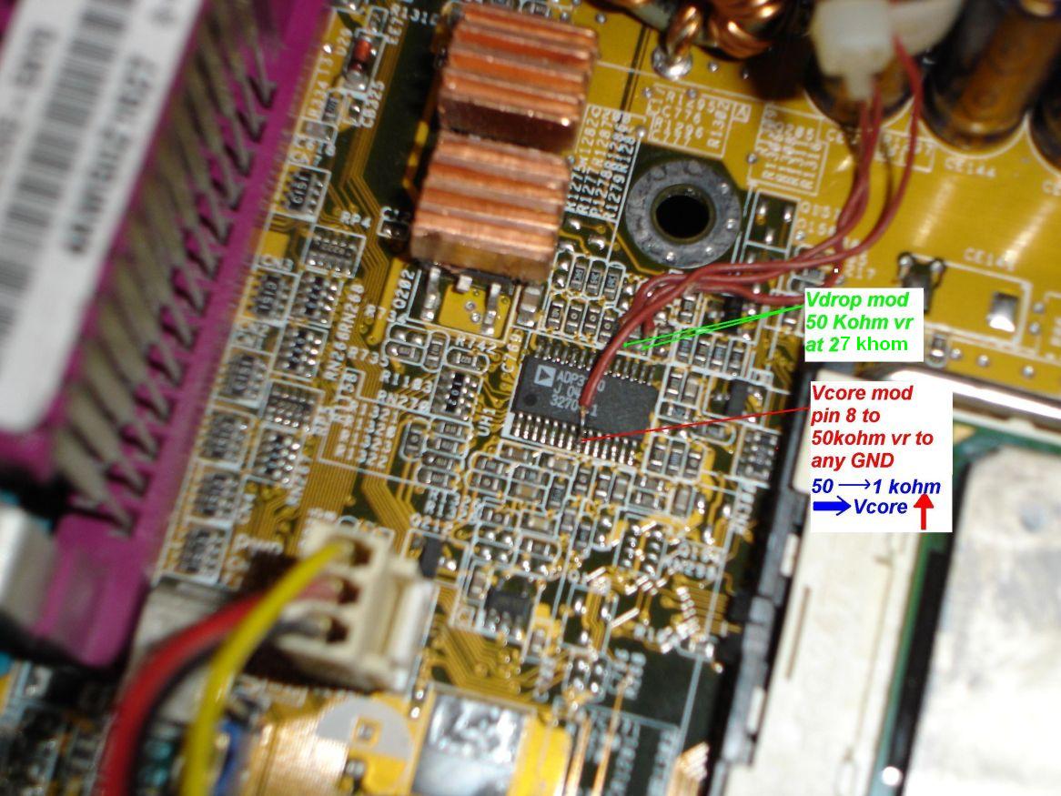

    Hello Guys,
    First I must say I am from Germany, so I hope you understand my English.
    I just signed these forum to learn something about soldering / modding and mostly repairing things.
    2 months ago I decided to try a so called "Vdrop Mod" to increase the OC capability of my Asus P4C800E Deluxe. It is a well known problem that the board reduce Vcore on load to reduce heat and stress in the cpu. But this prohibit a high OC I want to reach, in my case I want to reach stable 24/7 4GHz OC on my P4 Extreme Edition 3400 CPU. (Link to my old system, sorry german).
    The problem is/was, i don“t know anything about these mod and how to solder on such tiny circuits. My big fail was I used a normal 100 Watt soldering iron (like these) and destroyed the board because of heavy heat impact on the bord. Atm this board is still running well, but it cheeps very load from the area I raped it.
    My question is, does anybody know these mod and know how to make it? I have added some pictures I have found on the Internet to this topic. It seems so there are many ways to solder this mod in.

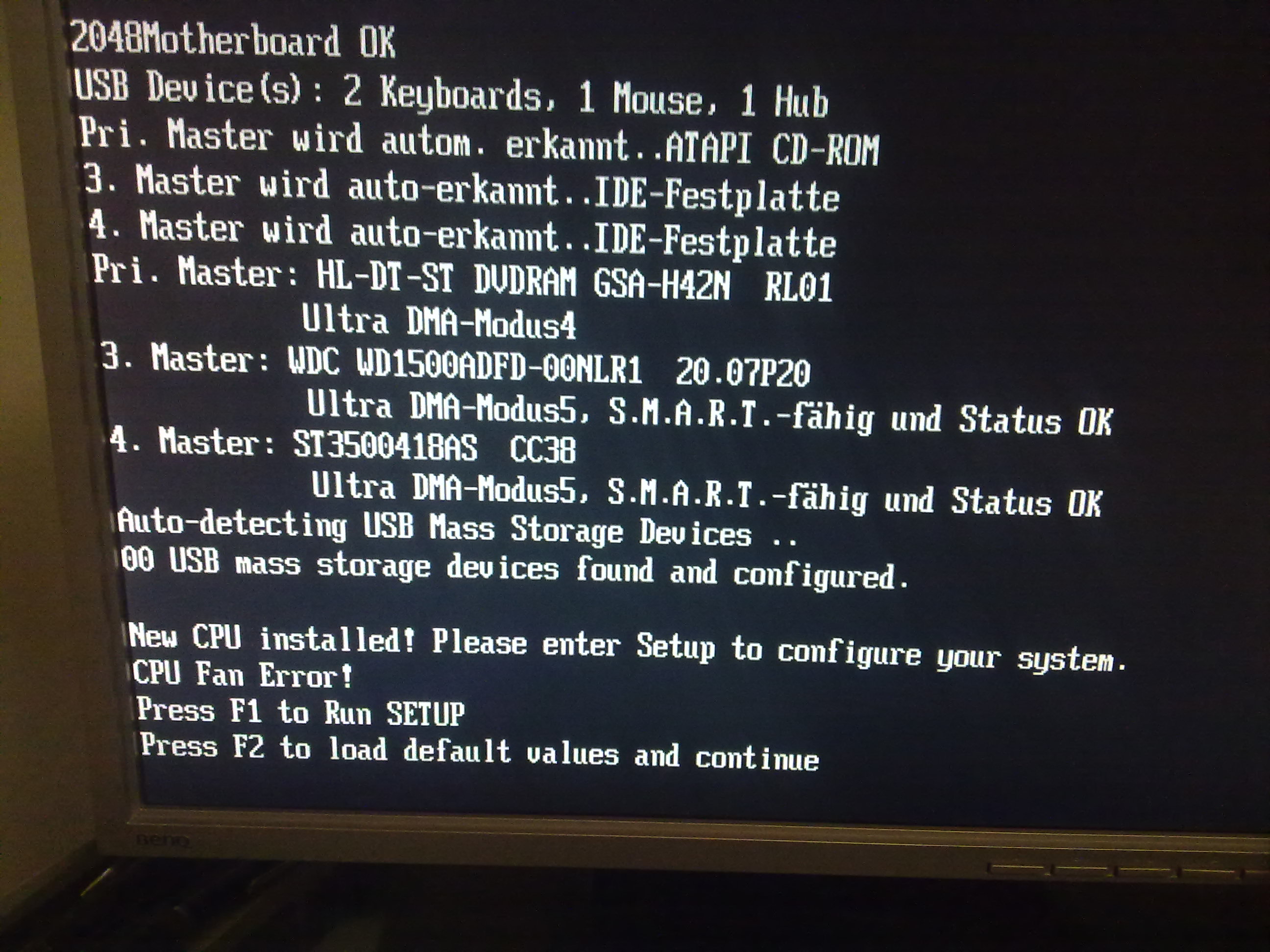

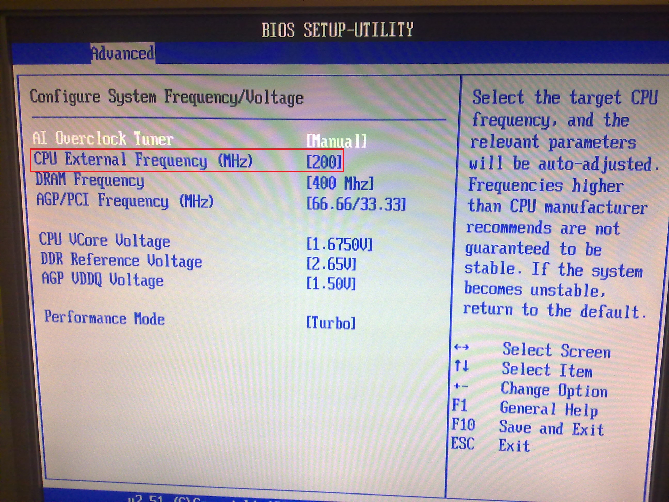

        2 Days ago my "new" P4C800E dlx arrived. Its looking good, I thought. All caps up the CPU socket were Rubycon ones. I can see no scratches or bad caps. According to revision numbers and mainboard marking this is the newest board of my P4C800E dlx collection (atm I have 4 boards, 3 wrecked).
        The problem this board cannot detect my CPU (P4 Extreme Edition 3400 Mhz). I just flashed newest bios 1024.001. But it still refuses to detect my CPU, every restart/boot (also hot restart with turning pc off) the board the message "new CPU installed". I never had these message on my other P4C800E dlx boards.

          Re: Tried to "Vdrop mod" my P4C800E Deluxe - destroyed it
          First thing is try a new battery anyway, ASUS likes fresh CMOS batteries 2.78V may be to low.
          Second thing is Bios 1024.001 is a beta bios. Try flashing back to Bios 1017 and make sure you set bios to default settings after the flash. If that works and you get no warning then try bios 1024.001.
          I have had many of these and managed to get most of them working when others gave up.
          What is the spec # on the CPU?
          What type of heatsink mounting are you using?
          Some came with a backplate that would cut traces and solder points on the motherboards back side and cause issues because of the pressure over time of the cpu heatsink being clamped down.
          I have also had a few of the boards that required (what seemed to be) extra pressure on the heatsink to get the cpu to make good contact in the socket.
            Just ordered some (Panasonic).
            Tried 1017 / 1019 (as it was from seller) / 1023 - same problem
            Tried annother working bios chip form one of my brocken P4C800E dlx with 1024.001 - same problem
            Intel Pentium 4 Extreme Edition 3.4 GHz SL7CH supported since Bios 1016 - never had problem with other P4C800E dlx and 1024.001 Bios
            What type of heatsink mounting are you using? Some came with a backplate that would cut traces and solder points on the motherboards back side and cause issues because of the pressure over time of the cpu heatsink being clamped down.
            I use Scythe Mugen 2 Rev B Cooler. He has a padded backplate. Never had any problems with other P4C800E dlx.
            Red this in other threads regarding to this topic. Tried to improve pressure by adding flat washers and even 4 small nuts. But I refuse to tighten the screws too much in this situation. I don“t want to crack the board. But never had problems with my other P4C800E dlx boards and this cooler. Last alternative is my old Zalman CNPS7000-cu. But I dont think this will solve the problem, so I dont tested him yet.
            Just same strange things I experienced with this error:
            If the failure appears, only the CPU OC settings went away. All other Bios settings stay the same. The failure appears when restarting under WIN XP SP3 Prof, no error with dos bootable floppy disk (restart CTRL-ALT-DEL)

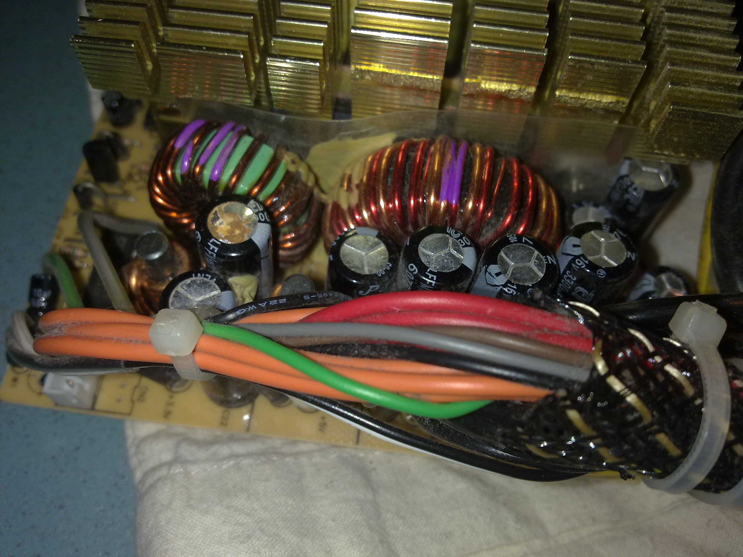

                          But Kiriakos GR post to psu problems bring me to the idea to check my Enermax Liberty EWT500ALT. And yes there is one, or maybee 2 bad caps.
                          I dont know which voltage rail they belong, but to increase stability this must be fixed. Maybe this cause these "all of the sudden pc turn offs" with all my 4 P4C800E dlx boards. It was random, most time when I connect a usb device the pc turns immediately off and sometimes dont turn one for some time. Unplug the power cable of the psu and wait for 10 minutes solved the problem the most time.
                          I never thought this was a psu problem because I thought Enermax was a very good psu manufacturer. I thought this was the common known "USB latchup" problem with or in the southbridge.
                          Well I will try to make a complete recap of the psu and try it again later. I will ask the questions relating to this topic in another thread.

                            Ok guys, I just repaired my Enermax Liberty psu and put a new bios battery on the board. I checked the new battery before, it has 3,3 V. The old one had 2,87 V.
                            But all this don“t fix the problem. The board still boots with "new CPU installed" message. Any ideas?
                            Meanwhile OC ability get a little bit better due to the psu recapping.
                            Mostly the 12V and 3,3 V line got more stable and stay stable under heavy load, but also in idle or Bios.

                                1) This CPU is unknown to your BIOS_ AUTO Save does not work.
                                CPU is well supported since BIOS 1016. click Never had such problems with 3 P4C800E Dlx Boards before...
                                2) Settings does not saved by auto detection? Save them by your self in the BIOS screen.
                                I don“t use auto detection. I am overclocking my CPU. So every entry in Bios is set up by myself. Even beside CPU settings. I use successfully this bios settings for 3 other P4C800E dlx Boards, and this is the first time I got this failure! This is a Motherboard fail!
                                3) Battery voltage issue? If date & time stays correct ..There is NO such issue.
                                -> If I take power away form system (psu off, cable unpluged), all bios settings go away. Including date & time and ALL other settings. "New CPU installed" message occurs too.
                                -> If I just turn the pc off, but leave the psu on standby, the error occurs. Message see picture 1. If I press F1 key I go in the bios and and found all bios settings in the condition I set them up before except the FSB. See picture 2. It goes back to 200 Mhz every time.
                                But don“t think this is a oc failure. When I leave 200 FSB, the "New CPU installed" message occurs too! The Board don“t boot without this message, except I reboot from DOS environment.
                                4) END of the story.
                                Not true. AGAIN: I have 3 other P4C800E dlx Boards and this error occurs the first time! There is also a possible reason for this failure, the user kc8adu posted it before:

                                    Ok, problem solved. It was the Cooler "Scythe Mugen 2 Rev B."
                                    The cooler Backplate to be precise. It may be the exact thing posted in the 5th post in this thread:
                                    Some came with a backplate that would cut traces and solder points on the motherboards back side and cause issues because of the pressure over time of the CPU-heatsink being clamped down.
                                    The original backplate of the "Scythe Mugen 2 Rev B." has different shape compared to original Intel Retention module.
                                    It covers several pins of caps. The 7 caps above the CPU socket to be precise. Normally the Mugen 2 backplate has some sort of soft isolation material on the back. But over the time these material gets penetrated by the pins of the caps. So maybe the pins where shortened.
                                    Now I use a Intel Retention module backplate and it works fine. No more "New cpu installed" message. No more Bios loss on power off conditions.
                                    Problem solved. Thx to the badcap community for help.

                                        You don't need risky soldering to keep vdroop at bay, you just need a pencil .
                                        "... as the resistance needed to be added is very low, graphite can be substituted in place of a variable or fixed resistor(s).
                                        Simply use a pacer (mechanical pencil with a thin tip) and 2H - 2B graphite, and lightly shade between legs 17 and 18 of the ADP 3180 chip. Check vdroop, add more graphite if droop still unsatisfactory, or if vcore rises under load, remove some graphite with a paintbrush or cotton tip ..."
                                        http://www.xtremesystems.org/forums/...cil-Vdroop-mod
                                        This is as ghetto as they come but works like a charm, after some penciling the max Vdroop is ~0.02 V .
