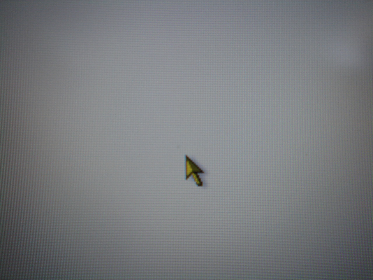

      Ok, now i got a picture, i hope this helps, it may seem small but sometimes the other "dots" that die become quite large which worries me. In the picture, it is that thing above the mouse pointer.
      If anyone has ideas to what this thing is.... PM me immediately.

          well each pixel on a screen is made up of a red green and blue pixel. what they do is filter the white light from the tubes to make the correct colour. those pixels are either on (letting light through) or off (not letting light through). in your case the green is stuck and always on.
          i have seen quite a few red stuck pixels also and they are very much less irritating than green.

            i was using a desktop LCD and it had a pixel that was constantly on (white). I pressed on the screen a bit and I was able to get it to where it was hardly noticeable. On a white background it would be an off white. On black it was sort of a dark green....or was it red.....damn i hate getting old.

              There are some programs which fix the dead pixel. I never tried it since my lcd is good.
              www.jscreenfix.com
