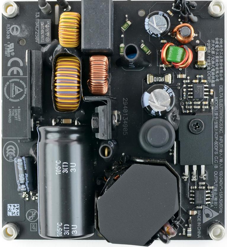

    Good Caps ?
    Good caps in this motherboard ? awesome
    [/IMG]
  • mariushm
    • May 2011
    • 3799
    Re: Good Caps ?
    It's made by Delta, probably for Apple, so of course it's going to have good capacitors. Delta in general uses good capacitors.
    It's used in Airport Extreme : http://www.ifixit.com/Teardown/AirPo...ardown/15044/2
    • c_hegge
      • Sep 2009
      • 5219
      Re: Good Caps ?
      Yes. Those caps are Rubycon, which are fine.

        Re: Good Caps ?
        Every Delta I've seen had Ltecs.
        • mariushm
          • May 2011
          • 3799
          Re: Good Caps ?
          Old Deltas had Ltecs. Even older Deltas had United Chemi Con and Taicon (I have a 100w psu full of Taicon). They still use Taicon a lot - which is a subsidiary/offshoot of Nichicon.

            Re: Good Caps ?
            I've seen delta psus with Nichicon caps and OST caps too (the OST, 200v 680uF were bad)

              Re: Good Caps ?
              How old? They were in a printer from 2011.
              • mariushm
                • May 2011
                • 3799
                Re: Good Caps ?
                It depends on who they were OEM for, I guess for large orders they're flexible in regards to using customer's parts or going with their less good choice.

                  Re: Good Caps ?
                  Never seen a Delta with an OST or Teapo, or anything alike... you sure it wasn't a CapXon or Elite? :P Not trying to doubt you, but OST sounds more like a Seasonic build to me, or Lite-on or Hipro, or FSP.
                  • cheapie
                    null
                    • Jul 2010
                    • 849
                    Re: Good Caps ?
                    They were some printer power supplies
                    That's what it was - a Lexmark C543dn. Lexmark splurged on Rubies for the motherboard but couldn't get Delta to do the same in the power supply. It was a mix of Ltec and CapXon - 2 Ltecs (under the +12V rectifier heatsink) failed.
