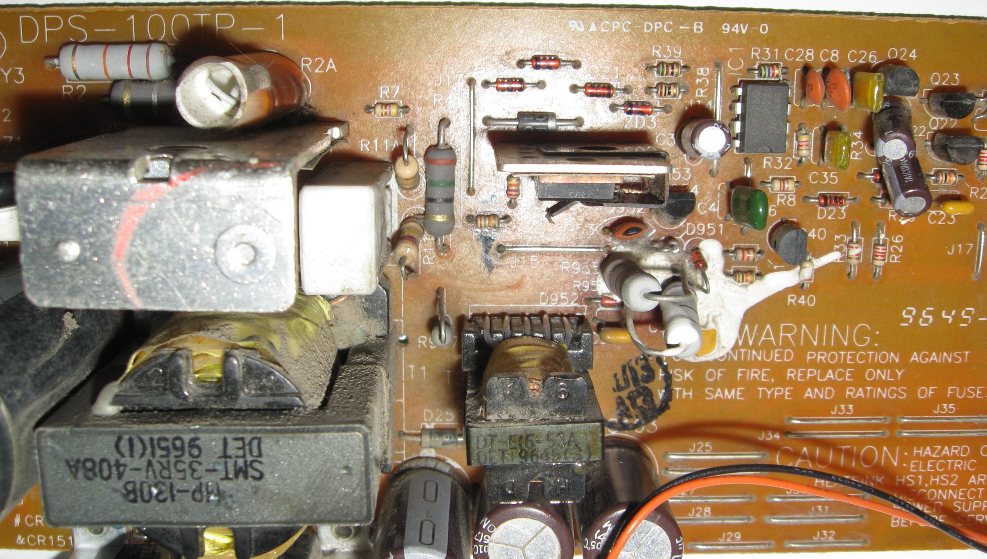

    Decent mains filtering, main capacitor is Rubycon USB 270uF , 400v - enough for the wattage, with ~1.7 ripple and 2000 hours @ 85c if i remember the datasheet values correctly.
    Bridge rectifier with one of those things (the proper name escapes me now) glued to it that I assume will limit current when the rectifier overheats)
    The Schottky diodes are s30sc40m (40v 30a) which seems to be used for the 5v and a much smaller one that has BY208 written on it, for which I couldn't find a datasheet (but I guess it's enough for 12v 4.5v) ... there's a thermal sensor attached to the small metal heatsink and the metal heatsink is screwed to the case so there's plenty of heatsink.

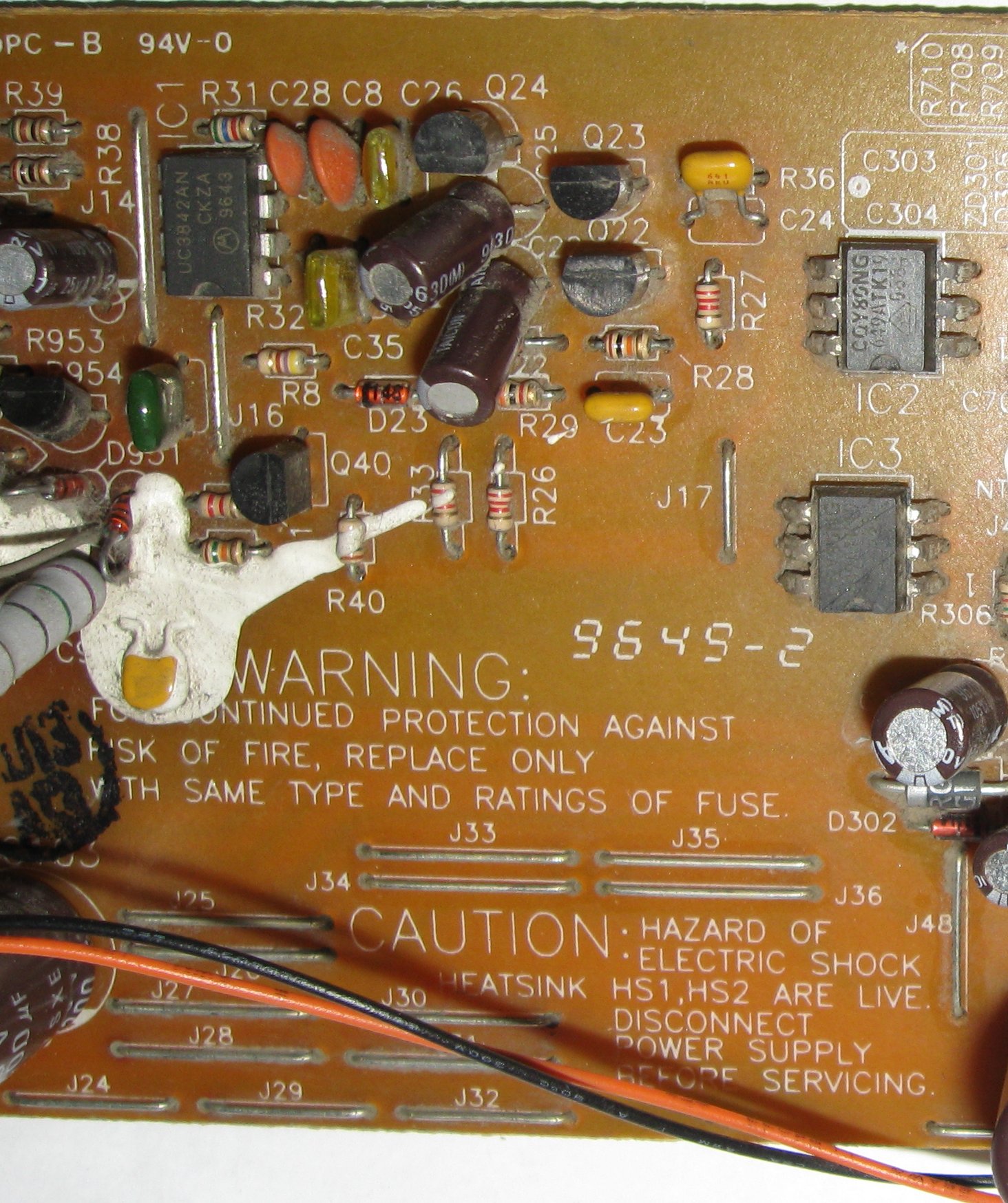

    Can't determine the main switcher chip due to heatsink, but there's a 1-3w resistor in shrinkwrap almost glued to it that looks to be a bit burned. On the right of the transformer there's another to220 chip that I can't tell what it is due to the heatsink clip.
    The controller is uc3842an, 500Khz frequency.

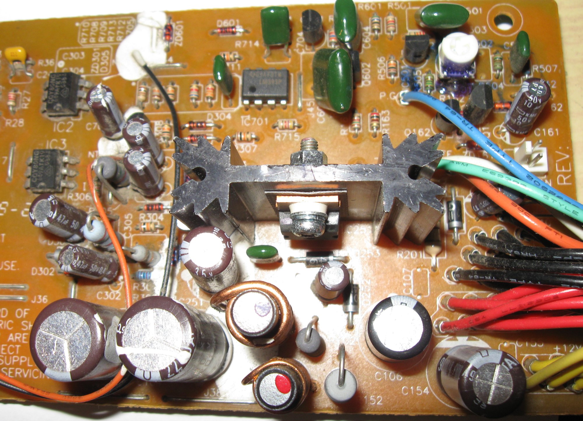

    The capacitors are all UCC SXE, KME... the large ones are 2200uF 16v (1) and 10v (2) in the mains section, in the secondary there's another set of 2200uF 10v for the 5v lines, a lonely Rubycon 1000uF 10v, and a Taicon 1000uF 16v for the 12v...
    The -12v has a UCC 220uF 35v and the -5v I think has... nothing, don't see any capacitor by the regulator larger than 10uF... the 5v stand by with the "huge" 5 mA rating has a 47uF 25v.
    All the other small capacitors are UCC and a few Taicon spread around.
    I started it by shorting the ps/on wire to ground and the 5v line measures 5.3v but the 12v line measures 10.96v. 5v standby was 5.03v. Obviously 10.96v on the 12v rail is bad, but right now I can't tell if this is due to no load or for other reasons.
    Your thoughts?
    It's due to no load. On an unit this old with almost all the capacity on the 5v rail, it absolutely needs a bit of load (1A or so) on 5v, for 12v to be in spec.
