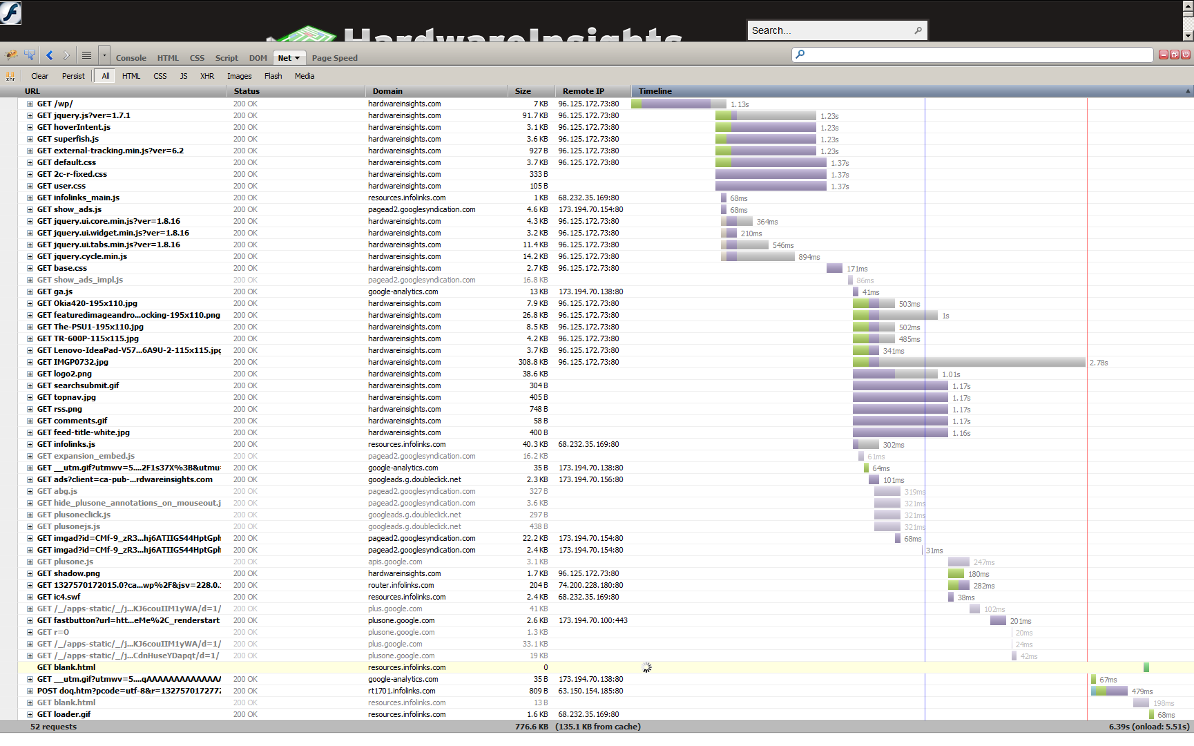

          Re: Should I host it all at home?
          Uhmmm..... number 1.
          Full control is not really required for a website with low number of users - if you make enough money out of ads or out of a separate job, you'll afford to move it to a vps or a dedicated server and further improve it.
          Backup slow? Maybe you're not doing it right. Maybe it doesn't really have to fast... There are tools that help you automate and create a backup and save it ON the server and then you simply ftp the whole tar.gz/zip/whatever to your computer - the slowness will then be just your download speed.
          Hosting at home is not feasible with DSL. It might work with cable and fiber, depending on the ISP but it won't work with DSL.
          1. You have only 768k upload - that's at best 768/8 - 10% overhead = ~ 80 KB/s upload. Each user loading your website for the first time (not having anything cached) will download about 780 KB from you, about 650KB being from your domain.
          No user will use your full dsl upload speed due to routing (routing, lots of servers between you and him, you doing some download or serving other people) so assuming you'll have 50K/s to him, it's gonna take 650/50 = ~ 13 seconds just to transfer the file + about 3 seconds to resolve your domain and make the connections and so on.
          You can see in the image above it takes 6.3 seconds now to load your site from the hosting you have, and I'm on a 100/6 cable connection.
          After the initial caching on the user site, your website will still send about 150K with each page, because some of the files can't be cached due to the ?ver= in the URL, which is added by wordpress.
          2. You'll have a lot of problems maintaining the domain - ip updated and it may be even against the TOS of your internet plan to host servers at home.
          3. You won't be able to send mail (user registration, change password, send newsletters, blah blah) - residential ips are generally automatically and voluntary added by isps to anti-spam organisations and mail servers reject mail coming from them.
          .. and there's more reasons but I guess these are enough.
          You might be able to host it from home if you figure out how to serve static content from somewhere else (the js files, the jpg files etc)..
          ex.
          you could get a cdn and pay 0.10$ per GB and have that serve the js and pictures and then you only serve the 15-20 KB php scripts
          you could use Google apps for website and its free cdn (limited to a small requests per day, adequate if you have few visitors)
          you could use a service like sendgrid.com for mail which would cost you about 10 cents for 1000 emails sent..
          and there's lots of other tricks or things you could do
          - but the simplest would be to just go with hostgator or a shared hosting company better than hostgator.
