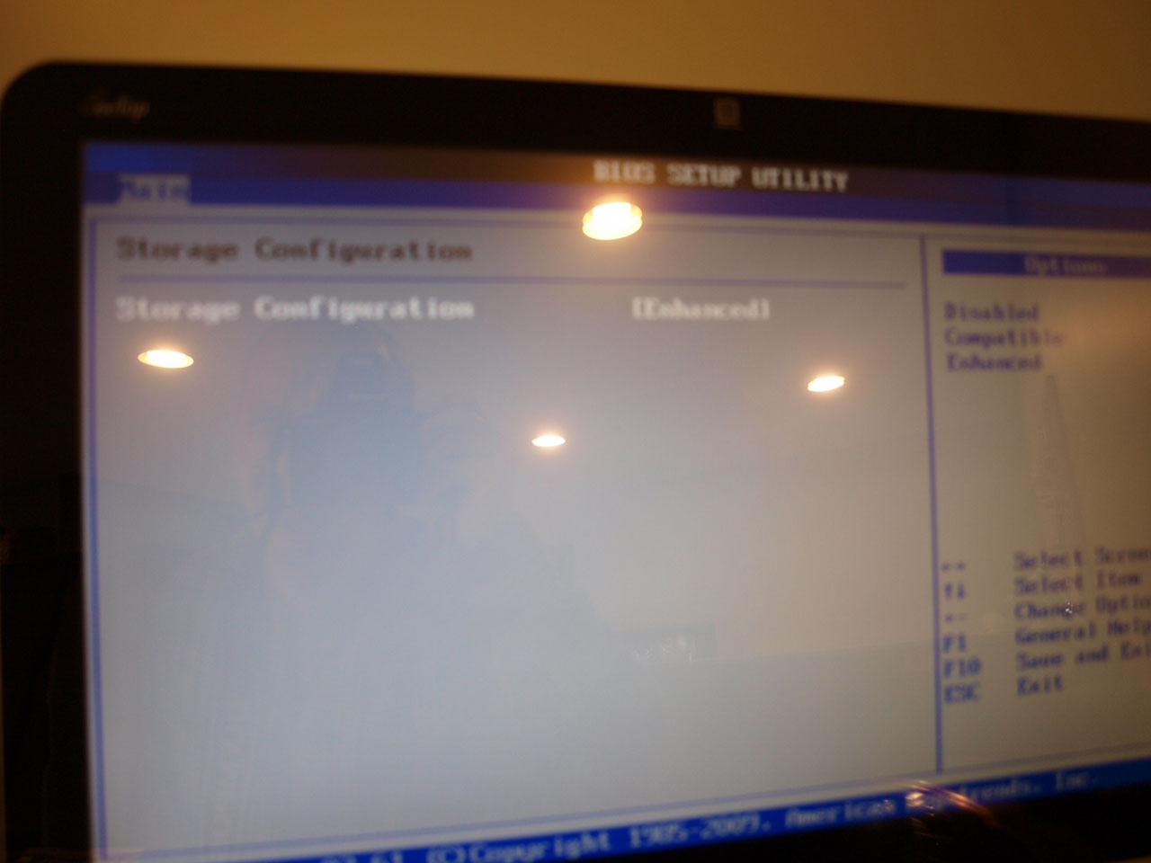

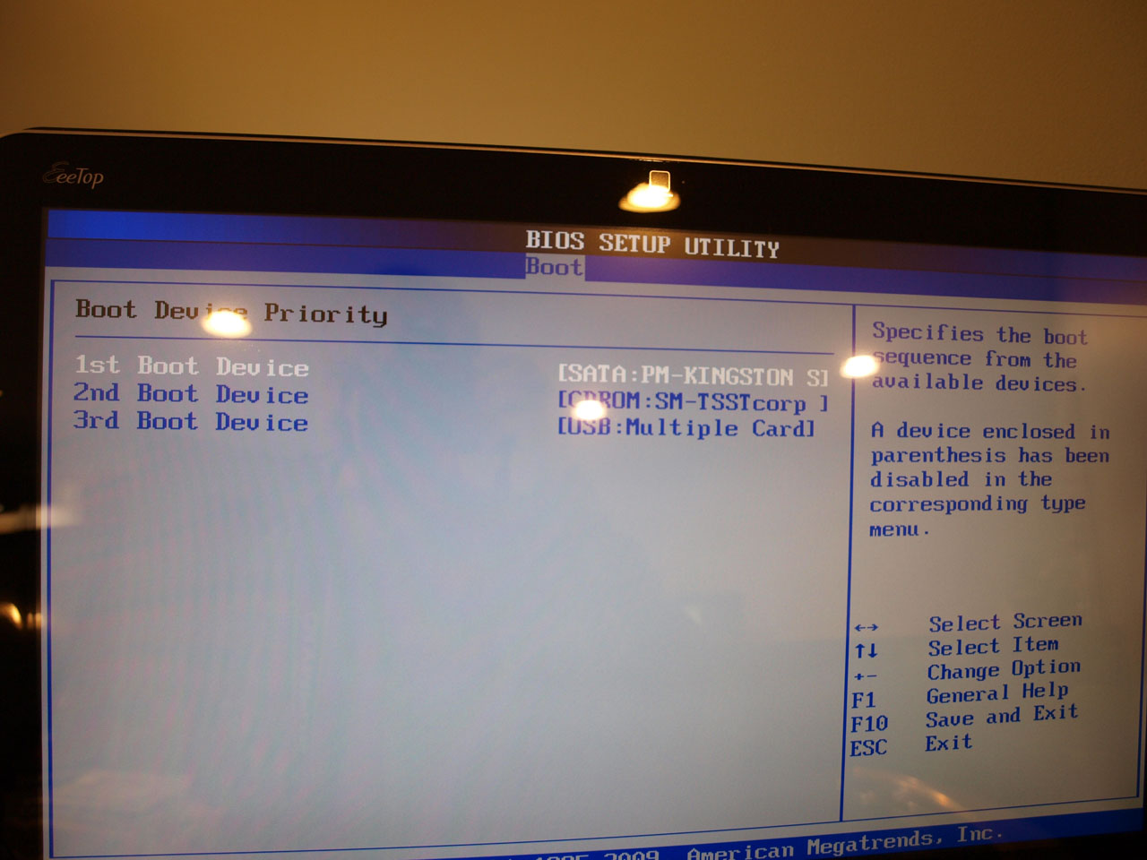

    HDD is a kingston v300 120gb, in enhanced mode. win7 did not ask for a driver, saw the hdd no problem. Make sure you have the latest BIOS on it.
      Sounds like the OP in that incident has a faulty controller. Apparently it's not uncommon with this chipset. That issue he's describing is exactly what happens, it really isn't the SSD. I've seen it on these chipsets before (not on this particular system), and they behave exactly that way....they get drag-ass slow accessing the HDD (even a SSD), and the BIOS gets finicky in detection, even an old spinner.
      Many thanks. That OP is me, by the way. I'm going to give it one last try with a $20 used V300 from ebay. I've never had any issues with spinning HDs in it, so hopefully it's just a finicky controller and not a faulty one. Fingers crossed!

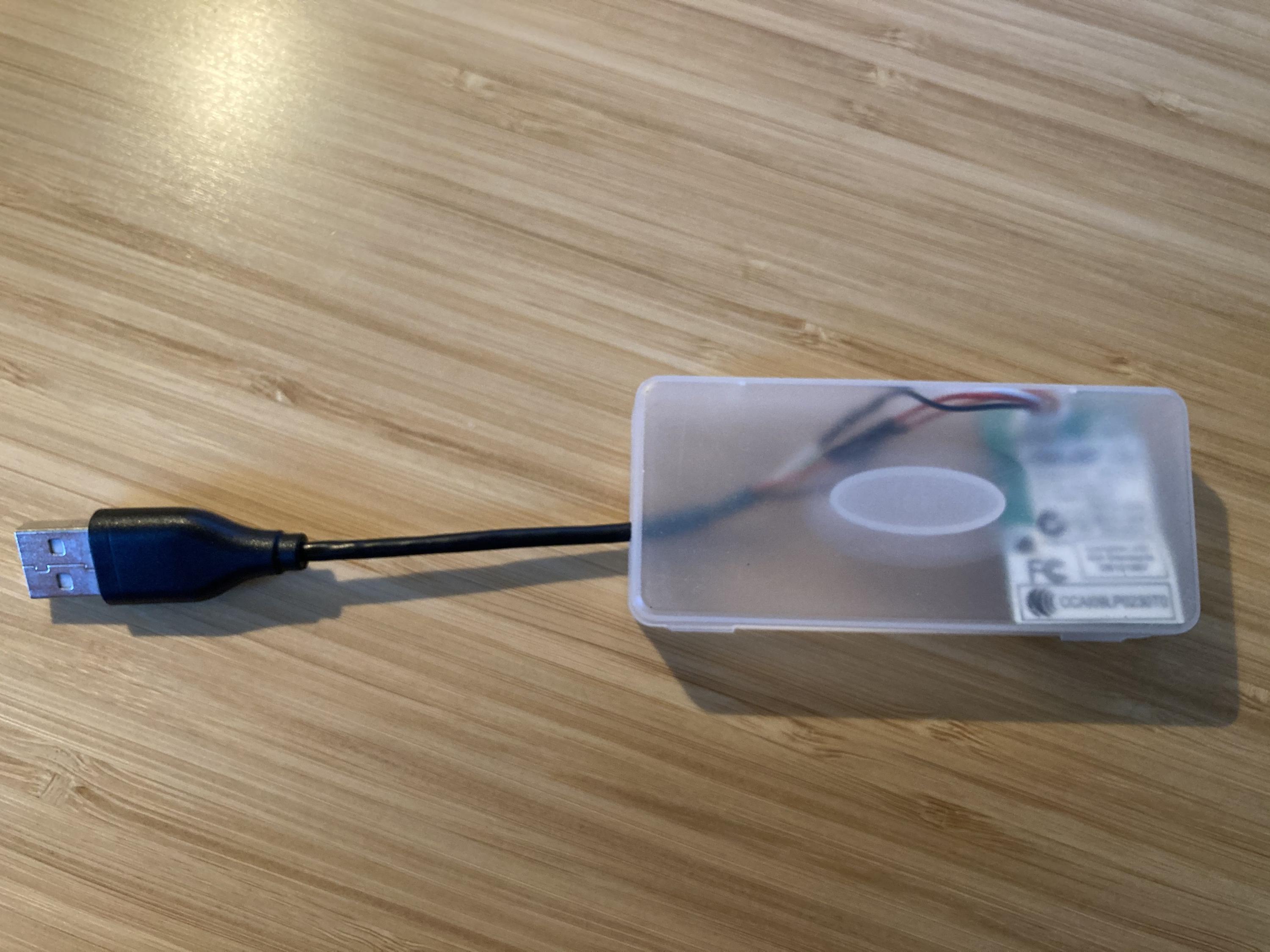

          Fun fact related to that ebay listing: The internal IR receiver for the mouse and keyboard (the ER-C21) has a standard USB interface. I found the pinout attached to an FCC filing. I removed it from my machine and used a cannibalized USB cable and a JST SH 1mm connector to make a homemade dongle so that I can use the wireless mouse and keyboard with any computer. Not pretty but it works! And it keeps a perfectly good wireless combo out of the garbage once the computer expires.

              Nope--proprietary. Silly to tether them to the machine like that, but that's what Asus did.

                The receiver may be a combo unit with IR build in, but the keyboard & mouse themselves are indeed bluetooth. IR would require them to be in 'line of sight' like a TV remote, that's not the case with these....they work from a BT radio. If you look at the board you modified above, note the 'squiggly trace' on the back side of the metal shield, that's a small antenna.
                Nice job modifying that though.....

                  Oh I agree that it's RF. What I meant by "tether" is that the RF connection is proprietary, akin to the Logitech mice and keyboards that require their "Unifying Receiver" to connect (but without the ability to take the receiver with you). You can't pair the Asus mouse or keyboard with any old Bluetooth-enabled laptop (I tried). So the mouse and keyboard go down with the ship, so to speak, upon the computer's EOL.
                  Also, I think that the component that looks like an IR receiver in my photo is actually just a capacitor. Here's a much better photo:
                  Here's the main listing on the FCC site, btw: https://fccid.io/MSQER-C2I

                          Okay, I tried the same Kingston SSD as you with no luck. Basically hangs while trying to install Windows 10 on the SSD from a USB. (Installed on a spinning HD no problem.)
                          So when you say "faulty controller" do you mean that the southbridge I/O chip (see pic) is bad? I can buy a new one for $10 shipped; and a buddy of mine has a full rework station.
                          https://www.ebay.com/itm/1-Piece-New...t/271913871350
