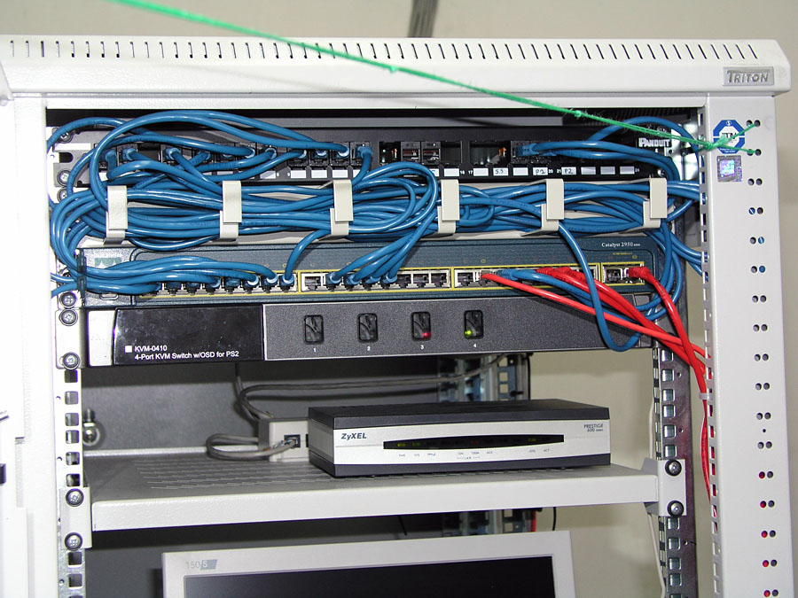

    heres some pics from today, mixed up with some old pics. i realise it aint much but i am pretty proud of getting this system approved by accounting. Rackmount costs more but it doesnt have to cost too much more and it is just great to have everything in one location and secure.
    cables were messed up last time i posted. i cleaned them up a bit.
    At the top is a panduit modular 24 port patch panel. you can read more about that here http://www.techmati.com/articles/lan/index.htm it is a joy to work with and easy to add more ports when needed, you fix them outside the panel and just snap one in. no need to disturb anything.
    Below that is a cable tidy which has the same clips around the back which are very useful. a future mod might be to bolt a piece of black acrylic on the front to hide things.
    Then below that it a cisco 2950t switch which has 24 10/100 ports and 2 gigabit ports. it is an excellent switch with nichicon caps. needs some small configuration which you do via IOS so lots of head scratching over syntax. can get some reports out of it which are really useful, i found some cards were set to half duplex from those reports.
    below that you have a levelone kvm which has 4 ports. it has single kvm cables for each server so no mess and the signal is good. you just press the big buttons to change between each server or use keystroke commands. only objectionable part about that kvm is that it has a wall wart psu. yuck!
    then on the shelf there is a zyxel prestige adsl router and behind that the splitter.

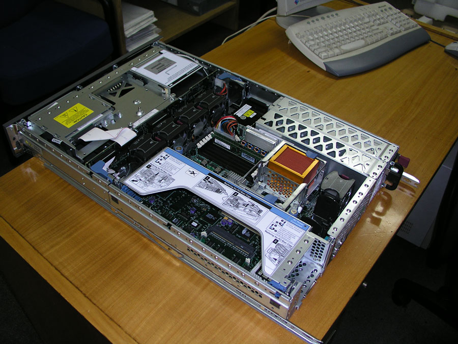

    here is what it looks like when one of those goofy 4u cases gets pulled out on the rails for servicing. that is the mailserver actually, its just a pc in a server case. runs win2k server and mdaemon mailserver which absolutely rocks as an imap mail solution. they call it the "exchange killer". its got its own webserver for serving up attachments or webmail. can even run it on a non server windows that way.
    • dood
      Deputy dood
      • Mar 2004
      • 2462
      Re: My Rackmount
      Nice! I've never seen the 4u's on rails like that. For all ours, we just pull them all the way out of the rack and slap 'em on the table to work on 'em.

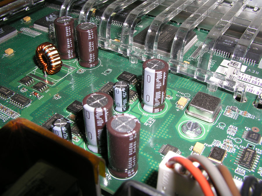

        one of the reasons i wanted to pull the mailserver was to see how these TAICON caps were going. they look ok.

            I have an intel server board for dual tualatin-s CPU's that is full of taicon caps. it's been running non stop over a year, solid as a rock running Fedora Linux with the taicons, so I can't complain. The board was used when I got it, so I don't know how long it ran before I got it, but it's had a hard life here, running all the time. How's yours holding up? How long running? I hope I dont need to recap mine, its FULL of caps!
                      its good to know you had good experience with the taicons so far. i thought you sold that intel server board to kc8? i have no idea how long that board was running, it used to be a workstation for a while before it had bad elixir ram and was recalled and ended up where it is now. as a mailserver it has been running for over a year 24/7 no probs except i went through about 3 new hdds before i got that fortron and sorted out the cooling.

                          I've seen a 1995 monitor full of Taicons and they were OK.

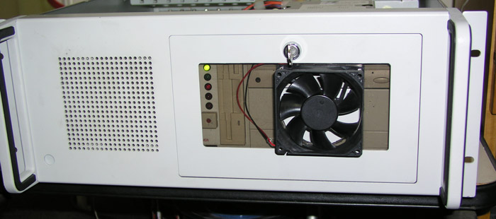

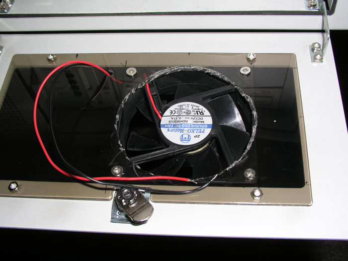

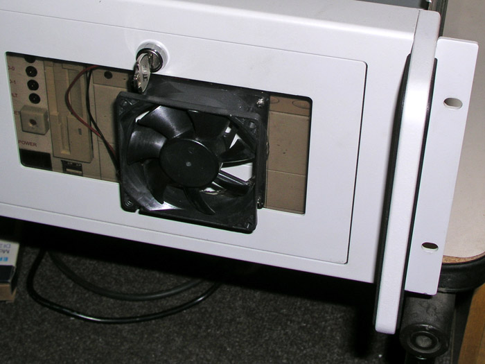

                              here is the fan mod for the 4U. you can see the air vents on the case, behind that are 2 powerful adda fans but they do nothing for the hdds which are on the right side of the case.
                              God bless my shitty dremeling
                              so basically behind the fan you have 2x5.25 bays available below the cdrom, so you install 2 hdds in those locations and remove the bay covers (photo doesnt show them removed) then it blows air over the hdds and to the psu.
