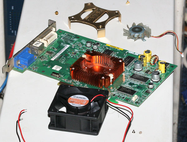

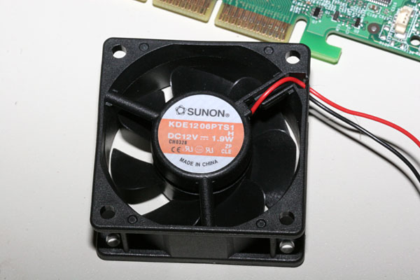

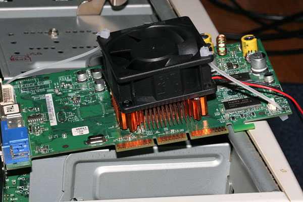

    I didnt find a cooler yet so i will order it. in the meantime this fan is driving me nuts so i fixed it with what i had lying around.
      Re: HSF Cooler Master Vortex Dream ACC-U72
      it looks like it is not flat on the heatsink but it is. actually it is necessary to be very careful with the tension of the cable ties because you can tilt the heatsink off the gpu, it is only attached with 2 spring pegs. so the configuaration as you see was the best compromise. thats a 60mm fan with one screw attached to the heatsink, a 50mm might fit perfectly with all 4 screws.

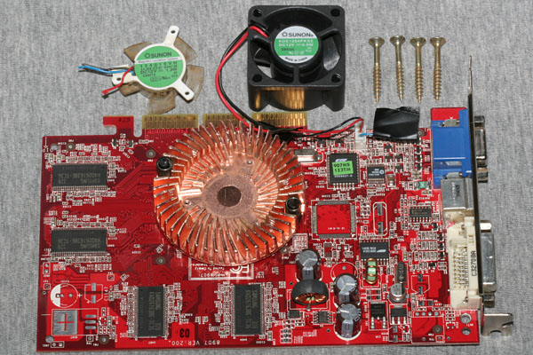

        some more video card cooling. this one was quite funny because i shut down one of my folding boxes to put a 42 ohm resistor on the psu fan wire. it wasnt making any offensive noise just giving the fan 12v all the time so a bit too much air sound. of course when i started it up the graphics card fan gave out (murphy's law) and started making a terrible sound.

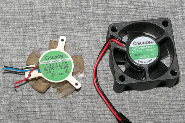

        so i needed a cheap but reliable fan replacement for an msi fx5200-tdr128
        the stock fan on the left is a sunon 12vdc 1.3w 124010vh 5.9cfm 33dBA. I found a KDE1204PKS2 which i recognise from 1u rack switches etc. It is 40x20cm 0.9w 12vdc 7.7CFM and quiet 21dBA.

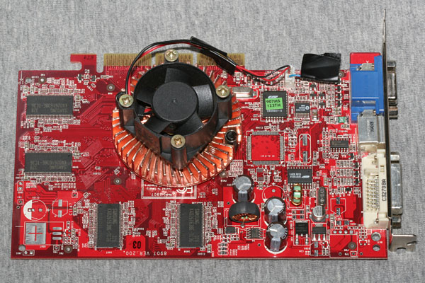

        so here is all the stuff, the fans, some wood screws and the card.
        assembled. seems to work fine.

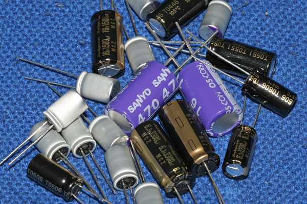

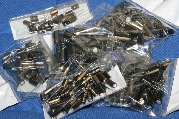

          caps.....i love them
          might be some recapping soon?

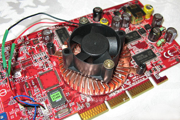

            msi fx5600 done with the same type of sunon fan as above. these are fine, cheap and reliable.

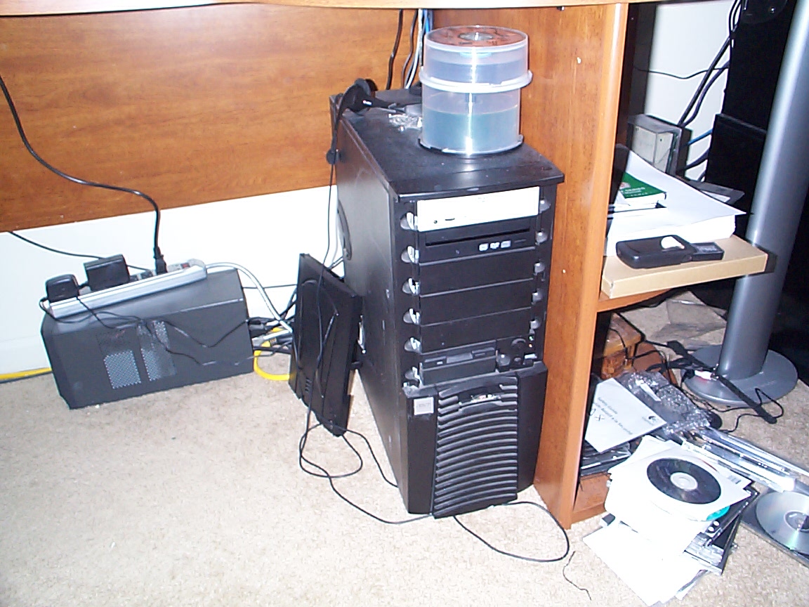

              Originally posted by willawake
              and then i get an excuse to do setup pictures with the new hsf/psu/ram.
              hey Will...I have one of those in black. I love that case. Where can I get two more???? <hint hint hint>

                this is the case that houses my P4.
                i'd like to get two more. i just can't remember where i got it or the manufacturer.
                  By the front panel, it looks similar to my Ultra Aluminus. It is a really nice case. One of endless Chenming-built, good-quality clones.

                    well antec used to have them but looks like no more. chieftec still supplies them.
                    chieftec dragon
                    http://www.chieftecusa.com/dragon.htm
                    there is a few available here
                    http://www.xoxide.com/chieftec.html
                    http://www.atxcases.com/atx-cases.asp
                    although they are rock solid cases, i would buy something else because dual 120mm fans is the way to go for nice cooling and quiet. and those are all 80mm i believe
