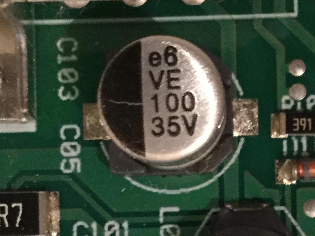

    Need to get specs for this electrolytic cap please
    I would be very grateful if the make of this 100uf 35V smd cap in the photo can be identified. It is used in dc-dc converter on a 15 years instrument board that is fairly used. I would ideally like to find its specs in order to replace it with a similar one, that has similar ripple current, ESR, etc.

    It looks like a Lelon VE series part.

      Re: Need to get specs for this electrolytic cap please
      Thats great! Many thanks for your help redwire!
      I couldn't find the ESR value in the specs so I calculated it from the given Tanδ value, which came to be 1.59 Ω. That calculation is done at 120Hz however that cap is working as an input filter for dc-dc converter running at 1Mhz so its ESR would be much less...
      I guess it would be okay to replace it with a new cap of a much lower ESR value?
        This isn't a low ESR capacitor, do I don't think you need to replace it with one, but I would recommend replacing it with a higher-hour or higher temp. capacitor.
          Lelon's VE series is rated for 85C, which means it's a general purpose type, not low impedance. So a GP 105C part from a good manufacturer would be a good improvement.
