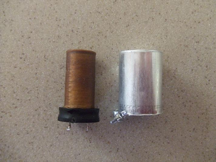

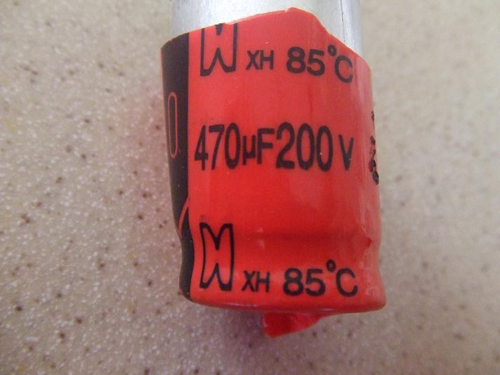

    From a leadman lp-8860. Don't know who made this. Internals take up about 1/2 of the actual can. Maybe 220uf in a 470uf can.
    Quality never looked better. Can was very easy to puncture, even with just the dull knife I used to make a incision in the label to peel it off.
