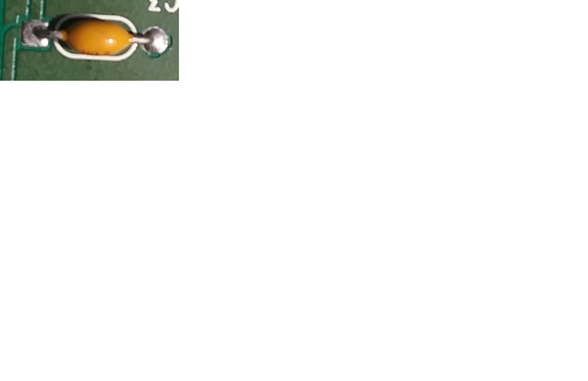

What type of capacitor is this?
  • cook
    Quiet observer
    • May 2010
    • 100
    What type of capacitor is this? It is in the board of a UPS system.
    Re: What type of capacitor is this?
    MLCC: Muliti Layer Ceramic Capacitor.
    Failure mode is short circuit or very low Ohms.
    What is printed on the body? more likely be around 0.1 uF used as bypass cap.
      I searched and searched for a picture that matched it but I could not find one. Thanks so much.
        I will try to see what is printed on the side and post it.
