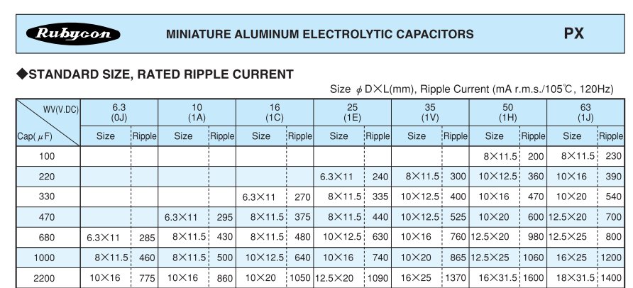

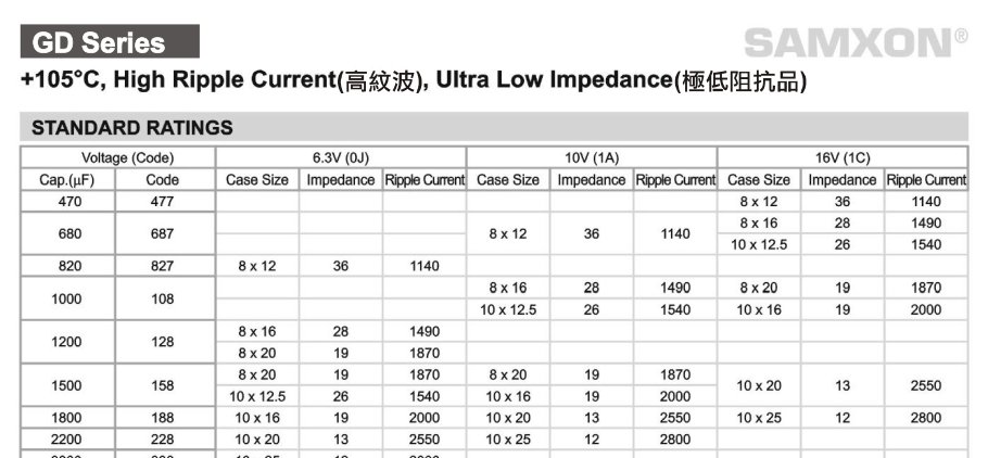

            I have a doubt: Rubycon PX are suitable for MOBO?
            As I didn't know this serie I searched the datasheet and what I can understand is that they are general purpose rated at 105ºC.
            From datasheet:
            Samxon GD 2200uF 10V 10X25 ESR 12mOhm Ripple current 2800mA
            Rubycon PX 2200uF 10V 10X16 ESR ? Ripple current 860mA
            I compared the 10V because I don't see Samxon @ 16V.
            Am I missing something?

              Re: YACQ - Yet Another Capacitor Question
              GD on BigPope's site: 2200 uF, 16v, 10x25 mm, 0.012 Ω, 2800 mA, 105 °C
              On the PX, I was under the impression that TC had them listed for mobo use. Perhaps I am wrong.
              I looked at the OST RLP series, which does not list a 10mm, 16v, 2200uF cap, only in 12.5mm. Special order or NLA perhaps? Either way, a 10x20 RLP series cap shows .041Ω & 1220ma.
              Perhaps use 2 Panny FM's 16v @ 3300uF here? You'd get the same capacitance and less than 1/2 the ESR of the 3 OST's. i.e.- 3 OST RLP = .013Ω / 2 PAN FM = .006Ω.
