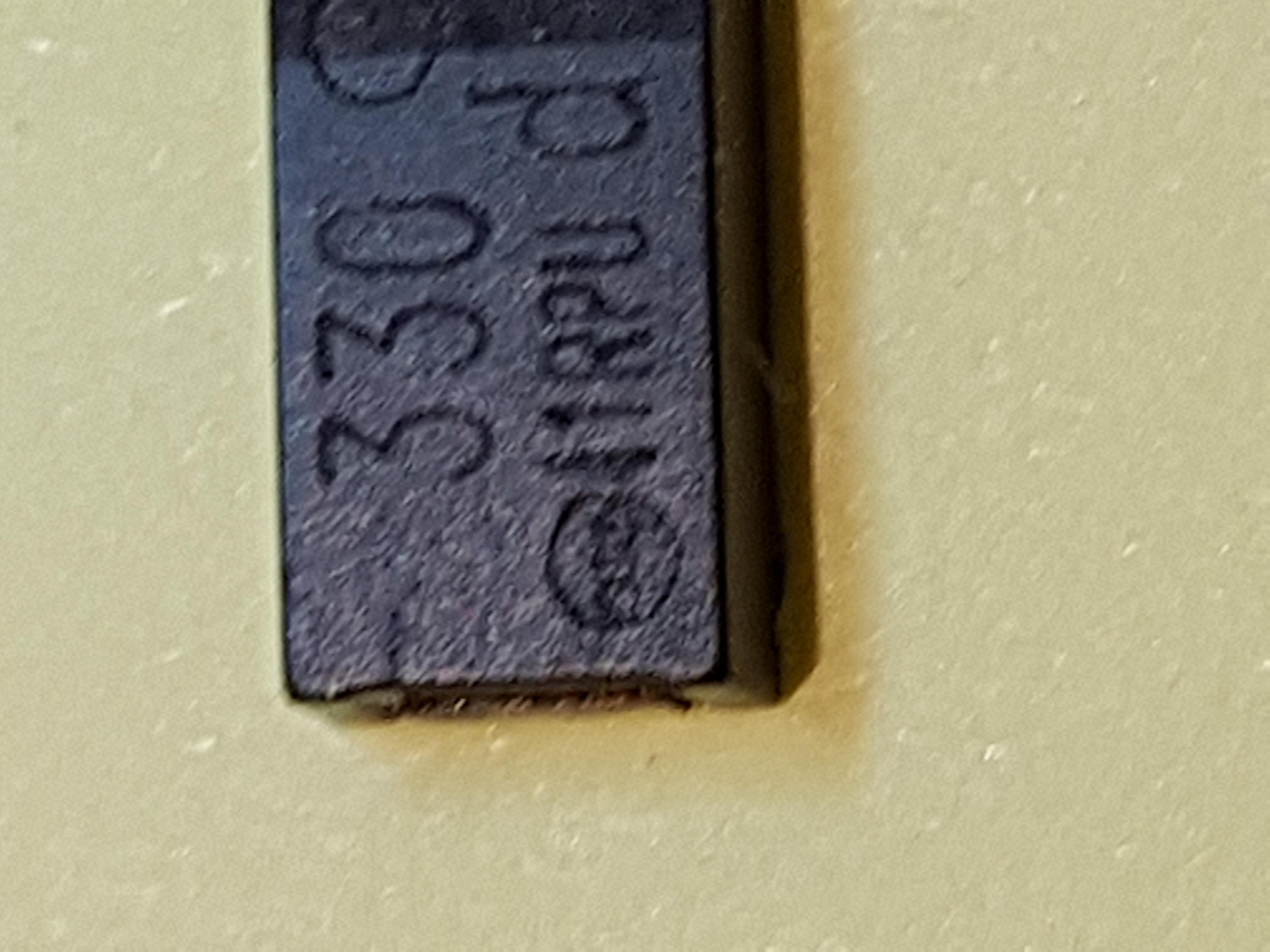

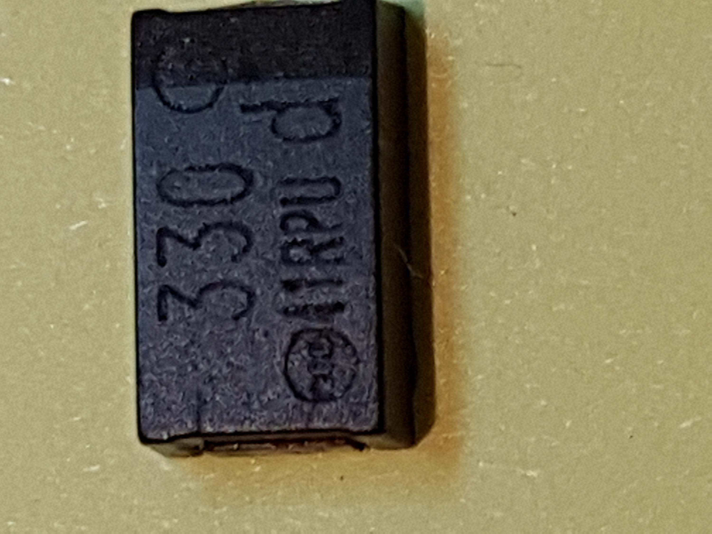

    Could anyone possibly tell me the part number ID and where I can buy SMD Caps C330u2 taken from a laptop motherboard, that are in the pics below...

    im not sure what voltage those are but maybe these?
    https://www.ebay.co.uk/itm/4x-SMD-Ta....c100005.m1851

      This looks like them, Voltage rating `D' = 2 volts
