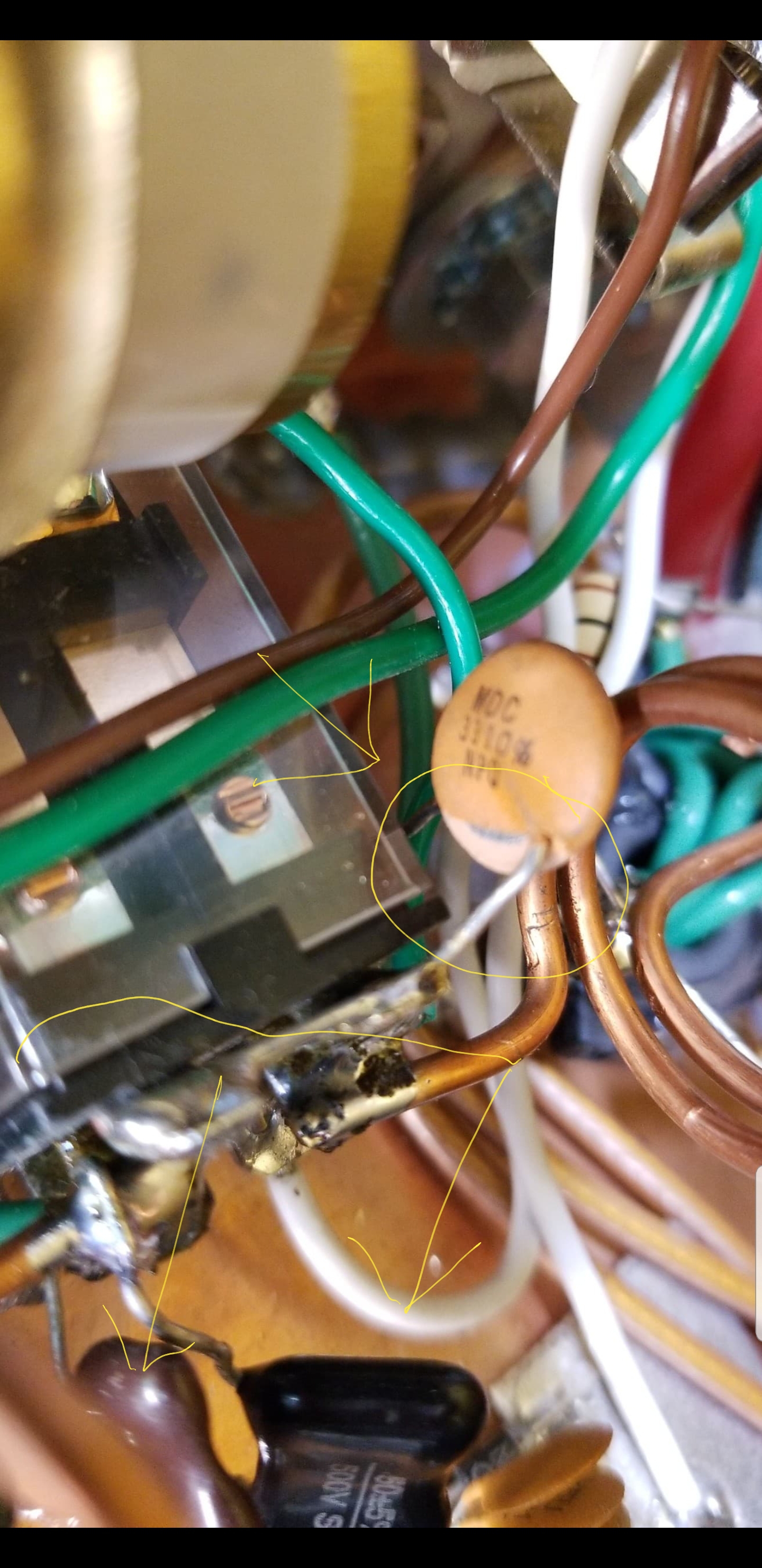

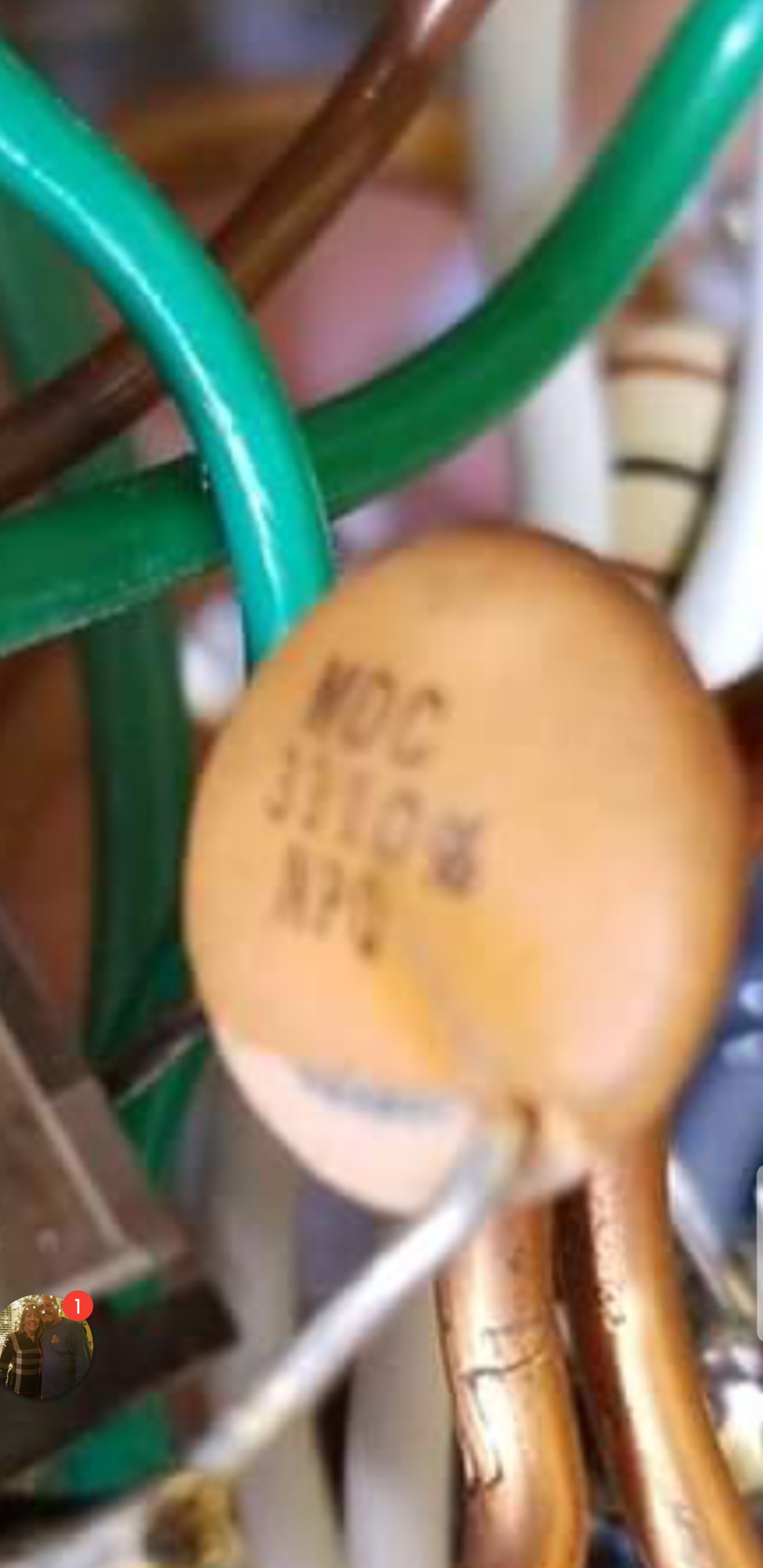

          Anyone help so I can replace this capistor. It says mdc 3310% npo.
          Someone sent me a 33j 1kv npo and said I could use it..
