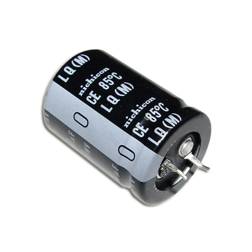

            Originally posted by KoroKoro
            I thought [M] was Matsushita Panasonic ?
            Yes, Matsushita Panasonic uses an "M" for their logo. However:
            and
            I could probably find examples from other brands very easily, but that should suffice to illustrate what I said above.
