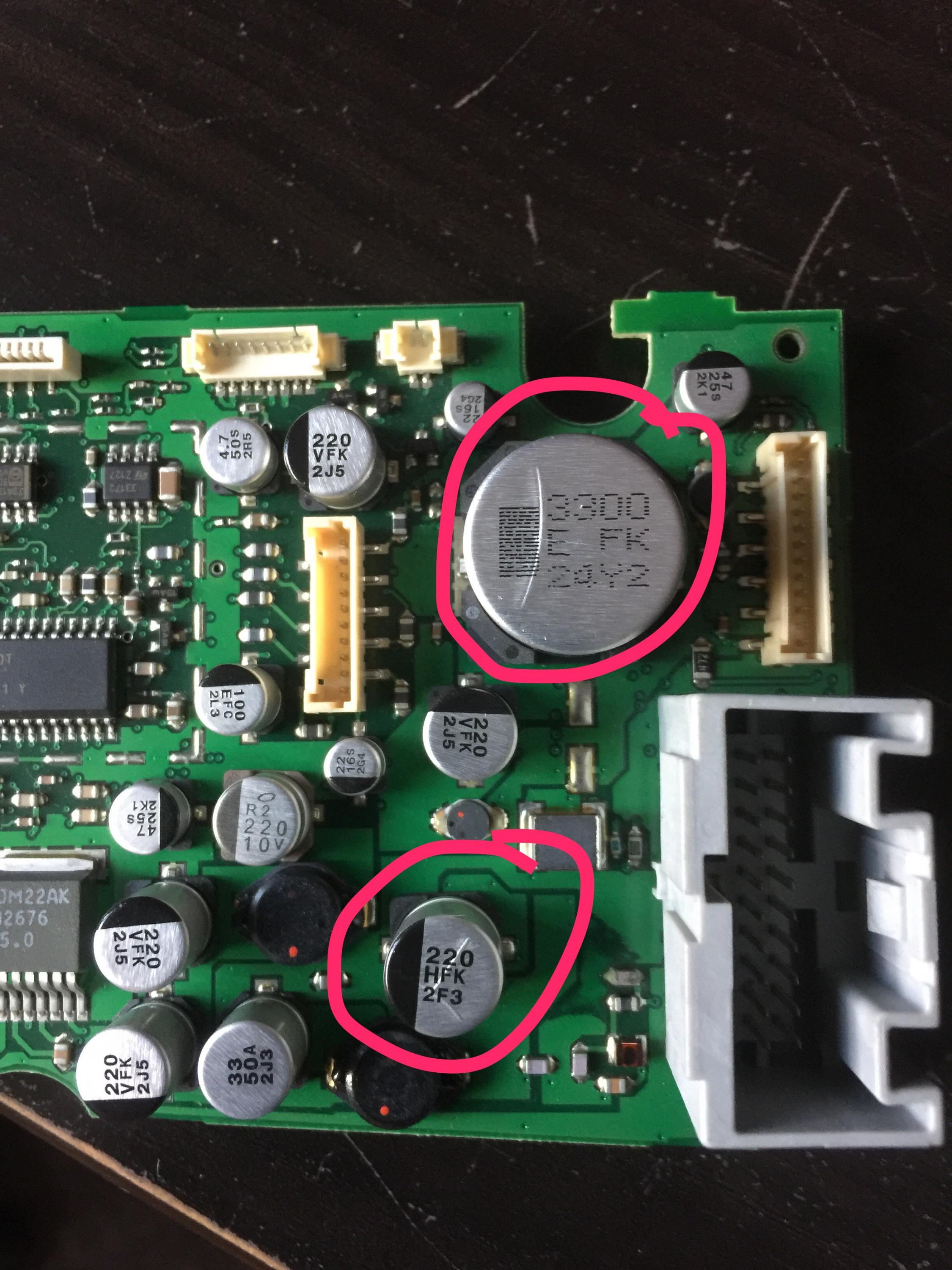

    Hey all.
    Please can someone identify the 2 caps in the photo please.
    I'd like to replace them.
    Cheers

    Re: Identify caps
    Most likely Panasonic FK series , electrolytic : https://cdn.badcaps-static.com/pdfs/...d128d0784a.pdf
    the number at top is capacitance , 3300uF and 220uF
    Digit to the left of FK is the voltage rating (it's in datasheet, first page, bottom left)
    6.3 j
    10 A
    16 C
    25 E
    35 V
    50 H
    63 J
    80 K
    100 2A
    So 3300 / 25v and 220uF 50v ...

      Re: Identify caps
      Thanks very much !!
      I guessed the capacitance just wasn't sure about the voltage.
