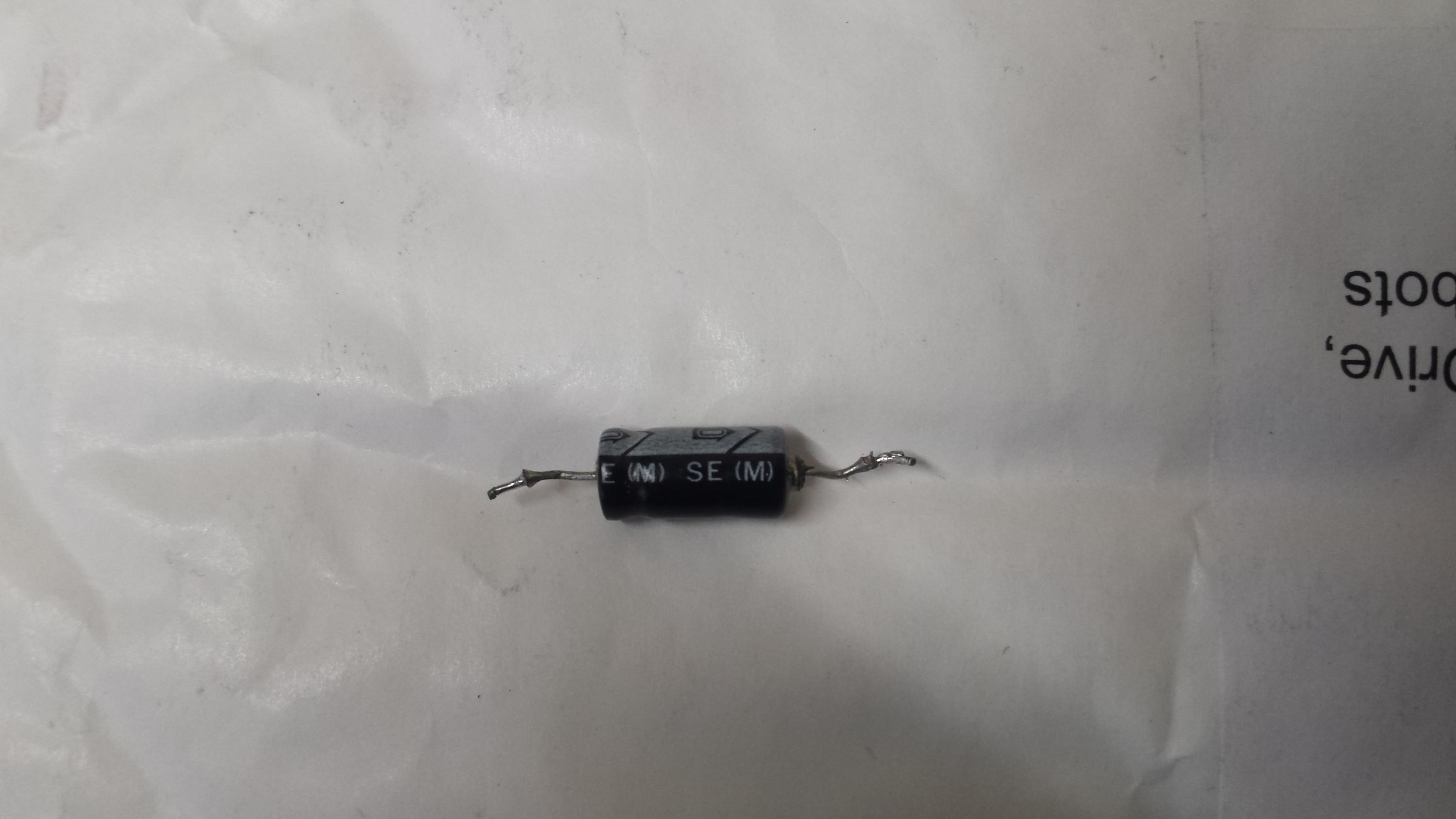

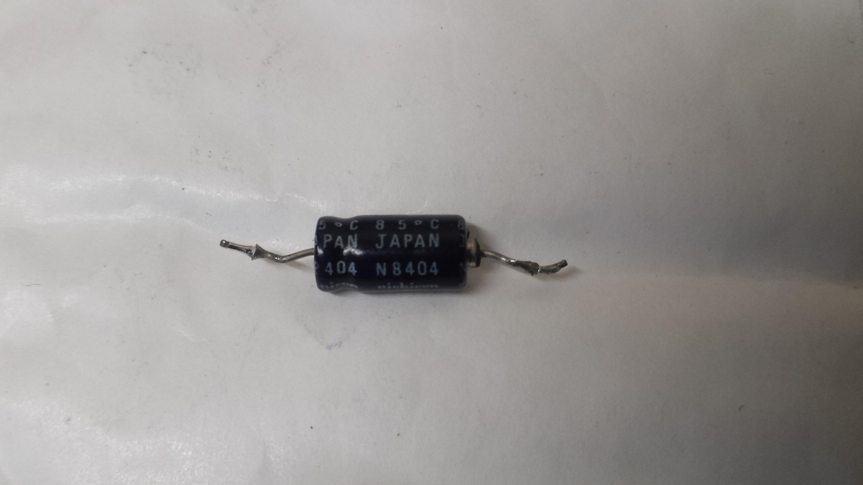

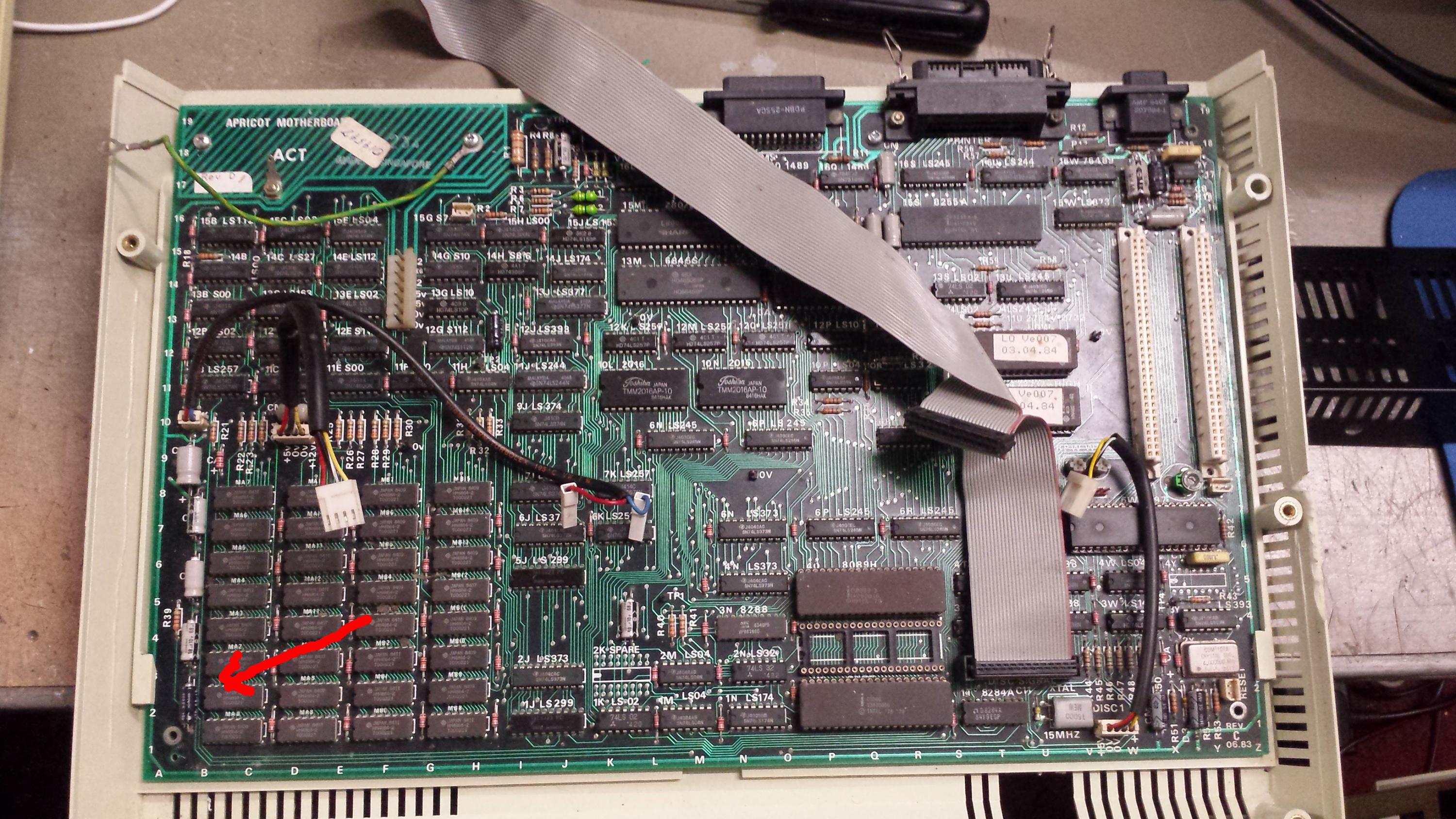

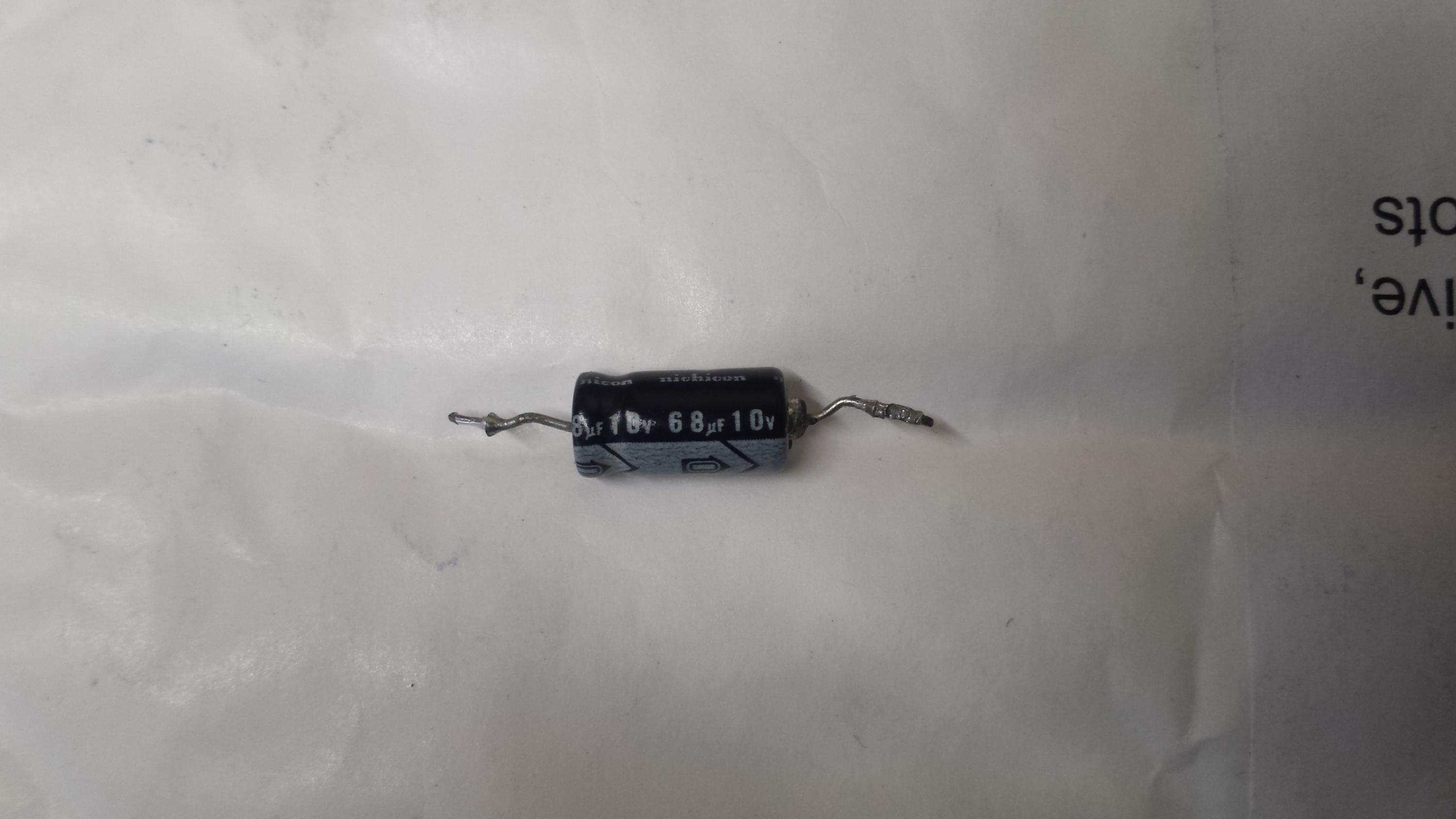

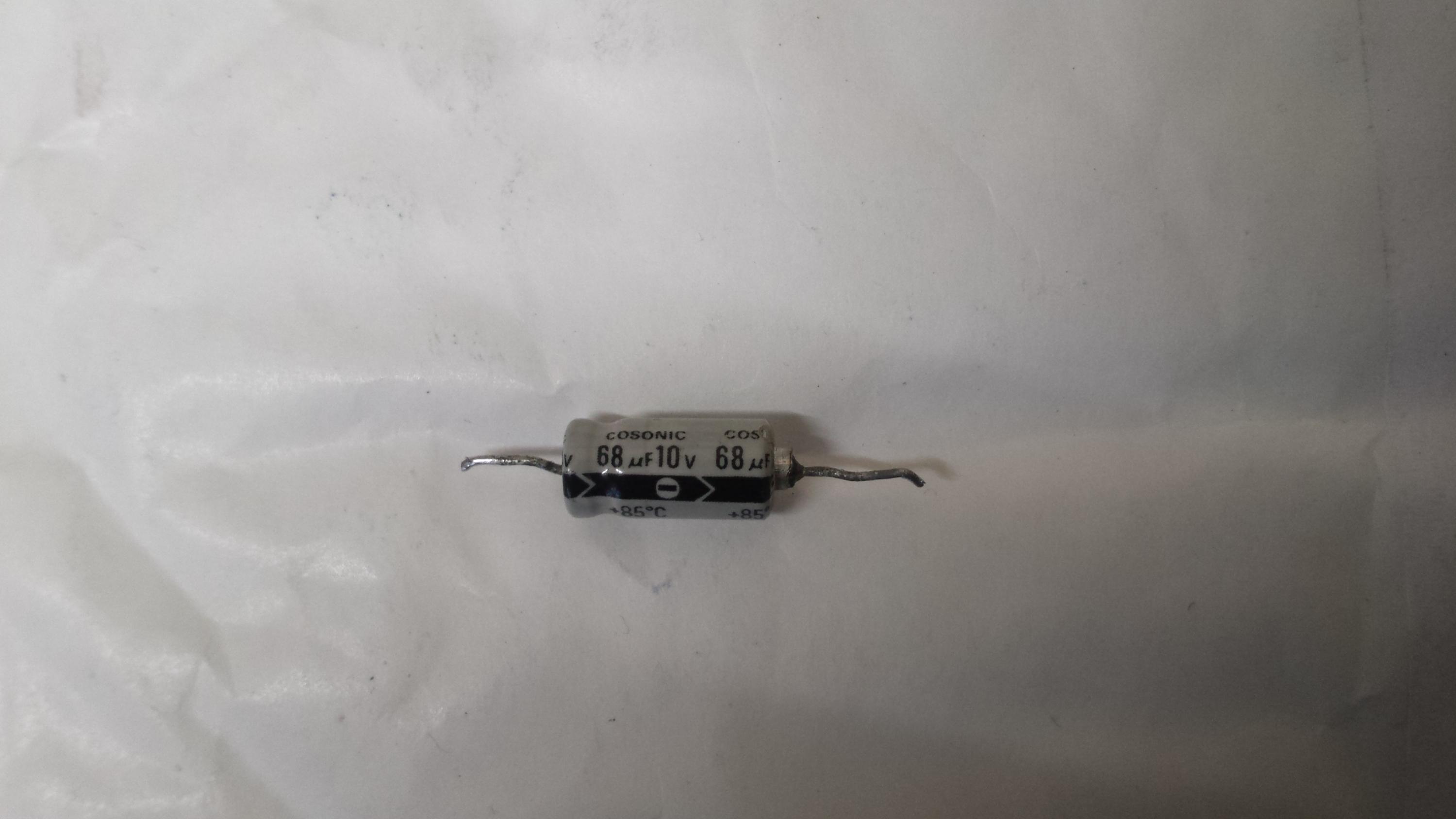

Can anyone tell me if there is anything special about the Dark blue Nichicon capacitor here because I have 2 apricot motherboards and all the 68uf 10v caps are light grey items and made by Cosonic except that is for one single 68uf 10v cap made by nichon. This single Nichicon cap is the exact same cap number on both boards which means this must be something special needed for that part of the circuit I presume, but just what's so special that it needs this certain cap. .See attached pictures of the two caps.
Cap diffrence
Re: Cap diffrence
Also, axial caps aren't exactly low impedance. The longer leads increase the ESL of the parts. I think I have seen non-polarized 'lytics with axial leads.
In this particular case, my guess is that the application was general purpose, and the axial parts had a lower height than radial parts when installed on the PCB.
More than 30 years of life is pretty decent for GP 'lytics.PeteS in CA
