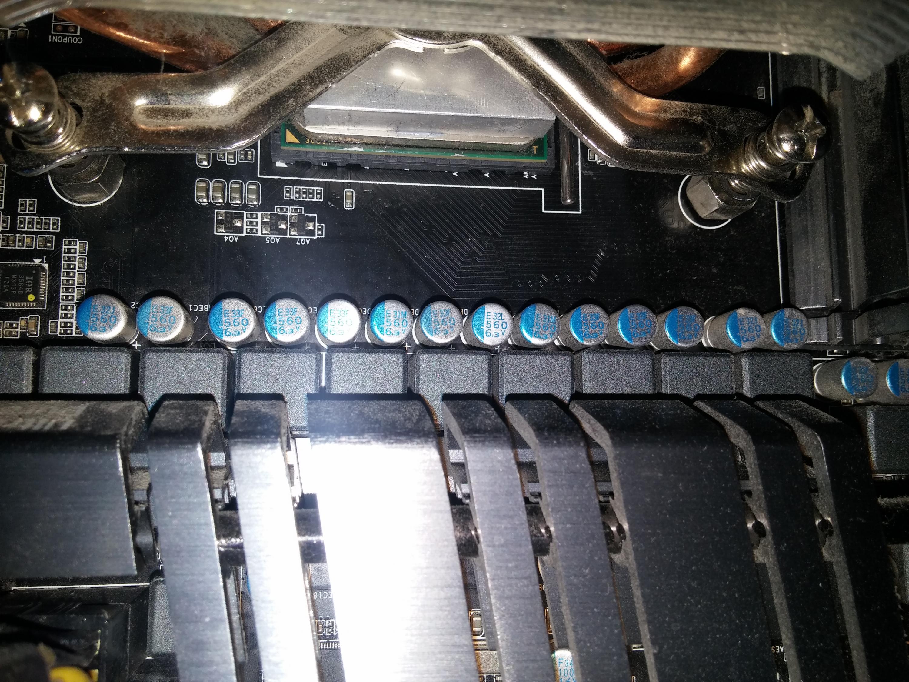

Today I opened up my main rig to change the thermal paste. I put some fresh new as5 and noticed that the caps on the vrm aren't japanese. All other caps on the mobo are ncc. Does anybody know what brand they are?
good or bad solid caps?
Re: good or bad solid caps?
that is quite likely a chemicon pse poly cap. i attached the datasheet for it. its the longer life and miniaturized version of the psc series. there is probably no chemicon logo on it because its too small with a diameter of only 6.3mm.
coincidentally, as i was replying to another post, i saw another member also has this same cap albeit with different datecodes/factory codes on his board and doing usb and expansion slot filtering work instead of vrm filtering. link to post. link to image.Attached FilesLast edited by ChaosLegionnaire; 09-20-2016, 09:23 PM.
