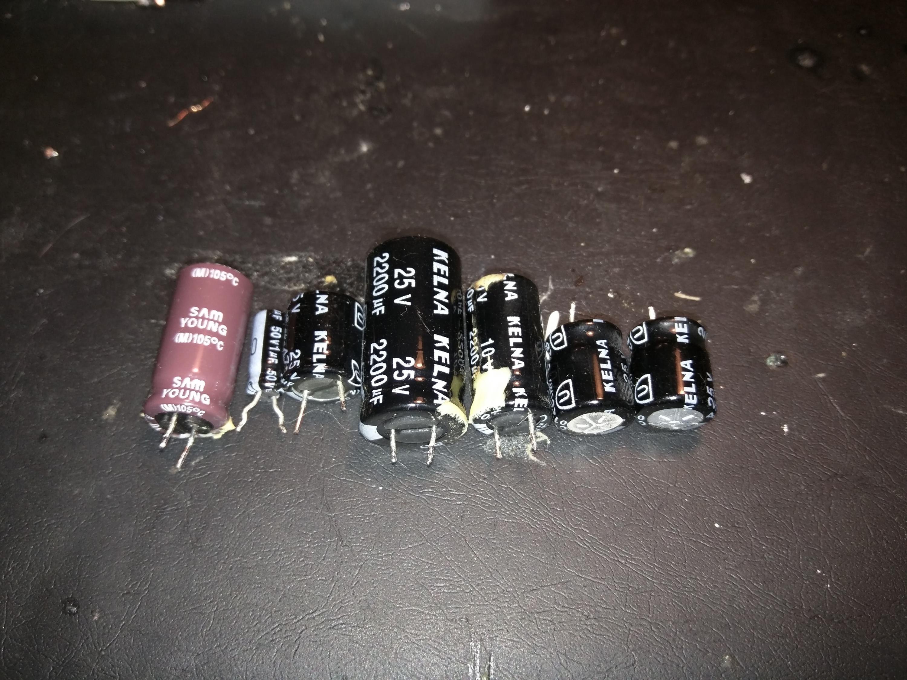

    KELNA caps?
    Are these supposed to be a knockoff of ELNA? Pulled 6 from a Sylvania 8 channel CCTV monitor that I picked up off the curb. The brown cap in the pic is a SamYoung KMG. The two Kelna caps on the right are visibly bulged, the remaining ones tested way off their values. Symptoms on the monitor was a severely delayed turn-on, and when it did turn on the vertical was jittery and smushed up on both ends.

    Re: KELNA caps?
    Those KELNAs are counterfeit Elnas, resleeved Teapos. Notice the Teapo style vents! Not surprised the others tested out of spec without outward symptoms, Teapo bear great notoriety for that.

      Re: KELNA caps?
      KELNA is to ELNA as Rulycon is to Rubycon .
      Now this should be on the list of vocabulary for the SATs.

        Re: KELNA caps?
        I would have thought they'd use ELMA or EINA as a counterfeit name...
