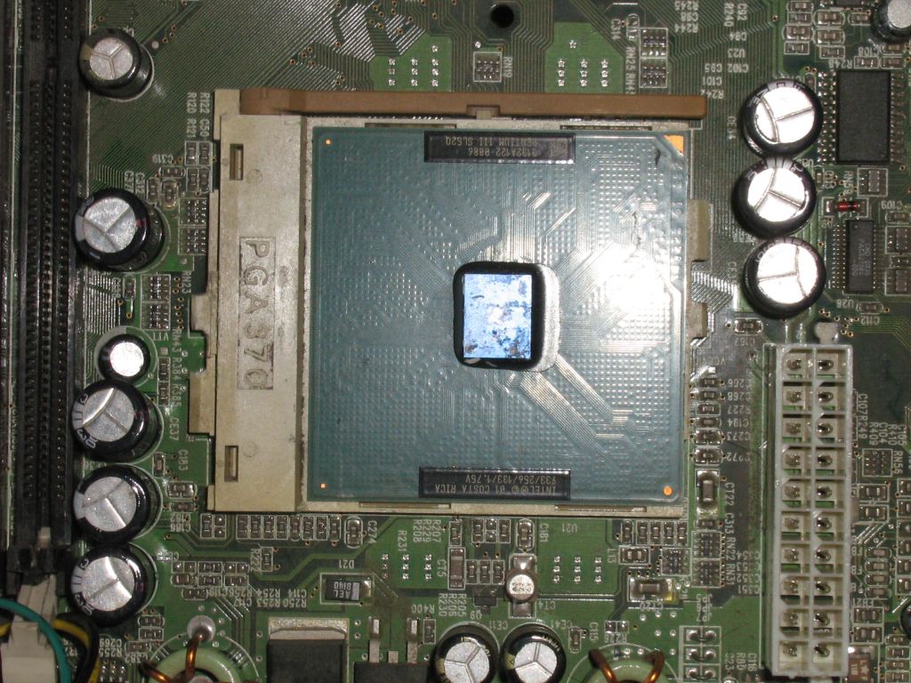

    Hello, I want to repair old Pentium 3 mobo(has isa port...) for some old school fun:
    Advance 10B QDI Motherboard http://www.motherboard.cz/mb/qdi/Advance%2010B.htm
    I can't see any bad things on caps, not leaking, not bulged. But mobo started to reboot, works unstable. So i'm thinking - caps are to blame.
    i want to change:
    1500uf6.3v 105°C, 7 caps, manufacturer - unknown. on side is written:
    105°CFF (what FF means?)
    1000uf 6.3v 105°C, 12 caps, manufacturer - licon. on side is written:
    ltm
    105°C(m)
    vent
    and some other really small, that, i think, don't need to be changed (less than 100uf)
    I have no idea what values of esr or ripple have those caps. Can't find any info. And overall have no experience about esr and ripple.
    At local shop there are panasonic caps(no other good ones):
    panasonic fr series(EEUFR1A102L) -1000uf 10v 105c ripple: 1240 impedance: 0.041
    panasonic fr series(EEUFR1A152L)-1500uf 10v 105c ripple: 560 impedance: 0.030
    Are those ok? (i want to make descent repair).
    If not, what caps you could recommend.
    What esr and ripple values?
    I will be ordering caps, if i need, from http://farnell.com/

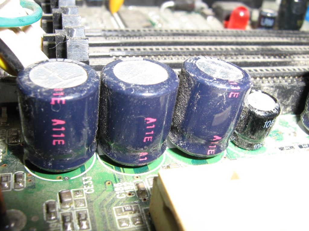

    All of the Licon/Fujicon caps need to be replaced, no matter how small they are.
    Can you post a picture of the unknown caps?

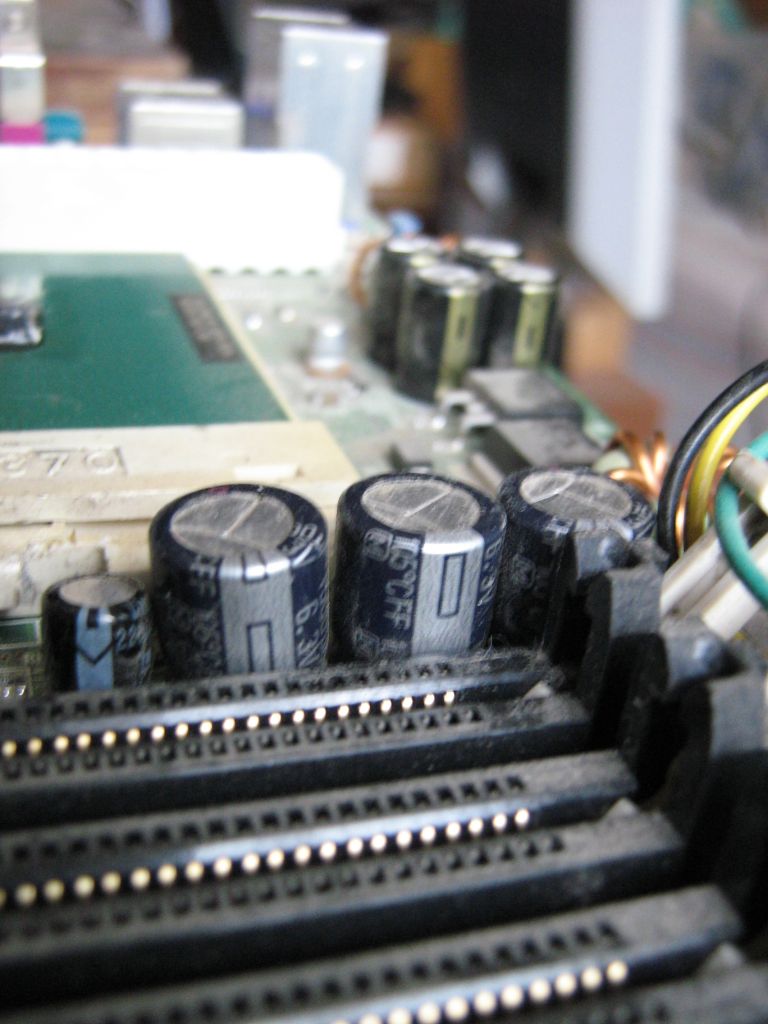

        @lti - photos of unknown caps

          Those are Panasonic FF series. If the case size is 10 x 20, the impedance is 0.023 and ripple current 1820 mA with 2000 hours lifetime.
            So those caps are pretty descent, and i don't really need to change them?
            As i said, there are no visual signs of caps going bad whatsoever. So i guess i will leave Panasonic ones intact, change all Licon ones, and see how mobo behaves.
            About small ones. This is question in general, not about this specific mobo(i will change all Licon caps as advised). In Badcaps.nem Repair Details is written:
            >> I mark and remove all the necessary capacitors *680uF and higher* @Badcaps.net - Repair Details _/ https://www.badcaps.net/pages.php?vid=11
            So how it is with those small caps? When i *don't need* to change them? Is Licon/Fujicon so bad? If those where high grade caps like panasonic, rubycon, Nichicon etc., i guess, there would be no need to change them(the same for big ones). But if caps where not worst, but let say average ones, would i still need to change small ones?
              Yesterday 01:31 PM
              Some people will recommend to change only 470 uF and above, others higher, and yet some people will tell you to change everything.
              Personally, I think it depends both on the motherboard and the caps.
              All I can say about Licon is: I have them on a Pentium II motherboard, and it still works, so I can't say that they are the worst. But that's the only experience I have with them. I usually change anything 330 uF and above, and may change a few 220 uF and 100 uF if I think that they are important (i.e. near a linear regulator). But in general, I don't bother with anything 100 uF and smaller.
