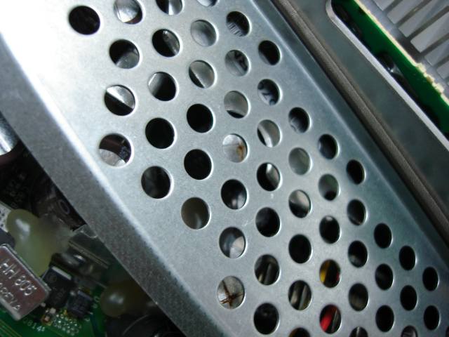

    Do I have bad caps?
    I think I've got bad capacitors. I've got an eMac 1ghz. In some of the capacitors on the logicboard there is white seepage coming out of the bottom of the capacitors...a lot, and in others there is a slight bulge at the top with a bit of brown residue. What I need is confirmation that the capacitors are in fact bad. Unfortunately, the ones that are slightly bulging with the brown residue were behind a metal screen so it was tough to get pictures but I did manage to get one that showed some of the brown residue.
    http://dynodealz.com/emac_capacitors/
  • Super Nade
    • Jun 2006
    • 294
    Re: Do I have bad caps?
    Bulging with residue = bad. You need to replace them.
      So the white seepage out of the bottom is normal then?
      • twistedbottlecap10
        • Aug 2006
        • 42
        The white residue looks like it is probably an adhesive caulk they intentionally applied to the caps/board to possibly keep them from being affected by vibrations. The bulging caps with the brown residue on top behind the screen are definitely bad.
        • serge4
          • Aug 2007
          • 3
          ok...i guess i will proceed accordingly and try to get this thing repaired for free. what fun.

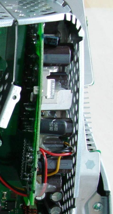

            The caps I can see clearly look ok and are I think the nippon chem ones
            (looks like vrm type circuit)
            The caps on the vertical pcb (most likely PSU) definitely look popped and need to be replaced.
            (use good quality low ESR types...see the FAQ)
            Make sure you check can sizes, cause it look like a tight squeeze in there.
            Replace with same values for Capacitance and Voltage
            Being an emac its probably going to be a pain to work on
            Thats the last pic you showed
            The white stuff for want of a better word is more or less clue and of no worries as far as the caps are concerned.
            Also BE VERY CAREFUL , there are dangerous voltages in there
            Not only the PSU but the CRT (tube, screen) circuits
            it does have the potential to kill you
              You are exactly right that the white material is adhesive... I just finished a complete redux of 9 capacitors on my eMac 1.25 GHZ motherboard... Did it myself with no prior experience. check out the pics here: http://picasaweb.google.com/gdegagne...torReplacement.
              I got the replacement capacitors from www.badcaps.net. I wanted to be sure that the replacement capacitors were good quality and not the same crappy ones that I was replacing.
