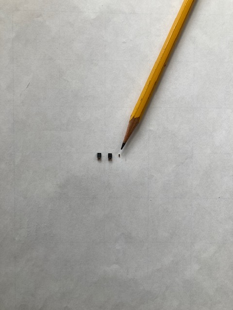

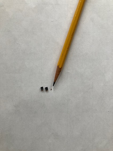

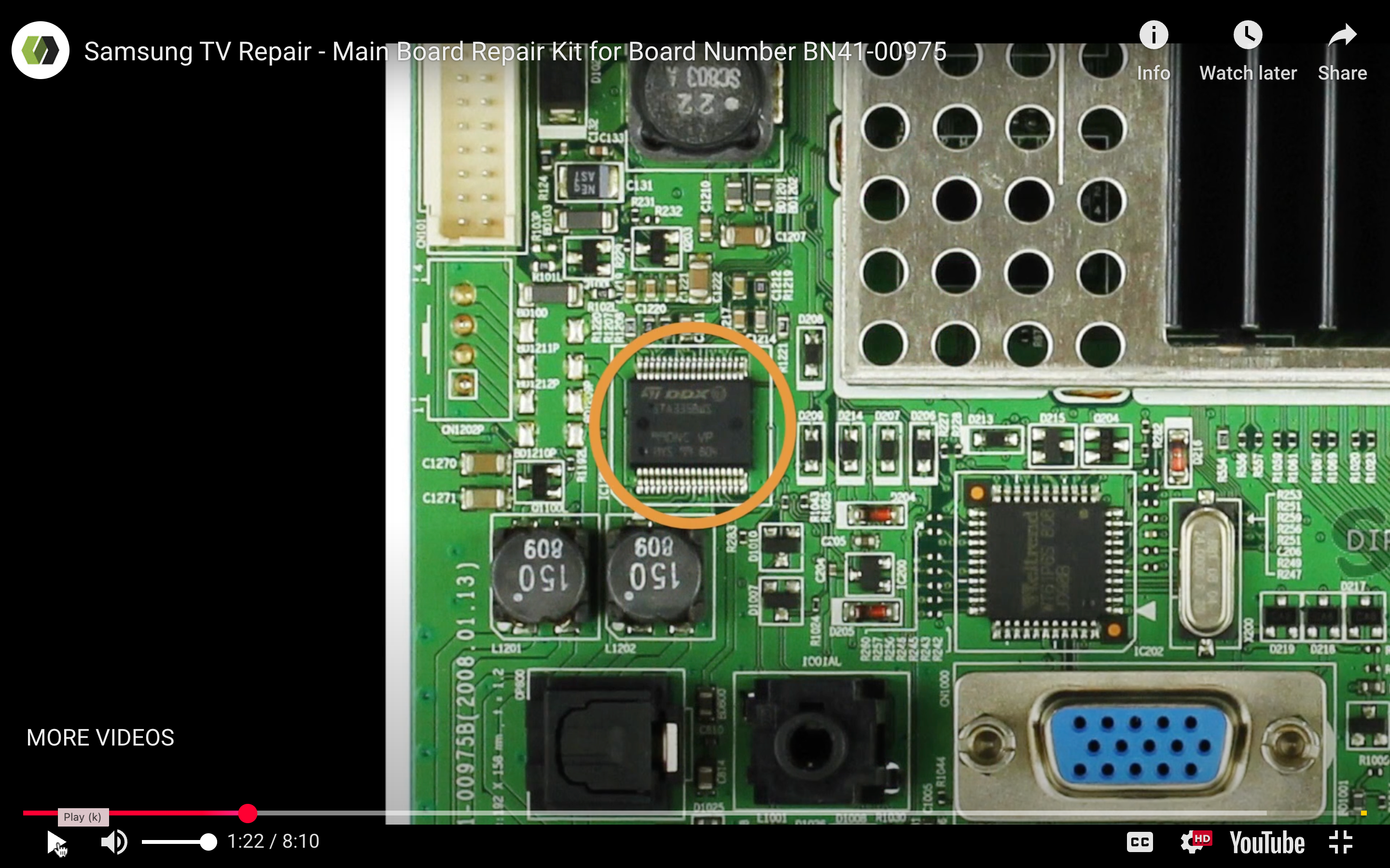

      Capacitor C133: I have no idea what size microfarads or ? this capacitor is.
      What does C133 do, and how important is it that I now replace it?
      3 pictures attached: See Picture 3 1st.
      Picture 3 - Samsung TV board with C131 that I replaced in upper left corner (NEu AS7). Directly above it is C133, the mystery capacitor. In the picture, C133 is silver with a brown stripe in the center.
      Pictures 1,2 - C102 and C131 (both NEu AS7), and C133 that was knocked off next to it. Just to get an idea of its size.

          I think someone else did the same thing. Knocked off c133 for some reason or other. Apparently the TV actually ran without it. As for what the ratings on that capacitor was: probably nothing much. Go to a junk board and stick a cap in it that fits if it makes you feel better. You can narrow the actual voltage and capacitance rating “range” down by measuring the length, width and height of the old SMT capacitor. Is that cap critical? Nope, probably a bypass cap. It's too small for anything else.
