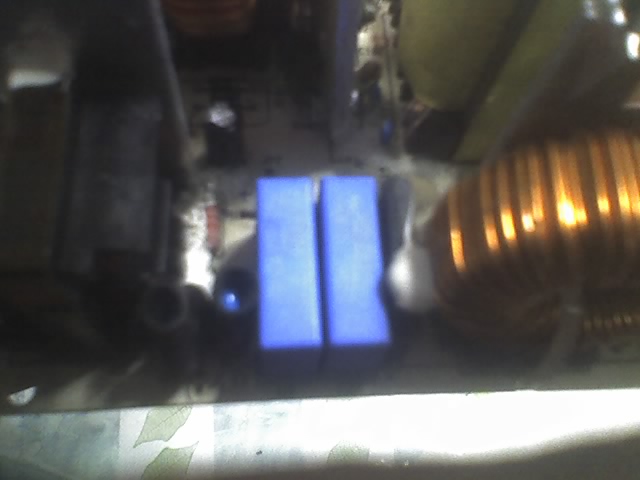

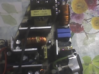

            GuyS,.. Here the PiC of the D500SF power Supply..... im thinking the sound tiking is the 2pin Relay (blue colour one) got two there .... and the bad news is the mobo not posting (of course changed Caps already) still not posting and no beeping ..... and some tiking sounds from PSU ....i suspect the PSU ...how bout ur guys ?? here some of the pic of the PSU

              well no idea really on that psu
              but they look like mains rated capacitors to me (x or y can never remember position)
              The ticking sound sounds to me like the psu is trying to start but can't fire up due to a fault
              what the exact faulty component might be I have not real idea
              Further.... since you have recapped check you have no shorts on psu rails this could be causing the PSU to shut its self down
              I take it this is your MB Here
              The three large ones are probably the on board Voltage Regulator (known as VRM)
              Input caps the 10 (I think you said) are the output filter caps these should be low ESR types
              the other two would probably be general purpose Electros
              The behavior first posted is typical of bad caps or a failing supply caps
              but its by no means the only cause
              I suspect a problem with your recap at this point, causing the psu to shutdown
              please recheck your solder work, cap placement and look for any solder Bridges
              or solder splatter on the pcb.
              A mag glass is very helpful here
              lastly what caps did you use were? Thanks
