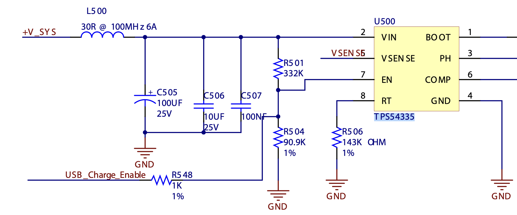

    Hi!
    I posted a thread about identifying caps of my Zoom 9000 guitar effect where I mentioned a JBL speaker I'm trying to help my friend with. I haven't gotten any answers to that thread but I have a question regarding the cap in the speaker, so I thought I'd ask it separately.
    The cap is marked 100uf 25V. I have found a set of caps on Amazon that I think will cover the caps of the guitar effekt but it doesn't have any 100uf 25V. It does have a 100uf 16V though. I'm pretty sure I read somewhere on this forum that 25V can sometimes be replaced with 16V...but I can't find that thread again.
    This is part of the schematic I have found of the speaker.
Name:	Skärmavbild 2025-01-15 kl. 17.34.08.png
    The cap I'm replacing is C505 on the left side. It has shorted and I'm guessing that that is what blew the U500 chip.
    The speaker uses a 19V charger...so I'm guessing a 16V cap is not preferred...but can it work? At least for a while? I don't know if the cap and chip is the only fault in the speaker so I'm trying to keep costs at a minimal until I know for sure.
    Cheers!

    • 31890
    +v-sys must be atleast 25% less than the cap rating ideally.
    so if v-sys is 12v you could get away with 16v caps, but for 19v even 25v caps are pushing it.

      Thank you for your reply!
      So what is +V_SYS? Is that the main power rail? I can see in the schematic that all caps after +V_SYS is rated 25V so I'm guessing that you are right. Bummer...then I have to order that one separately. I have no electronic component shop locally so I'll have to order it...with shipping costs several times the cost of the cap. 😂
        • 31890
        i'm assuming v-sys is your 19v psu input
        • Paxman_Swede
          • Jan 2025
          • 14
          • Sweden
          Yes...I think you are right. So I bit the bullet and ordered the cheapest alternative I could find on Amazon...about $10 bucks. Thank you for your input stj. 👍
