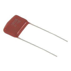

    Hi there sorry if this is a stupid question.but could someone tell me if i can replace the following caps.
    with these
    both are the same value 15n 630v but obviously look different.
    they are for a vestel 17pw20 v2 power supply.
    thank you.

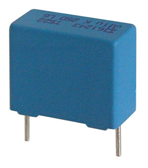

    If the blue ones aren't 'X' rated, then yes.
    Muh-soggy-knee
    • shaunbt123
      • Nov 2012
      • 119
      • uk
      Re: can i use these caps
      thanks for your reply.
      it says on the blue one ,15n j 630v 378
      mkp/mkp
      if it were x rated would it state this on the casing.
