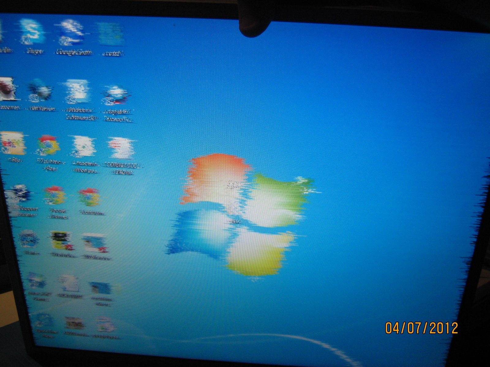

    VA902b Shakey jittery image

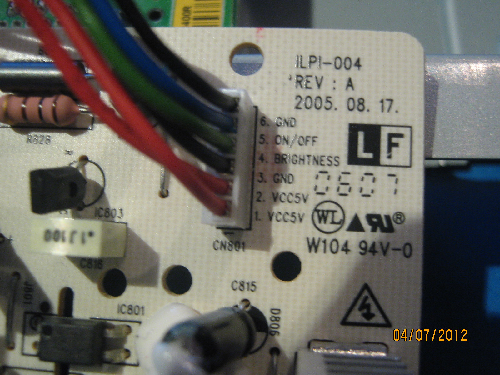

    Newbie here, I have a viewsonic VA902b monitor that powers on and shows video output, but the screen looks shakey, jittery, like electrical interference. I chacked all cords and connections and replaced cords, all without resolution. Is this possibly a bad capacitor problem?

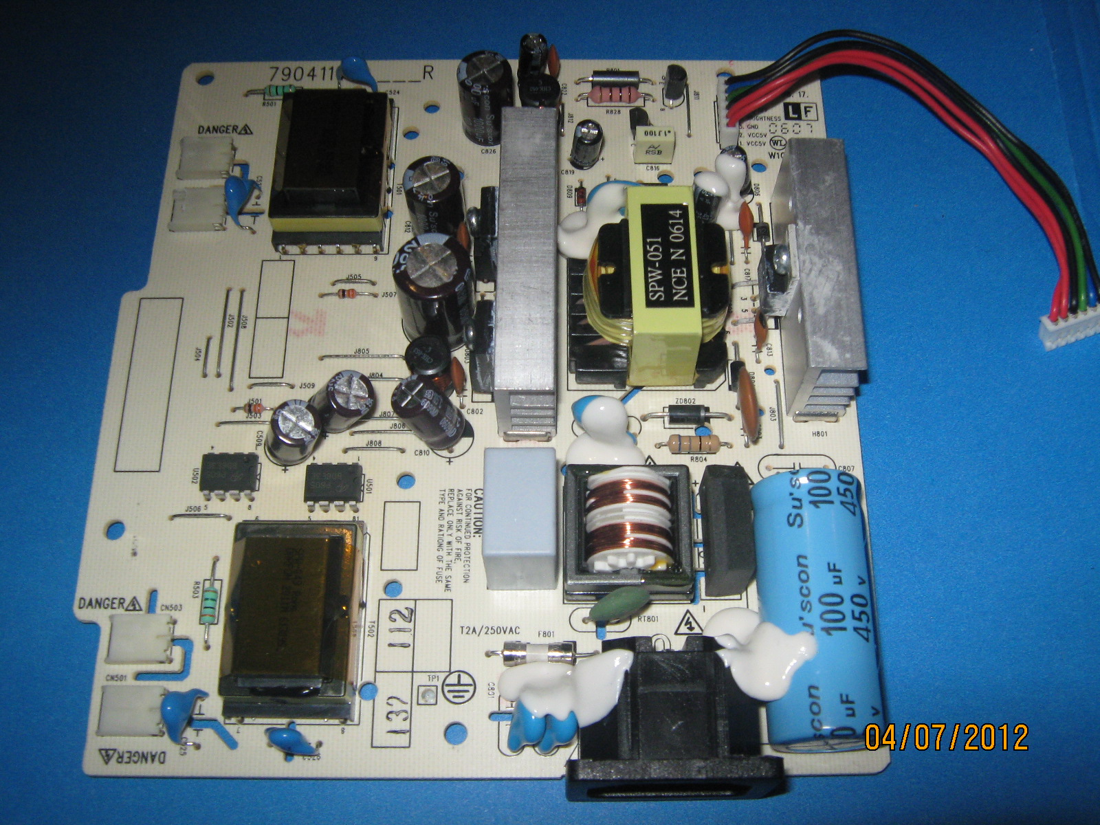

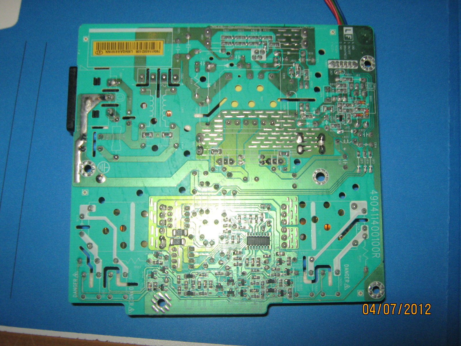

        Re: VA902b Shakey jittery image
        Hi - you have su'scon caps on the power board which is possibly the cause of unsteady voltages. Also on the back of the power board can you check the joints where the mains plug is - it just looks a bit odd in the picture - perhaps you can do a close up.
        I dont know if you have worked on open boards before but there are voltages in the region of 300-400 volts so you need to be careful.
        First can you measure the voltages at the connector at the top right in pic 2 and post your results. Then do it again with it all set up and working - take care that boards do not touch and you are working on a non conductive surface.
          Thanks. Total newbie here, wondering how to test with my multi-meter. Pins 1 & 2 are VCC5V. Do I touch the other end to GND pin 6? Also more pics attached.
            Yes - you can use 3 or 6 as ground
            Set meter on Volts DC - red (positive )probe on pin being tested Black (Negative) probe on gnd.
            Thanks for pics - mains pins look ok - trick of the light.
              Help can't find replacement cap for 100 uF 450V, anyone?
              • selldoor
                Slow Learner
                • Dec 2010
                • 7870
                Wouldnt worry about replacing if it doesnt look bulged or leaky the big ones are usually ok.
                If it becomes necessary we will come up with a suitable alternative.

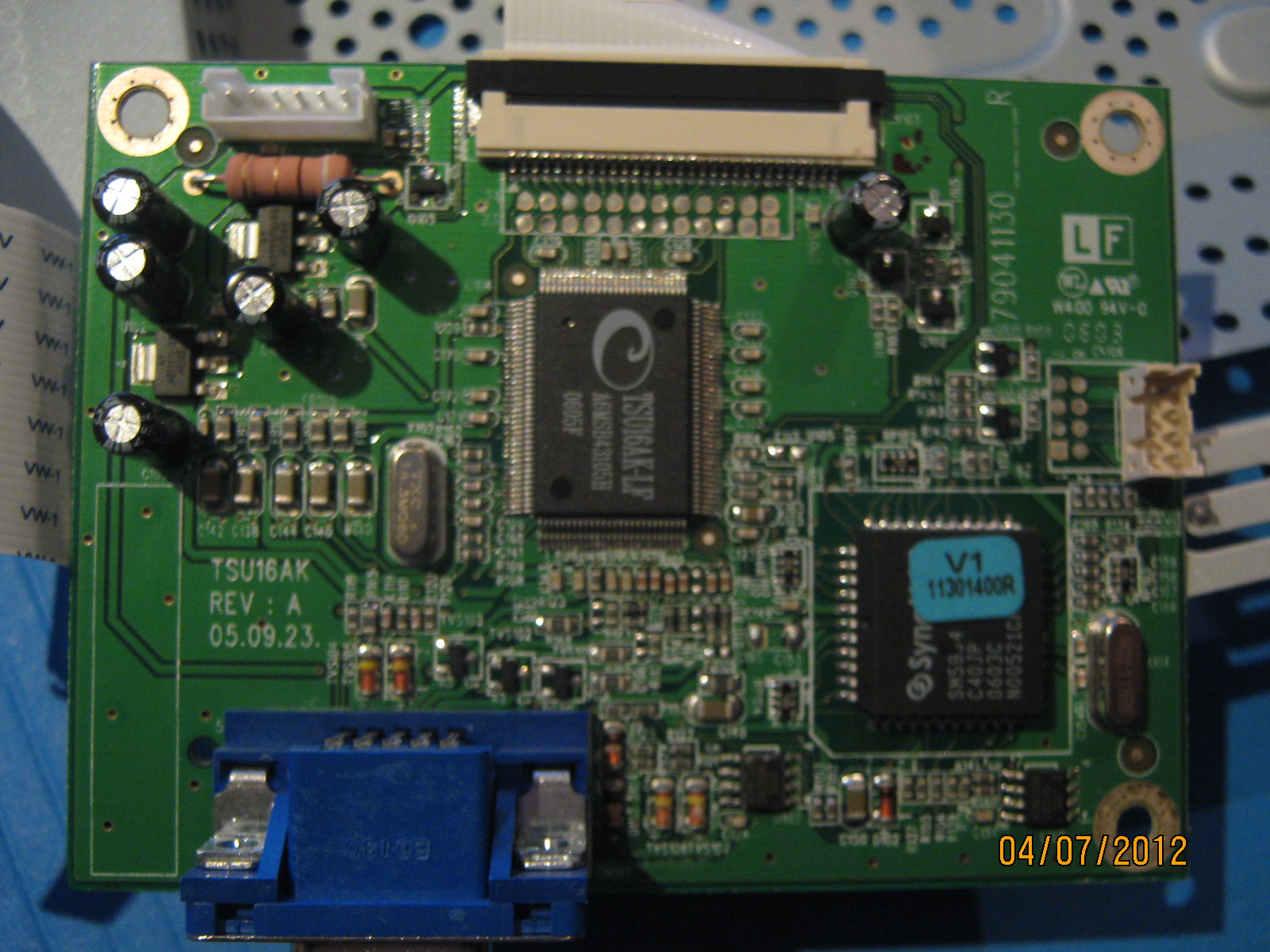

                          Circled in red are two voltage regulators.
                          1) Measure the DC voltage of bottom 3 pins (ignore the fat tab). Use a ground screw on the logic board for ground (black probe).
                          2) Report the part number and your measurements like
                          Part number = AL1117-33
                          pin 1 = 0.0
                          pin 2 = 3.3
                          pin 3 = 5.0
                          --- begin sig file ---
                            Do I need to connect this board to the power board and plug in AC to measure the DC here?
                            • retiredcaps
                              • Apr 2010
                              • 9271
                              Yes connect both boards. All voltage measurements require the lcd to be plugged in and powered on.
                                      Part number AL1117-33 (position of component is below, slightly left)
                                      pin 3 = 5.10
                                      pin 2 = 3.30
                                      pin 1 = 0.00
                                      Part number AS1117-18 (position of component is above)
                                      Pin 3 = 5.05
                                      pin 2 = 1.24
                                      pin 1 = 0.00
                                      power was on all connectors connected.
                                      • retiredcaps
                                        • Apr 2010
                                        • 9271
                                        Pin 3 = 5.05
                                        pin 2 = 1.24
                                        pin 1 = 0.00
                                        AS1117-18 is definitely bad and probably the cause of your shaky images.
                                        The fixed 1.8V regulator is a highly used part so it should be available at your local favourite electronics store. If you have old junk boards, you can look there and reuse the old one. I found one on my old sound card.
                                        Otherwise, order online, but ordering from digikey, mouser, etc is going to cost you $8 USD in just shipping/handling.
