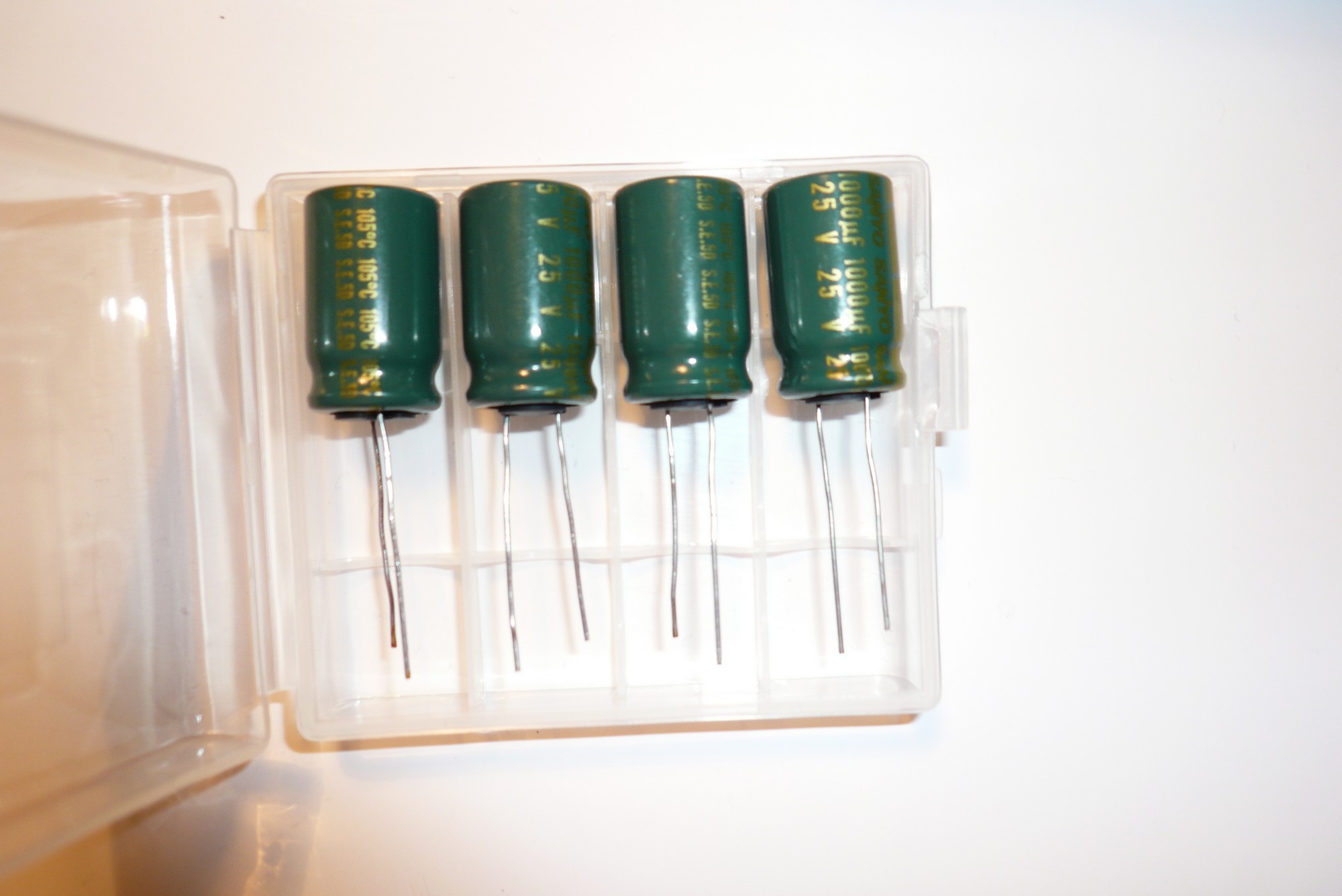

    Hi Badcaps users,
    I'm new and I've just discovered this forum ! I've read lots of topics, and discovered that even capacitors can be faked, and most of the eBay-sold caps are fake !
    Several days ago, I have received 5 Sanyo capacitors, bought at a (very) cheap on eBay...
    Even that I think these are surely fake, I would like your confirmation, and if it is recommanded to use them to replace SamXon dead caps into my old 19" 930BF samsung screen. Is there a risk of damaging my screen?

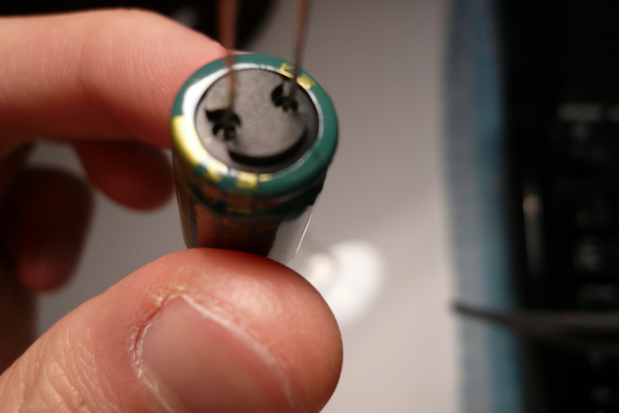

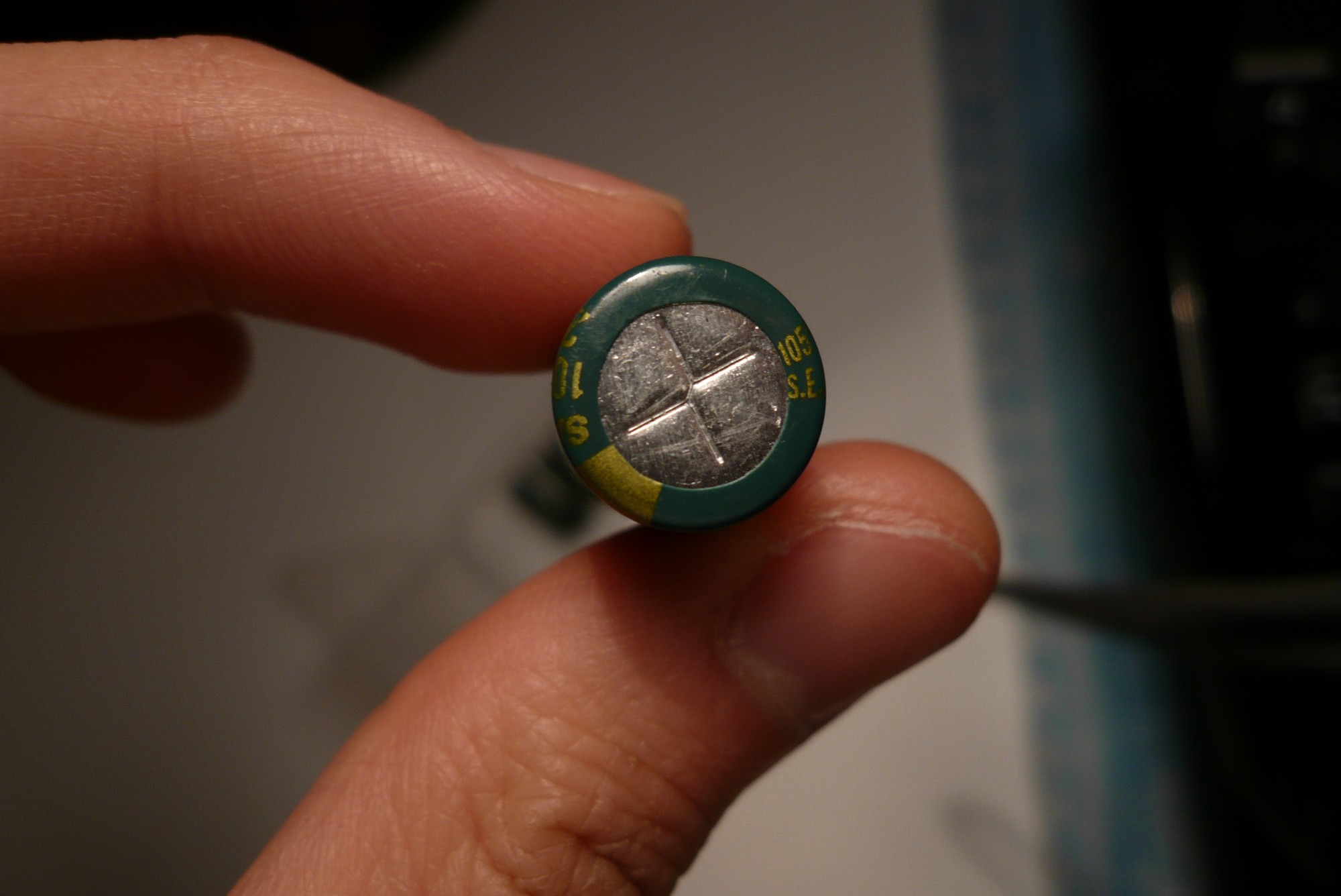

    I've tried to open one of them, to see if the Sanyo capacitor have an other capacitor inside, but cannot finally open it (the rubber is hard to "remove").
    Thank you !
    Attached to this post : 3 pictures of the caps.

    I have never seen that type of vent style before... It looks like the machine that stamps the + on the vent is out of alignment...
    The vent style for Sanyo is a type of "k". That is a fake... They're definately trying to hide it because they're trying to use more genuine-looking bunges.

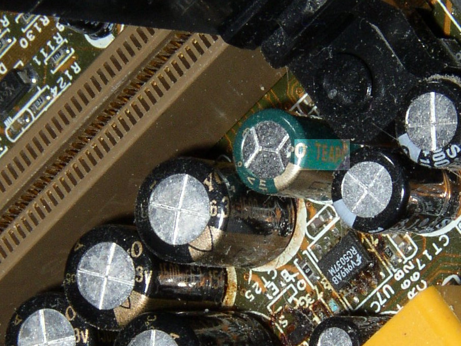

      I don't think it was an alignment issue for the top.
      The http://capacitor.web.fc2.com/ website shows lots of manufacturers using that top, among them Canicon and Choyo used that type of top for example... there's even a picture on Wikipedia showing Teapo with a similar top:
      http://en.wikipedia.org/wiki/File:Badcaps-choyo.jpg
      But yeah, they're probably not Sanyo.

        That's not the same type of vent (Though it is somewhat of a hybrid between the two)...
        That "Teapo" shown is not a Teapo, it's a Hermei... That's Hermei's vent style, found on many brands, all resleeved, but ultimately manufactured by Hermei.

          Interesting, I have seen sanyo caps with the 'K' vent and this type of vent too.
          I think the difference between the sanyo and hermei is that the single line in the middle, is much shorter on the sanyo caps.

            I've seen that vent on very old Sanyo caps. (P2 and P3 boards.)
            They were Sanyo WX Series and were also missing the series mark [as those are...]
            I think they are legit - but really old.
            Talking like 10+ years old probably.
            I'm talking about the one in Post#1 with the short center bar.
            The green one in Post#3 is a fake if it says Sanyo.

            • Scenic
              o.O
              • Sep 2007
              • 2642
              Re: Sanyo fake caps?
              Says Teapo.. you can clearly see it in the full-res pic after playing with the image a bit. Odd vent for a Teapo though. I've only ever seen those with the "mercedes with dots" style. Looks more like Hermei than anything else..
              As for the OP.. They look OK, but very old. What does the datecode say exactly? It's the line that starts with S.E. ....
              Also from what I've read, if there's no proper series marking (like for example "WG", which is missing on yours), they're (old?) WX series. Those probably won't be good enough for PSU use (?)

                Date code looks like Dec 1995.
                (I really don't think they used that vent in 2005.)

                      The ones on the photo are SE 5D.
                      The one I've tried to open was SE 64.
                      So, you said those are (seems to be) legit but very old!
                      Is it safe to use them into a 19' LCD screen that require preferably low ESR caps?
