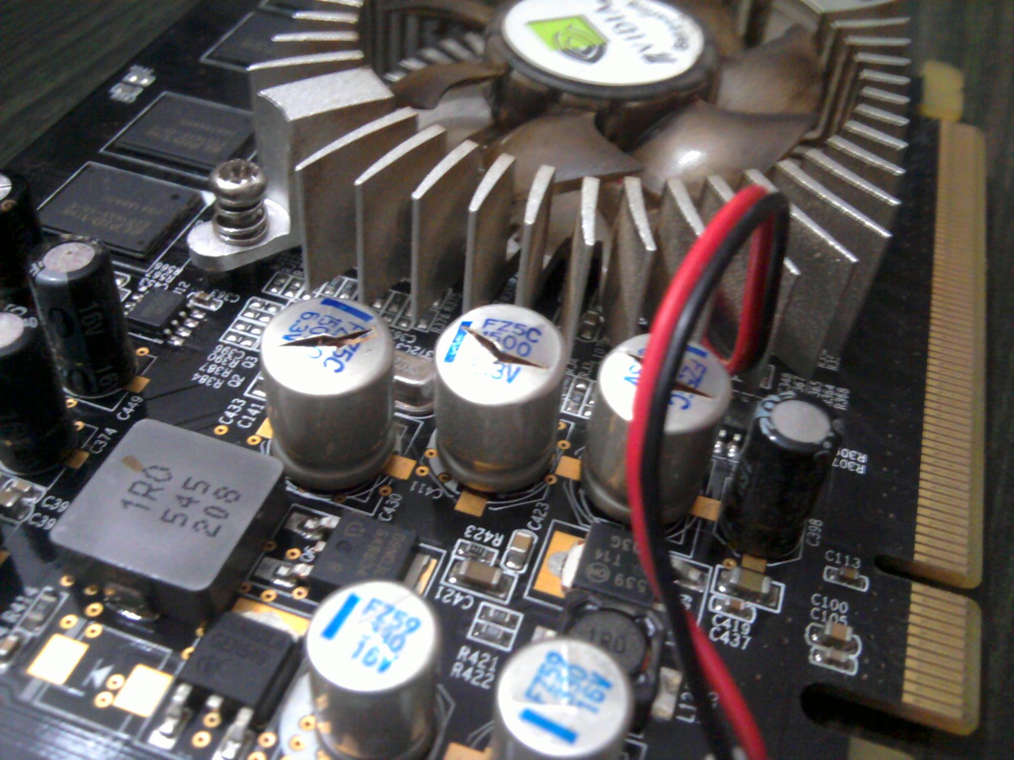

    I have GF 6600 and just figured out that 3 of my capacitors are very very damaged. (attachment)
    The Capacitor parameters are: FZ5C 1500 6.3V. does anybody know replacement for this? What does 1500 means? 1500 uF ?
    Regards

    Sacon FZ, known crap. Replace all with Rubycon MBZ at the least.
    Yes, your caps are 1500uF 6.3v. You'll also need two 330uF/16V caps for those other two Sacons. Replace every cap with "FZ" in it.

      Thanks for the info.. I'll replace those 5 caps.... It's funny how the card still works without nvidia drivers installed.. When I'll enable nvidia drivers everything go in hell...

        Be sure you use low ESR capacitors, such as Rubycon MBZ. General purpose caps (like the ones Radioshack sells) will not work.

          Panasonic FM/FR , Rubycon MBZ/ZL*, Nichicon HM/HN/HZ, UCC KZE ... all will work fine.
          The board worked fine with those Sacon going out of spec for months probably, so there's some room, no need to search for super ultra low esr like those MBZ capacitors.

              It's not a half assed job. The specifications of the capacitor series above are all within a few percent of those MBZ series capacitors.
              The MBZ series was discontinued in 2010 and according to the datasheet, the last large orders for this series were accepted in 2009.
              So, no matter where you'd order such capacitors, they're at least 2 years old and you have no guarantee they were stored in reasonable conditions, unless you happen to find them at some well known distributor.
              Further, precisely because people like you recommend them and praise them, there's a lot of fakes out there so if the person tries to get them off eBay, it's quite possible he's gonna get fake stuff.
              Here's for example a comparison between MBZ and ZLG:
              https://cdn.badcaps-static.com/pdfs/...3bb75aa682.pdf
              1500uF 6.3v ZLG : 10x20 2180mA 0.014 ohm
              1500uF 6.3v MBZ : 10x12.5 1540mA 0.026 ohm
              1500uF 6.3c ZLH : 8x20 1500mA 0.029 ohm
              and there are other series... so you have a slightly taller capacitors with better specs... or thinner and almost identical specs... and do you really think 2 year old capacitors will actually have those datasheet specs?
              And even more importantly, do you think the circuit is so finely tuned, it would care about 0.026 or 0.014 when the Sacon caps had 0.020 ohm or something like that in the datasheet and they were crap.
