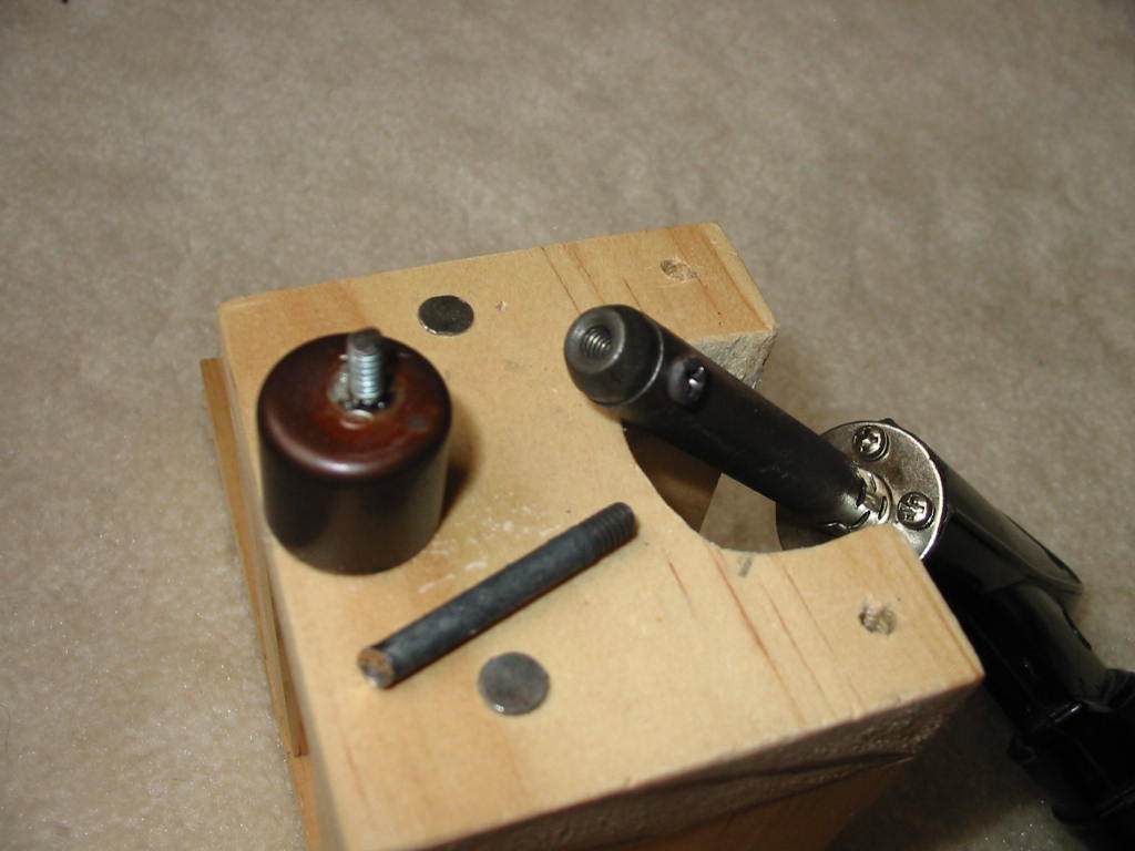

        2) I'll have to check. Bolt's diameter is about 1/8" or 3 mm, not sure about the pitch. Basically, it was the same as the as the removable tip of my iron. Obviously if you have a different iron, you may need to get a different size bolt - provided that your even has that type of tip.
        As for the mounting - just took a normal bolt and drilled a hole through the copper cap, then removed the tip from the iron and screwed the copper cap in its place. So basically the copper cap is held to the iron with the bolt. I did not cut off the head on the bolt. I did need to shorted the bolt a little bit, though.
        Not sure if that clears it up. If not, let me know and I can take some pictures of the cap.

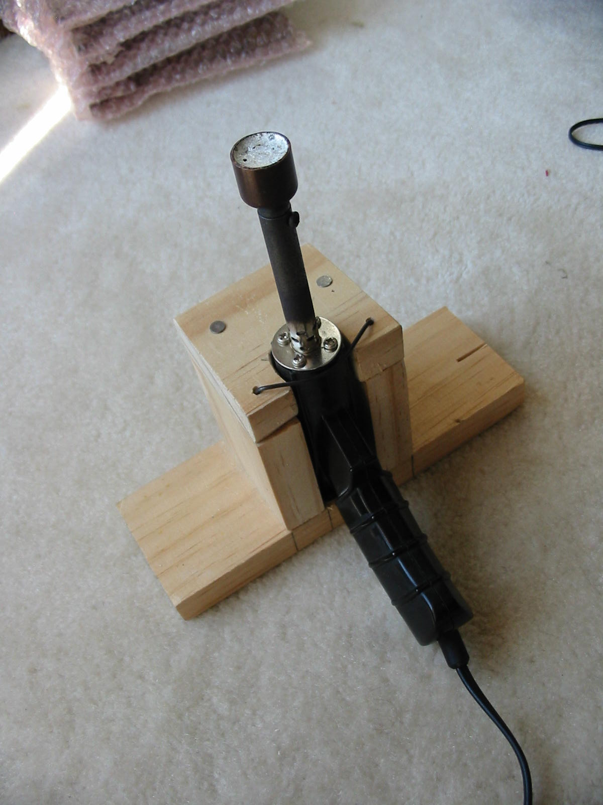

                I guess a picture really is worth a 1000 words. Here you go mockingbird:
                https://www.badcaps.net/forum/attach...1&d=1343546499
                Picture shows the soldering iron, the solder pot (sitting upside down), and my crusty but wonderful iron tip (it may be carved in and dirty, but it works great).
