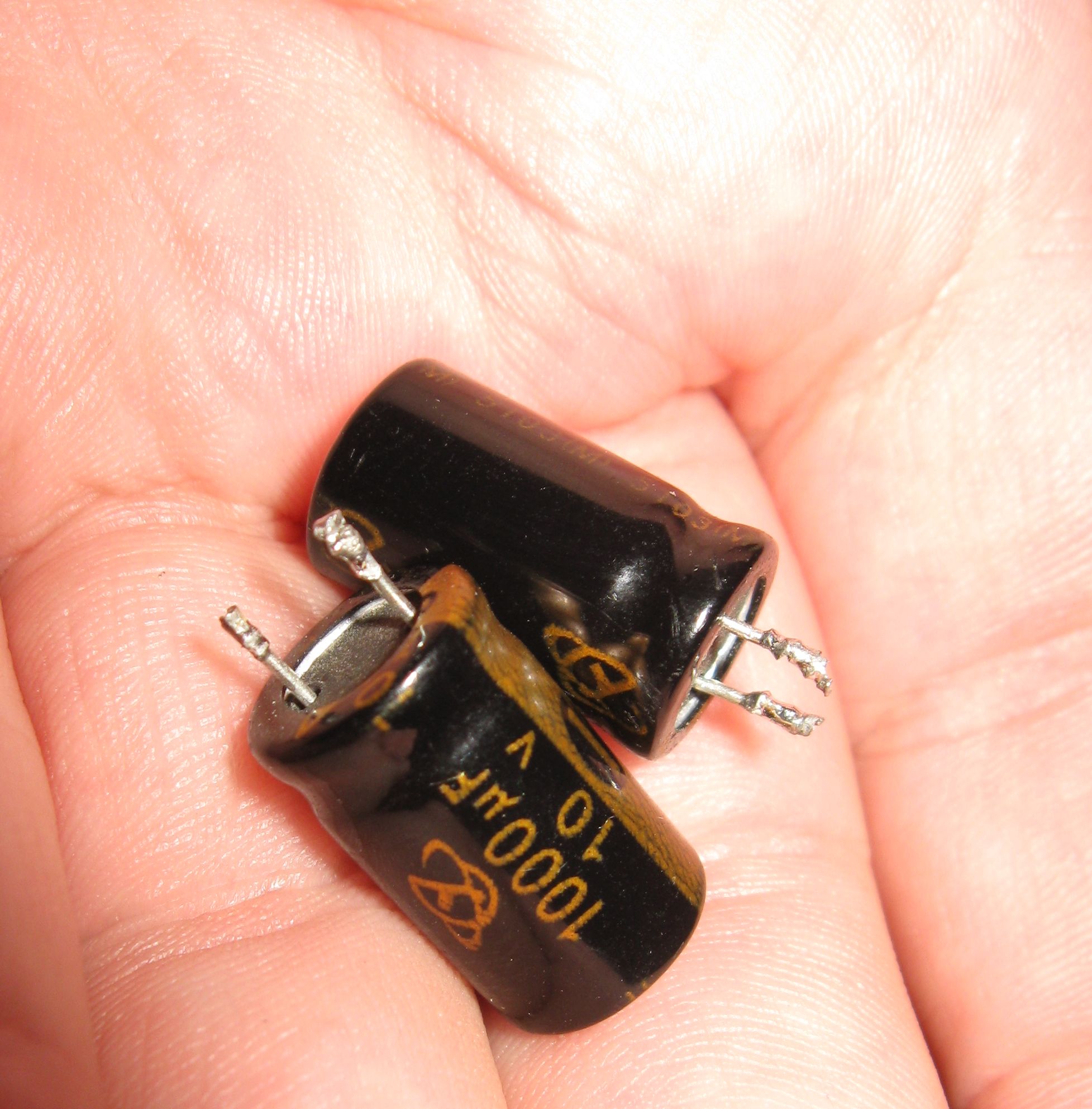

    What brand is this cap?
    Im looking for a replacement of 1000uF 10V 5013(M) , same brand, but i dont know what brand is this. It have only a logo...

    Re: What brand is this cap?
    This brand is an OK-ish Chinese brand, Yang-Chun I think. Not the worst but it's not that great either.
    http://translate.google.com/translat...%2Fy.html%23yc
    Probably any Nichicon, United Chemi-Con or Panasonic capacitor rated for 1000uf - 10v or better will be much better than what you have now.
    I actually have two of the exact value, tested ok, which I pulled out from a cheap power supply that died on me (not because of the capacitors)... but unless you're in Europe, I don't see how it would be worth to you.
    In Europe, I can send them to you or send you some Panasonic/Nichicon ones for 2-3$ .. the price of the postage. To US/Canada and other countries, it's probably cheaper to get them from Farnell.com , mouser.com, digikey.com
      Thank you!
      Is this 1000uF regular ones or low ESR, because I cant find any spreadsheets?
        If you pulled them from a PSU, probably low ESR, but why would you replace them with the same brand? I'd be using a japanese replacment.
          Its from old and cheap PSU and its swollen, ready to pop.
          Oh, i did not ask in the right way (english is not my native language, sorry, still learning)
          I dont want the same brand. Just wanted to know what brand is, and search for some characteristics. I can change it with regular one (cheapy Fujicon), but I want to be sure about the impedance of the old one.
            You might not be able to find the specs on those. Any low ESR cap would probably work, but Fujicons don't even last long as audio coupling caps.
              Not too sure what electronics suppliers you have in Bulgaria, but If you can find one, a Panasonic FC or Nichicon PW would probably work just fine.
