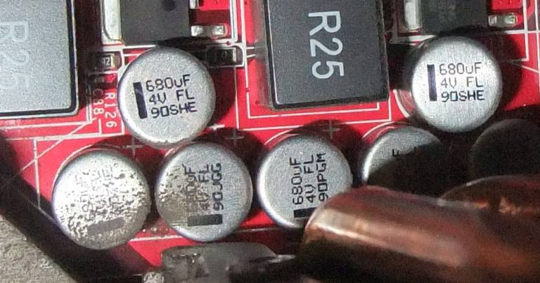

    Need help identifying these "polymer" caps
    See attachment below. This type of capacitor used to appear on MSI's LGA775 motherboards. The motherboard taken as an example is P31 Neo-F and you can see them in CPU's VRM output stage:
    http://detail.zol.com.cn/picture_ind..._p126373.shtml
    Sometimes they're replaced by OST's RLA series (in blue sleeve) electrolytics so I suspect they aren't polymers?
    http://publish.it168.com/2005/1031/images/488779.jpg
    It's also interesting to see that MSI used Japanese capacitors in the "non-critical" areas of this inexpensive motherboard, like:
    PCI power filtering and chipset power
    Memory power
    So they're somewhat better than these Japanese counterparts?

    Re: Need help identifying these "polymer" caps
    Those are not polymer... PCBONEZ was kind to inform me that those are Panasonic FL... The "vent" is a plug in the bung, on the underside of the cap...
      Thanks for your help, and also many thanks to PCBONEZ
