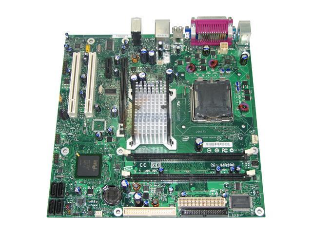

                • bw1
                  • Sep 2010
                  • 172
                  Re: HM to replace KZG?
                  Model is Intel BOXD946GZISSL. Still available at Newegg, but this was purchased back in 2008.
                  I don't have a camera handy, but I attached a stock photo of the board. The caps that were replaced are the bigger ones next to the North Bridge (5), the 2 by the IDE port, and 1 by the Memory Slots (8 total).
                  Nothing else looks damaged or questionable.
                  PCI-E card didn't help. Actually, with onboard, it does light the monitor Green led for a couple seconds, and then amber. With PCI-E, I didn't get anything at all. Neither produced any video signal.
