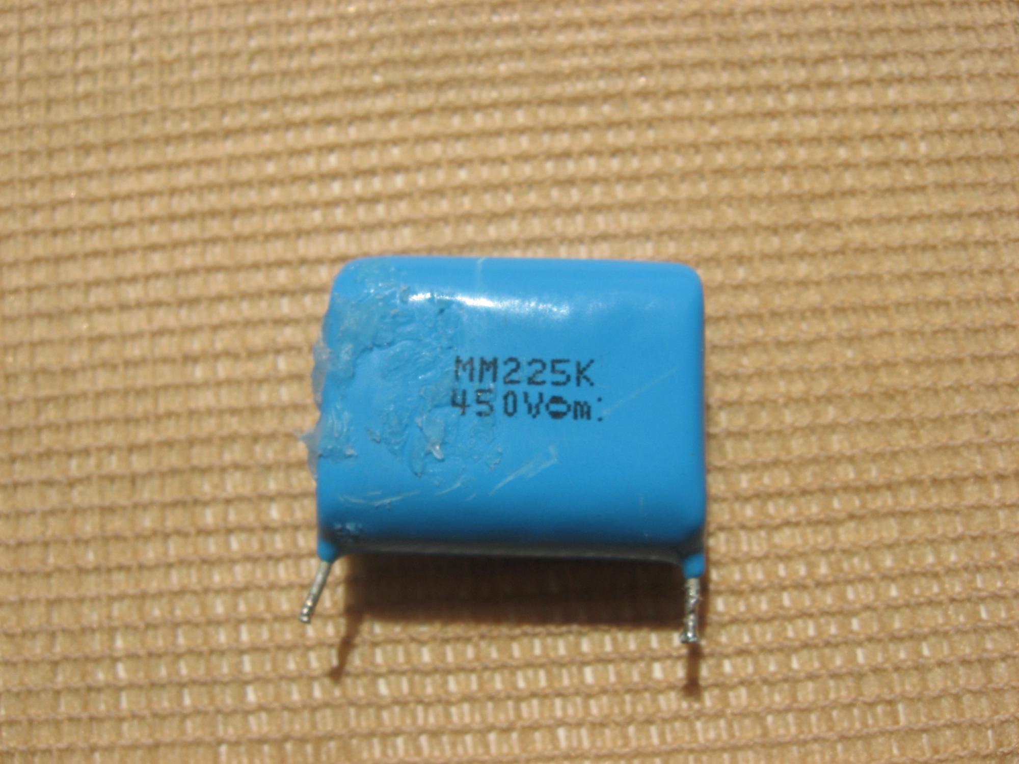

Please help me identifying manufacturer of these capacitors (assume Taiwanese). They are metalized film.

Here is the photo

22*10^5 = 2200000 pF = 2.2 uF
K= +/- 10%
2.2uF +/- 10% 450V MKP or other type
Brand = I don't know
Use TDK/Epcos or WIMA or RIFA, they make high quality caps.

I have additional question: why these epoxy resin coated capacitors are used, why not plastic case like e.g. X2 types?

Cost saving probably?
