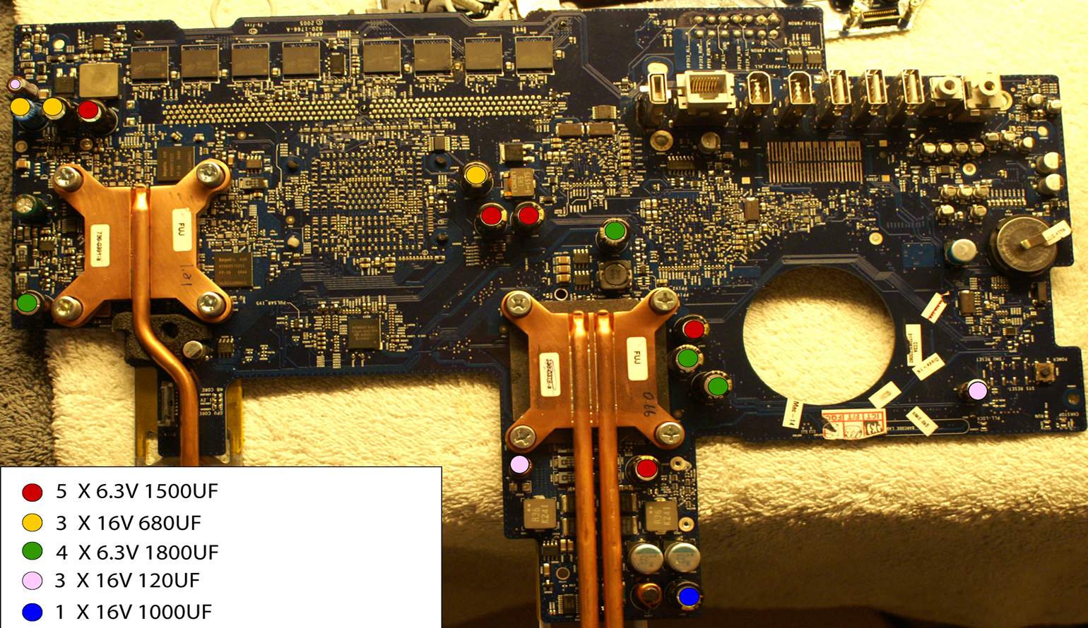

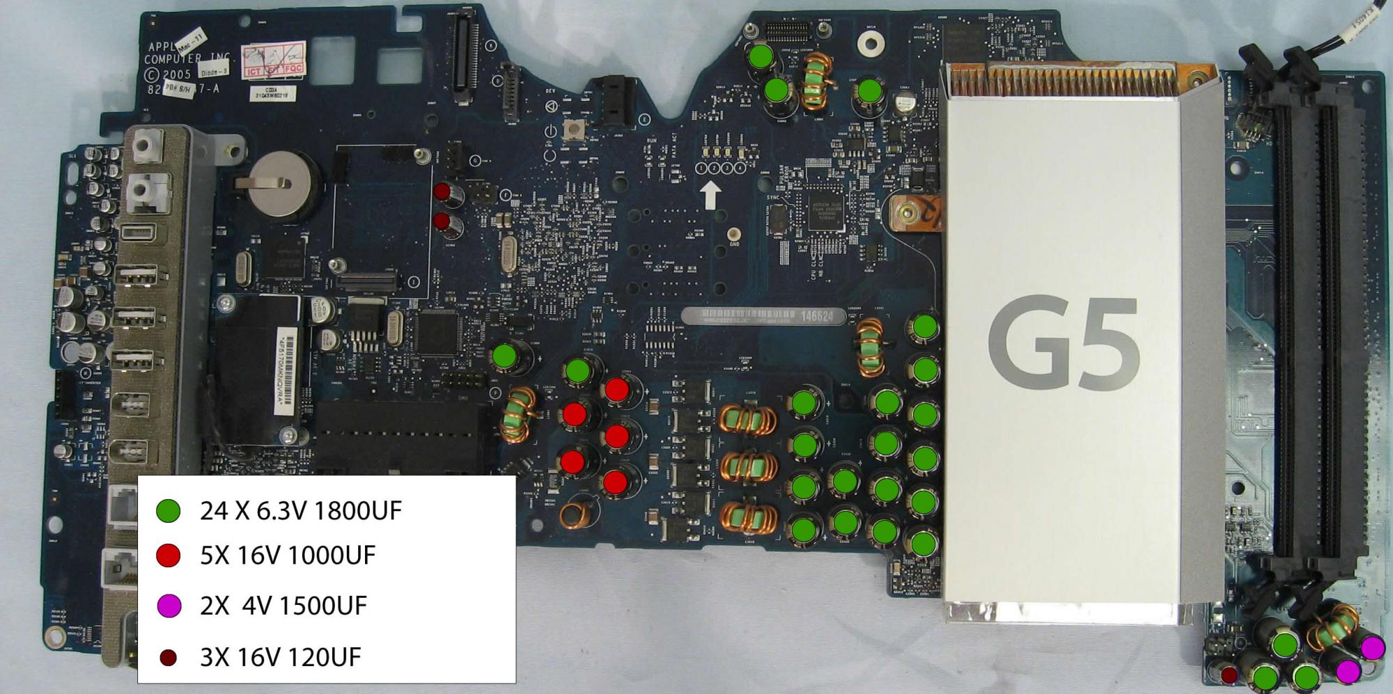

On the first picture, more correctly, that's the iMac G5 with ALS ( Ambient Light Sensor ).
The ALS plug on the board is at (under) the upper right corner of the cap designations.
The "run of the mill" iMac G5 does not have:
3 - 120/16
2 - 1500/4
and only has
20 - 1800/6.3
Thanks for the pics!
