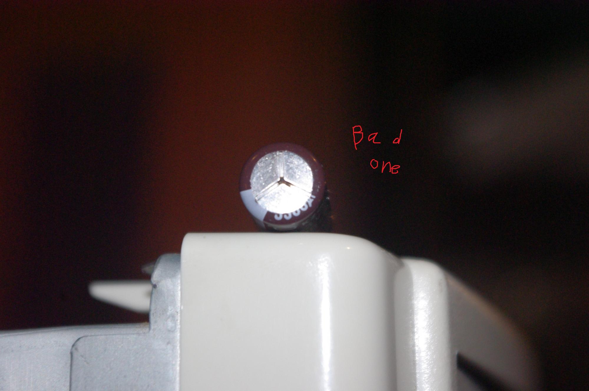

                    Not replacing all the KZG would be a mistake.
                    If one is gone the others aren't far behind and they also have a habit of failing without bloating so if you don't replace them all you could end up with a 'stealth' bad cap.

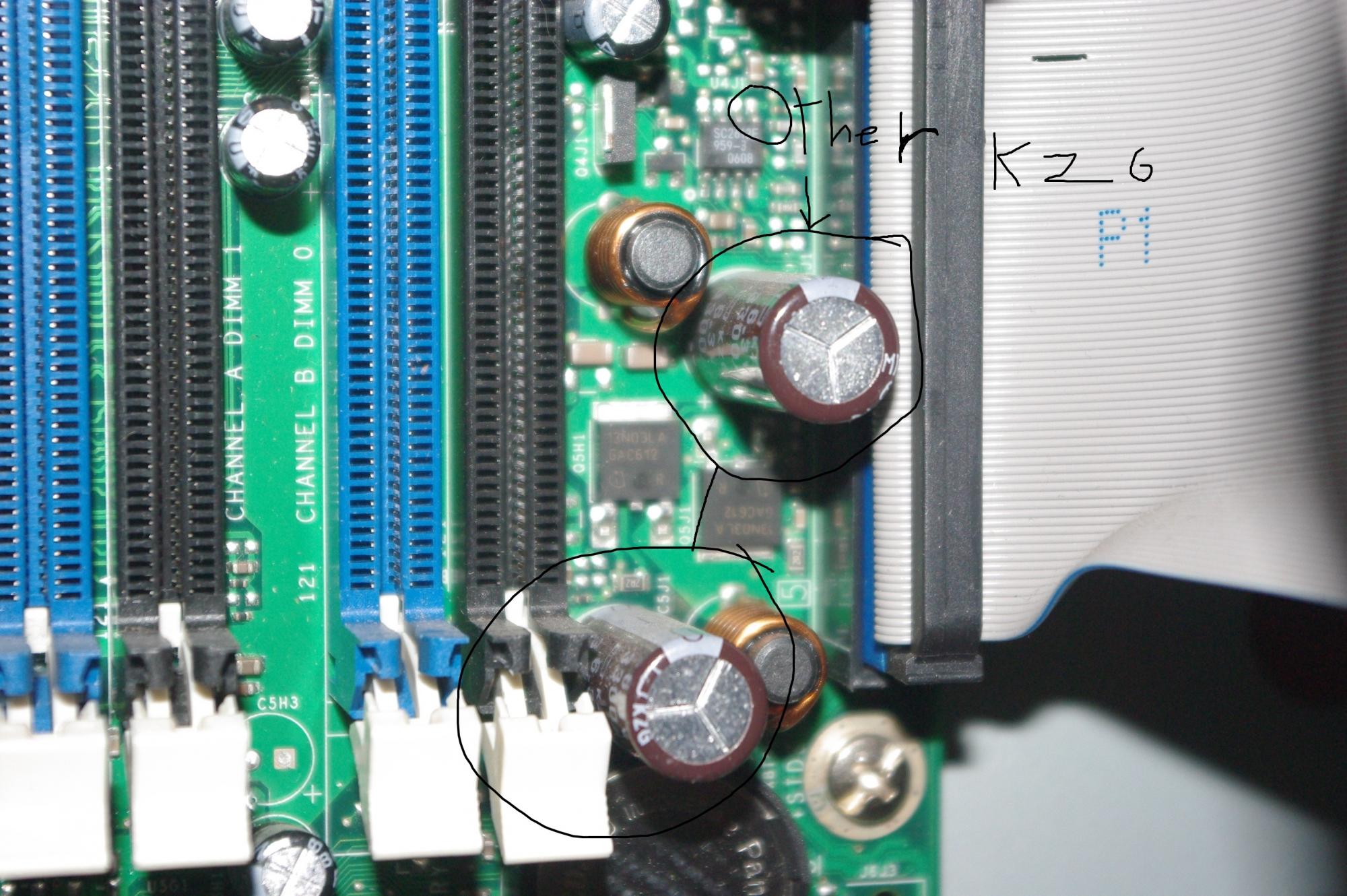

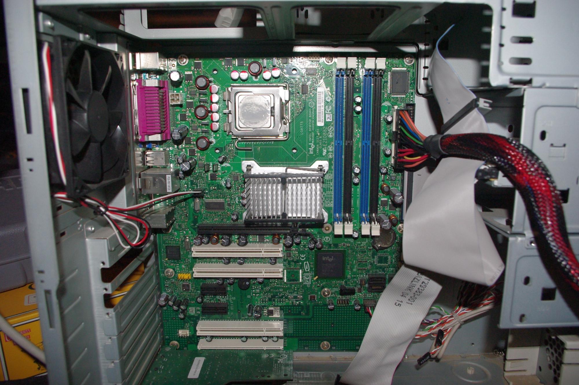

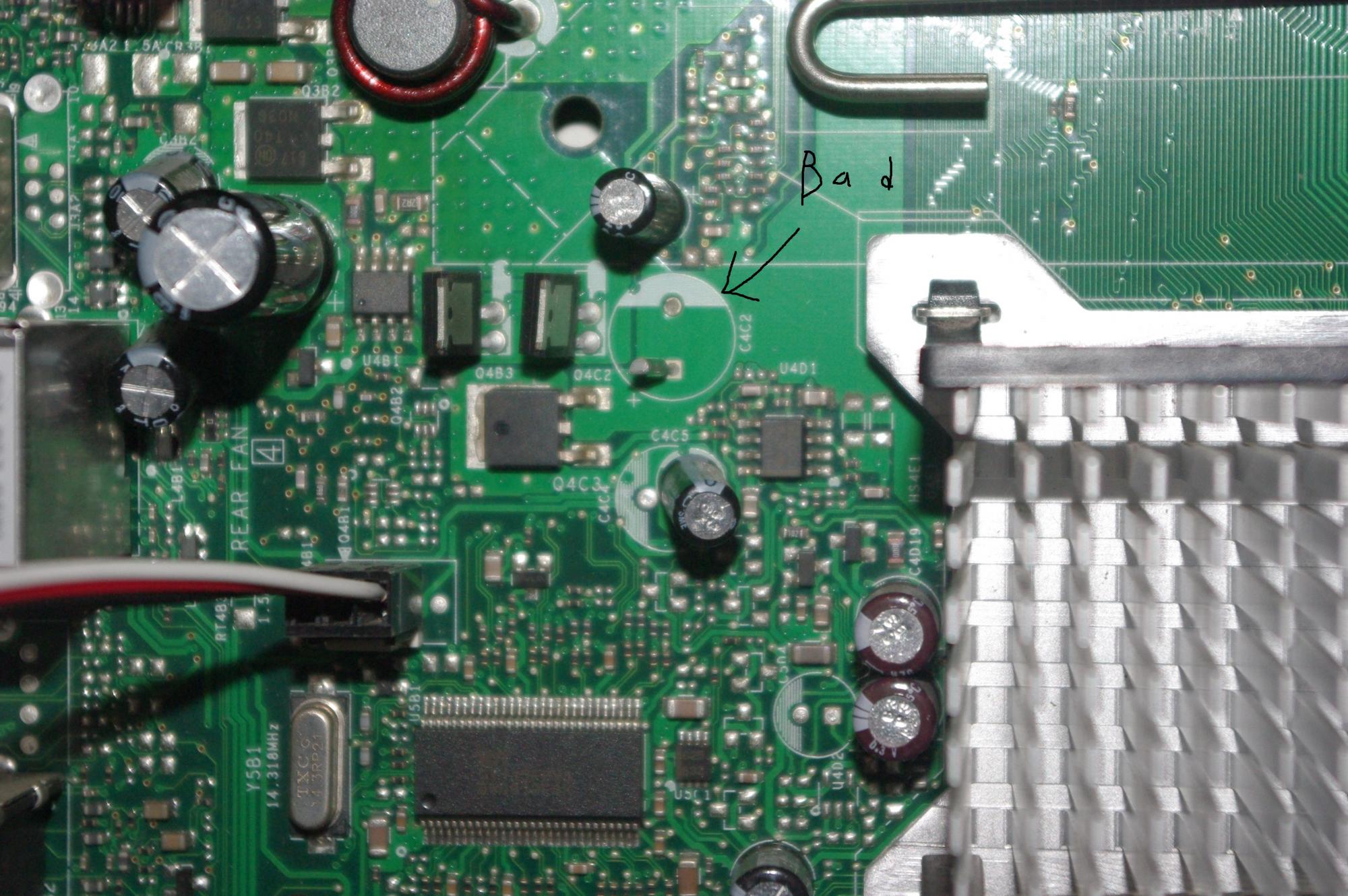

                        Ok, here are the pics of the mother board. Yes, I do have a different power supply. That how I found out I had a bad cap, the mother board wouldn't power up.
                        I found out that I know someone who knows someone that has a whole bunch of extra caps, so I am going to see if if he has one that will work.
                        I have been practicing on a old mother board and I am having trouble clearing the holes, I have been using a pin, the solder keeps hardening too fast.

                                    It's still possible new caps could fix it but much less likely.
                                    Your symptoms suggest a blown chipset which is a common result of a PSU gone bad.
                                    Sometimes blown caps will keep the chipset from running which 'looks' the same as a blown chipset so you might get lucky.
                                    Also the missing cap in your photo might be a chipset cap.
                                    Can't tell without tracing circuits.
                                    Thing is with no fan spin -and- a history of a bad PSU the odds of a recap fixing it are pretty low.
                                    - Just saying don't be surprised or disappointed if new caps don't fix it.
                                    You need to replace -ALL- of the KZG though.
                                    They go bad without bloating and you have several in the RAM power and a few other places.
                                    Also as this is an Intel made board so check the small 4 & 5 mm caps.
                                    Intel has a bad habit of using 85C temp rated caps for those and they go bad occasionally especially if the case cooling isn't so great.
                                    They will bloat slightly but the bulge is so small on small caps it is very hard to tell.
                                    Those small caps, if bad, came keep the chipset and other ICs from doing their jobs.
                                    I don't see any that look bad in the photos, but check.
                                    Bad 4 & 5 mm are very rare if they used 105C caps.
                                    Check your chipset for signs of internal melting which will show up as shinny spots, pits, or cracks. If you have some the board is toast.
                                    If you don't have some that doesn't mean the chipset is good though, it could still be shot without showing it externally.
                                    Look for the same thing on the MOSFETs.
                                    Those can be replaced although it's not always an easy job.
                                    In the upper right corner in the last photo there is a large IC that looks like it has a melted spot.
                                    [May be a photo illusion. I can't tell if what I see is damage for sure.]
                                    If it does the board is toast unless you can replace that chip,, which is extremely tricky and difficult and I wouldn't even try. [Especially on a board with a bad PSU history because if that got fried the chipset most likely did too.]

                                      I looked at the spot, the stuff flaked off but it did look kind of melted. Would the damage go down farther or would it be on the surface?
                                      • Scenic
                                        o.O
                                        • Sep 2007
                                        • 2642
                                        Re: Need to find a place to buy type of cap
                                        if there's some sort of "crater" in that chip, it's toast.
                                        edit: from the looks of it and its position, this seems to be the legacy I/O controller (ie: floppy, parallel port, serial port, ..)
