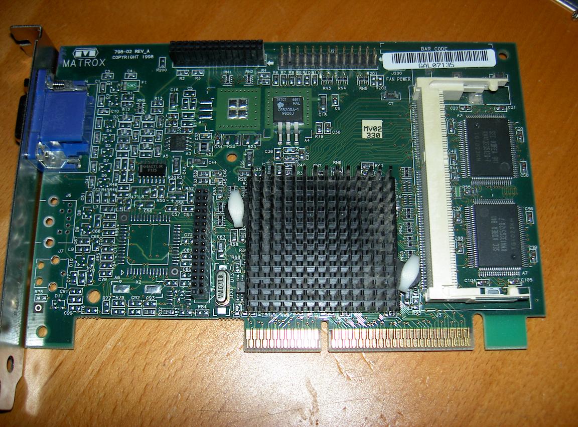

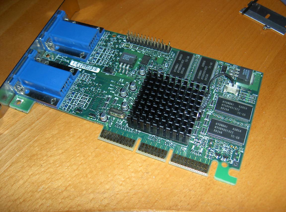

      Re: Do all graphics cards have capacitors?
      This is my Matrox G450, as you can see there are a few capacitors around it's heatsink, that funilly enough is grounded... I do not know Matrox design ideas behind this, but I have read that when chips start reaching 10ghz hetsinks will need to be grounded... But the G450 is a bit shy of that speed
      Next up is my Matrox G200, not a single capacitor on it...
        Thanks for info. My G400 has something that looks like that oval shaped thing on the G200 board with "MM0270JK" on it. I wasn't sure if that was a cap or not. Good news then, no caps on my G400!
        • Rainbow
          • Aug 2005
          • 1375
          That's a crystal.
